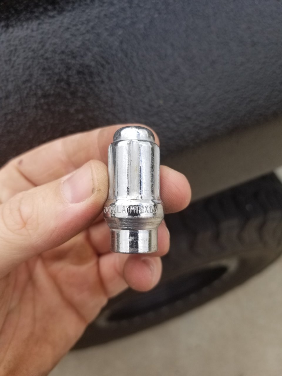

    Vehicle Modifications: TACOMA 2007 FRONT TOTAL CHAOS 5LUG ,LONG TRAVEL KIT 13" OF TRAVEL KING COIL OVER (550 POUND SPRING RATE) (18 INCH COIL) REAR BED CAGE 16" SMOOTH BODY FOX SHOCKS 2.5 2.0 / 2.5 BUMP STOPS FOX ICON ADD LEAF PACK WITH OEM SPRING 11" OF TRAVEL TRUCK COMES SPRING UNDER BY MANUFACTURE TOYOTA REGEAR TO 4.0 WITH AUBURN UNIT ENGINE 2TR-FE WITH AFE COLD AIR IN TAKE DOUG THORLEY HEADER MAGNAFLOW EXHAUST TIRE S NEW KO2 32/11.5 METHOD RIM 15" WITH -20MM OFF SET
    so ran into a problem here what do you guy think i should do ?

    buy new axle/hubs
    talking about the hub centric part it fit the oem hub but doesnt fit the method rim ....

    Wouldn't worry about that part so long as it fits the factory hub. Just gonna look funky on the rim. Do you have conical lug nuts?

    you need a hubcentric spacer. the method wheel has a larger hub diameter than stock is all. or dont worry about.

    I wouldn't worry about it then. You could machine the hub centric lip off if you wanted, but unnecessary
