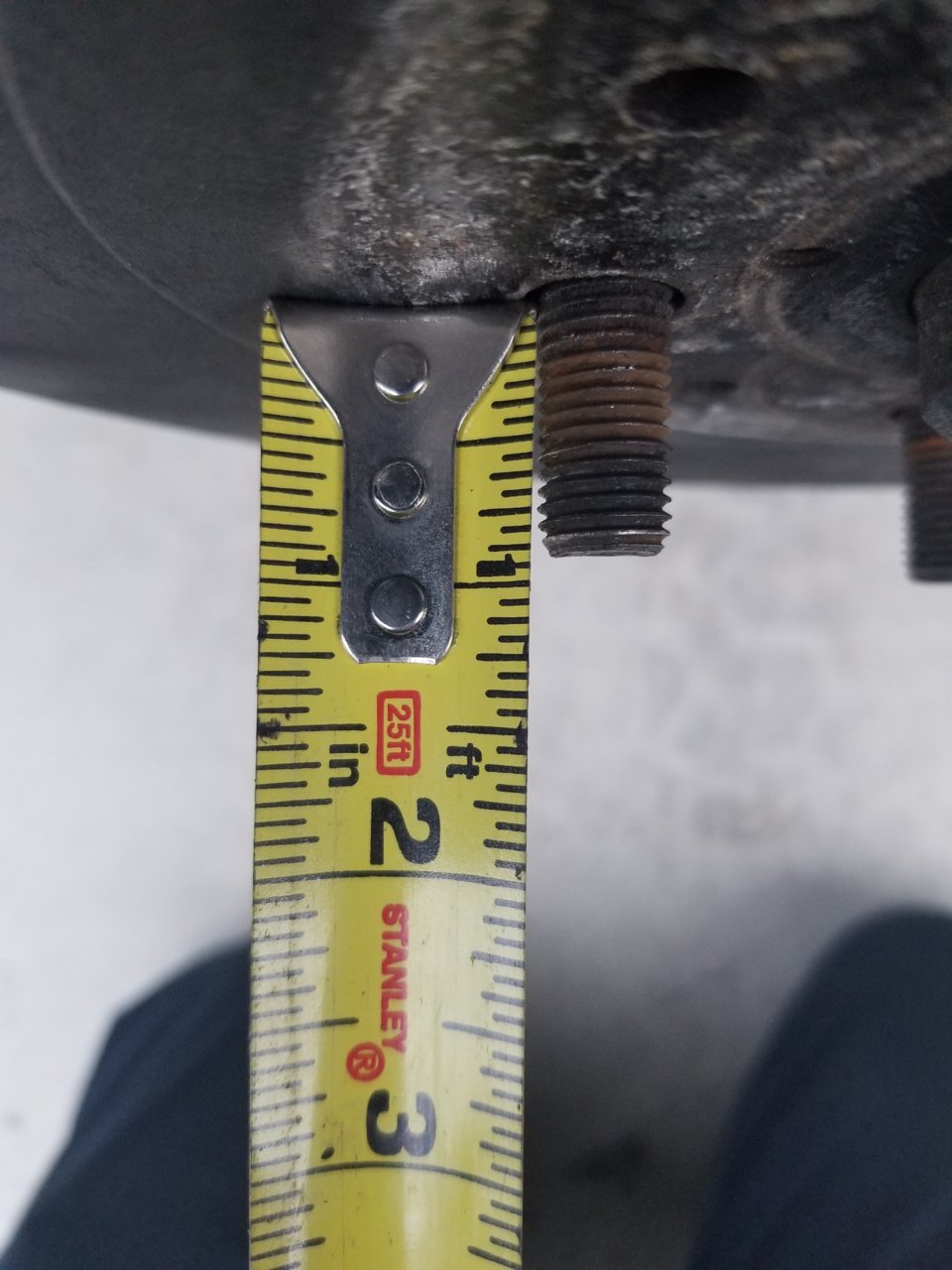

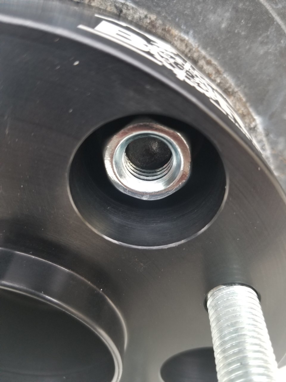

    At some point the precision in the fit between the nut and the machining on the wheels would come into play on that. On mine I get everything hand tight and torque in a typical star pattern - gets the job done... I haven't gotten my truck over 50 though so I might get some higher speed vibes, we'll see - I'm getting rid of the spacers since I am getting rid of all 4 hubs though

    I think it's all because that spacer was intended for a different vehicle, hence the smaller hub bore and thicker base intended for longer studs for a different OEM than Toyota, such as Jeep or Ford Ranger/Explorer

    at least the bore would be correct at the very least. Toyota studs are short as hell though. I have ET nuts on my rear spacers and never had an issue. But they're Toyota bore.

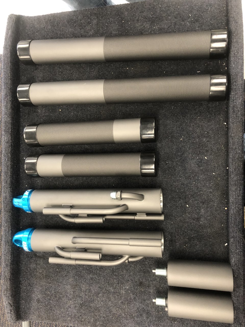

    what kind of coating is that ? Will the collars scrape the coating off of the threads ? My fronts are in great shape but the coating on the bodies is gone and they look like shito so I've been pondering my options...

    Nah, that would never work on threads and would not stick to the King shock bodies unless you sandblasted or self etch primed them first...none of which would also work on the threads. I think he had either anno'd or cerakoted them, prob cerakote because he would have to own the pure race aluminum bodies to have anno'd them ?

    If I had to guess I’d say it’s cerakote.

    Nah. Plastidip from home depot.
