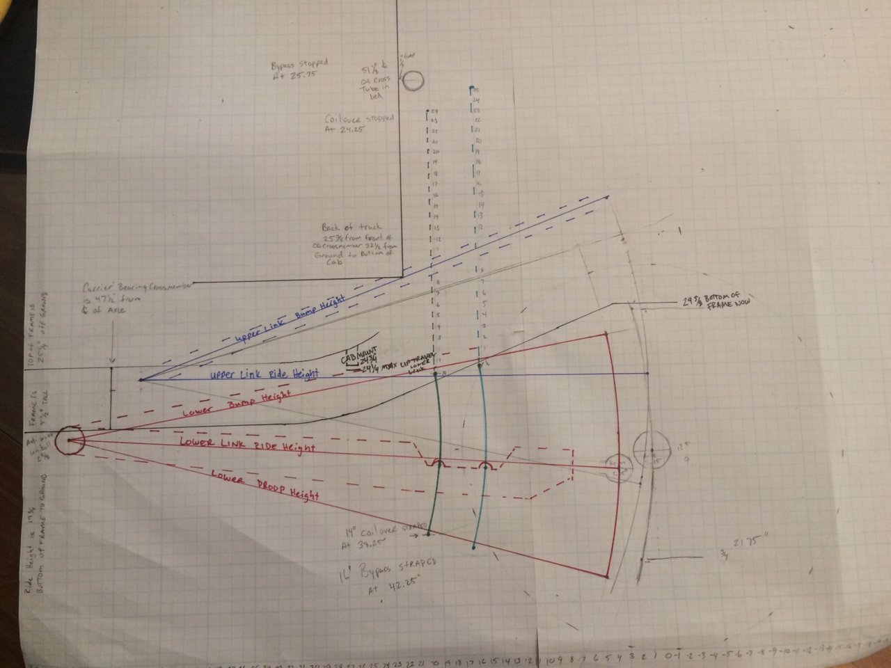

    I still ended with around 21.75” Don’t mind the upper link at bump it is incorrect. I need to fix it. But this is what I got done so far. Taking a break for now.

    2" if you're doing a 3 link panhard with a single upper link
    1.75" if you're running 2 tubes

    Is this a double cab? If so you are experiencing the same packaging problems as others before. Currently your 16" shock is restricting additional movement/travel, as well the cab is restricting your packaging and causing your shocks to go into a regressive rate. Generally people utilize an 18" shock and move the mount down the link, towards the axle to fix this problem.... Most linked double cabs are getting right in the 22" of travel range in the rear.

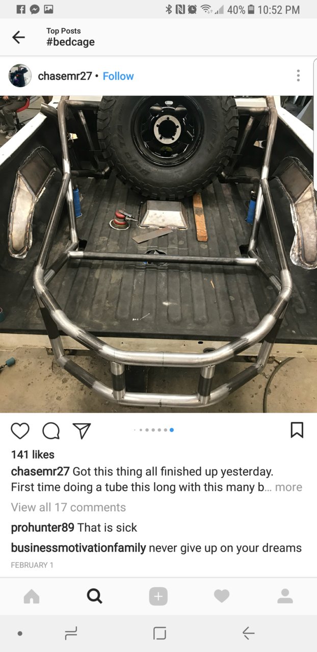

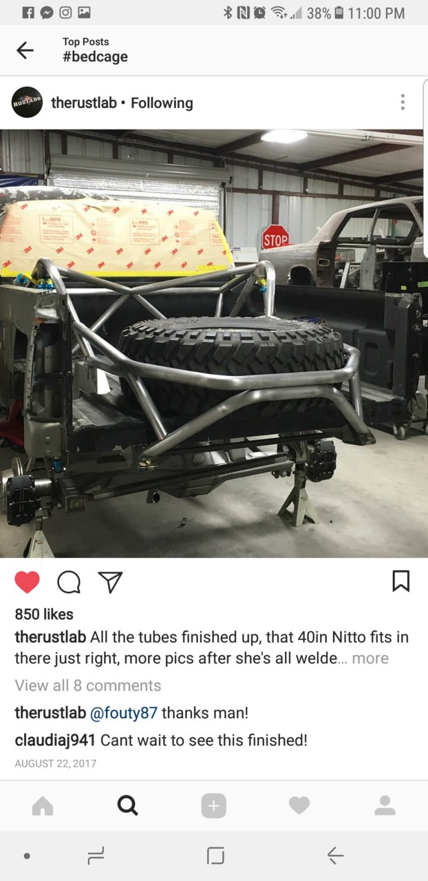

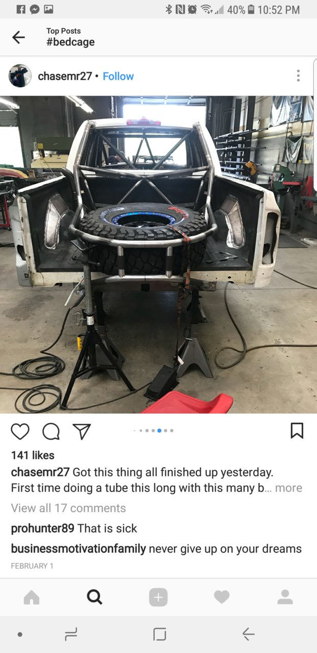

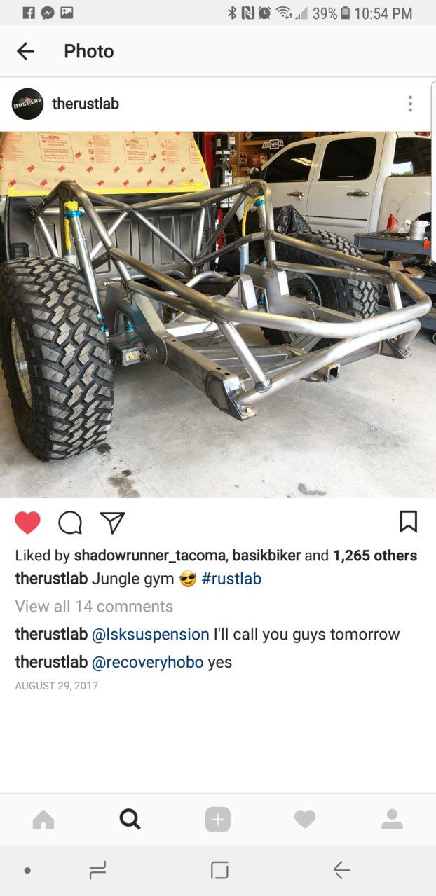

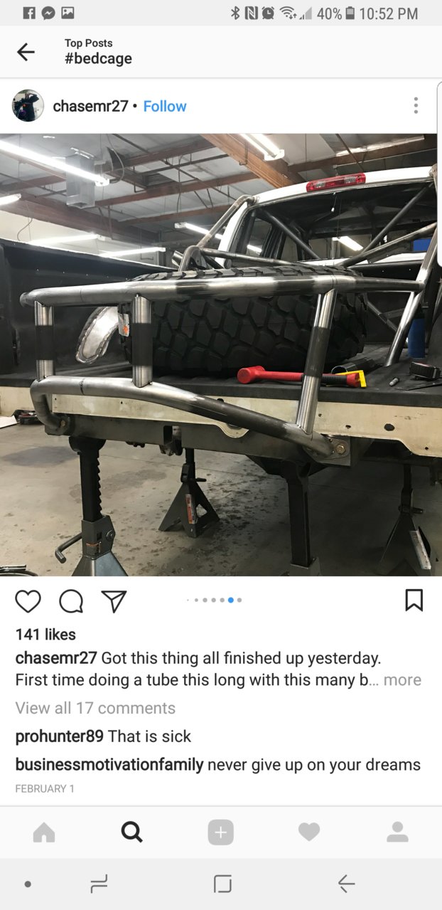

    want to do something like this @Coot83
    Coot83 likes this.

    Yes double cab. Rear cab mount is in the way of up travel. Limiting the up travel to 12.5-13. And down travel is around 9” down. Using a 14” coilover. I’m fine with the travel numbers because I only have TC 3.5 in front running about 11” of travel. This is all on paper so I’m pretty sure it might be different once I start putting things together and start cycling.

    I cut the shit outa the cab mount. Easily gain another 2-4 inches
