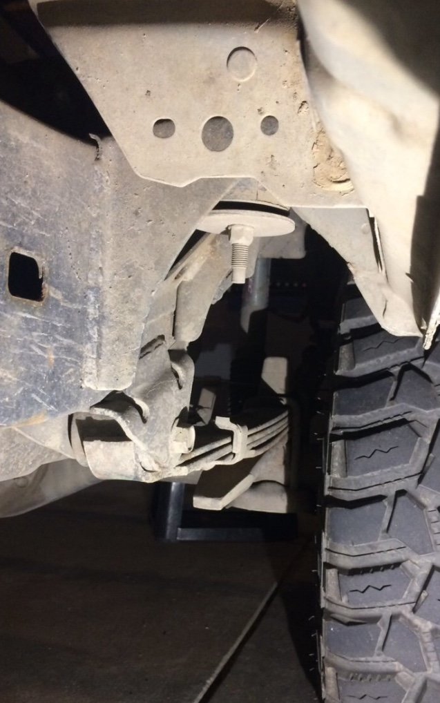

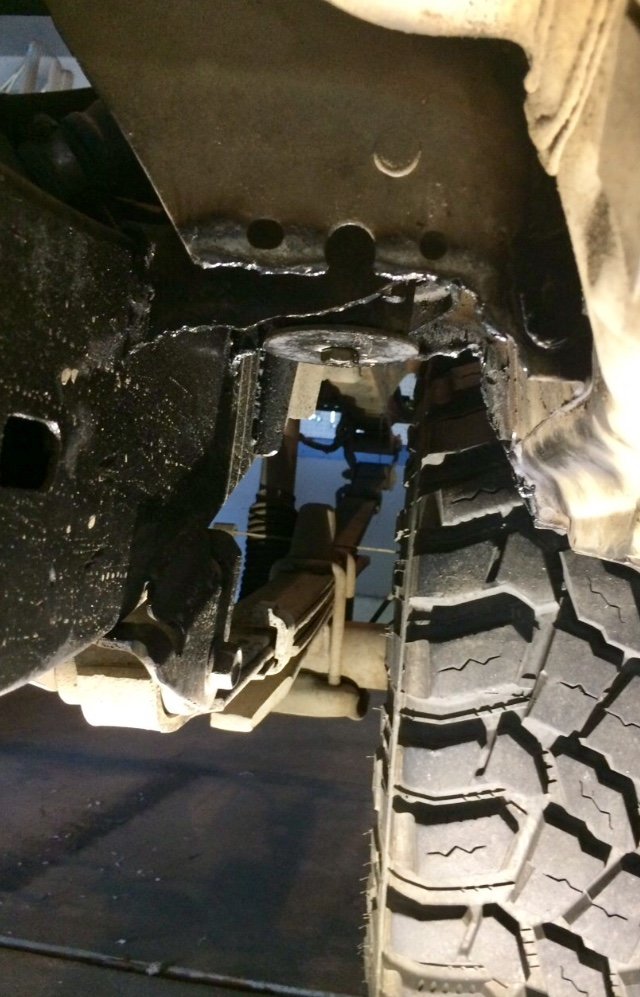

    I cut some. Before and after. I also grinded out the mount and turned the bolt around the other way.

    What did you cut that with ? ...a pissed off beaver on PCP ? :boink:

    Hahaha! Yeah pretty much. Torch at work. Slag is my friend. I can clean it up later. I was in a hurry.

    We need to start a go fund me to get you a grinder to clean that shite up :spending:
