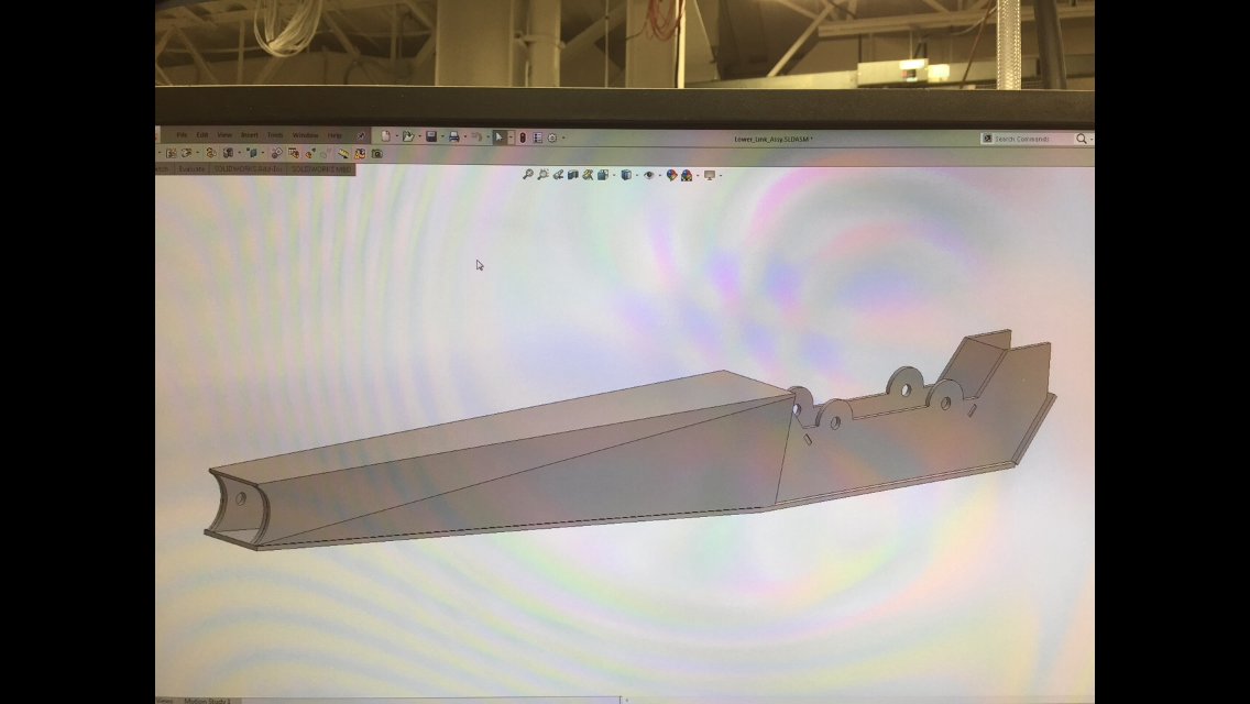

    We just had a cardboard trailing arm a few post back. That's pretty high level shit for TW.
  5. Jun 5, 2018 at 5:12 AM
    SilverGhost
    SilverGhost Well-Known Member
    Sep 16, 2013
    #112635
    8,717
    RayRay
    Reunion, Co
    02,03 some 04, it's complicated
    #junkyardparts
    Ha! It’s getting there. The guy drawing it up for me has been busy. I just use the foam and cardboard to help figure it out.

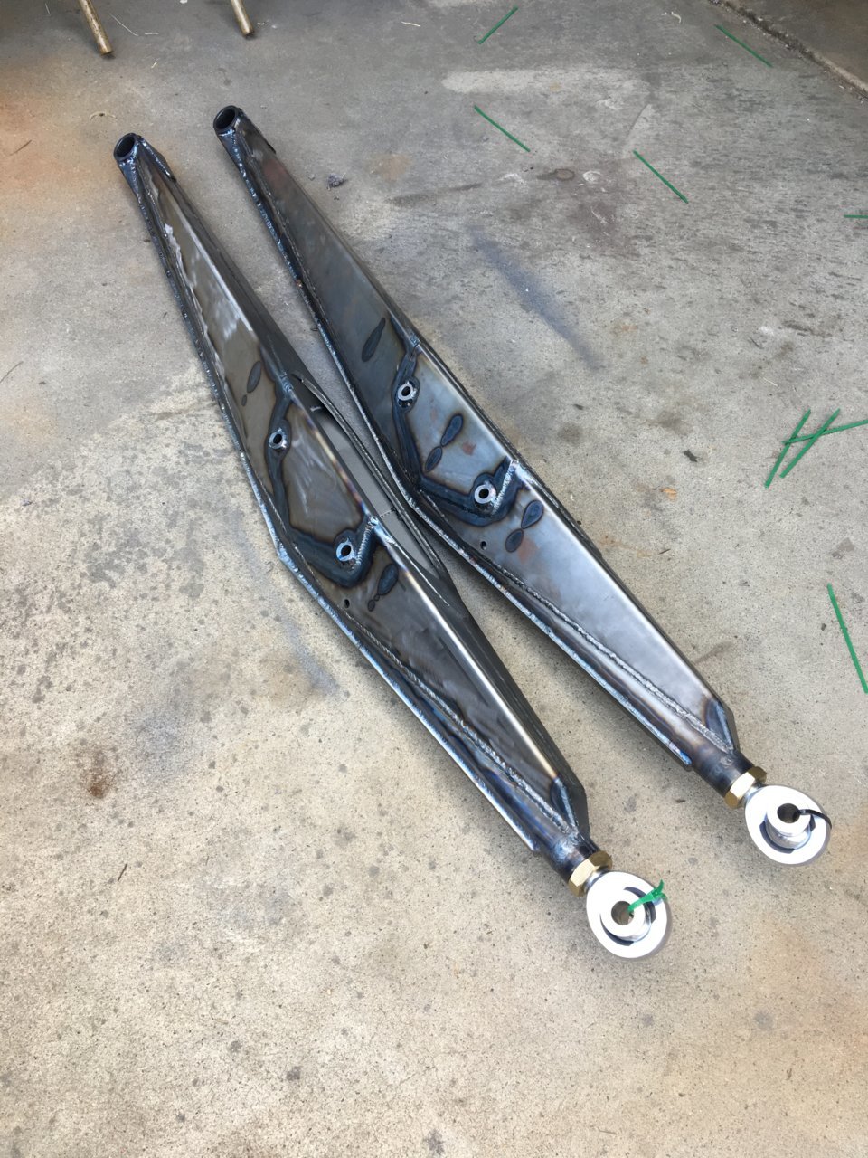

    I know that’s not the he finished design but put a Center rib in the link and make sure the shock pocket areas are BEEF... and if your running out of shock travel u can always take the spacer out to turn the 14 into a 16 and the 16 into an 18.... just sayin.
    Side note here’s the links I did(not for a double cab) gunna start chopping it apart this month

    What size/ thickness tube did you use for the main beam piece?
    Also, looks good

    What’s the normal size links for double cabs?

  11. Jun 5, 2018 at 4:28 PM
    glorifiedwelder
    glorifiedwelder IG= @Liquid_Torch
    Feb 14, 2015
    #148647
    3,658
    jason
    Santa Clarita, ca
    double cab trd sport
    Somewhere in the area of 50”

    #112968
    3,987
    Trav
    09 AccCab 4x4 spaceship
    My doors are the only stock things left besides the headlights
    The tube is just 1.75”x.120” wall DOM the bottom skid piece is 1/4” and the upper box is 1/8” and 3/16 Center rib.
    Did the same set on a friends Tundra that we race... “race proven” lol
