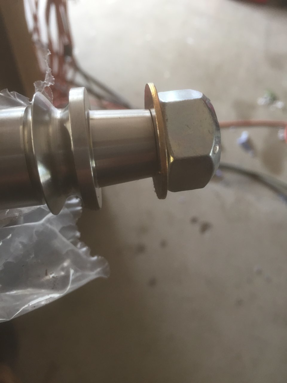

    Any of you ever break off the tapered part of your misalignment spacer if so how did you get it out?
    This:

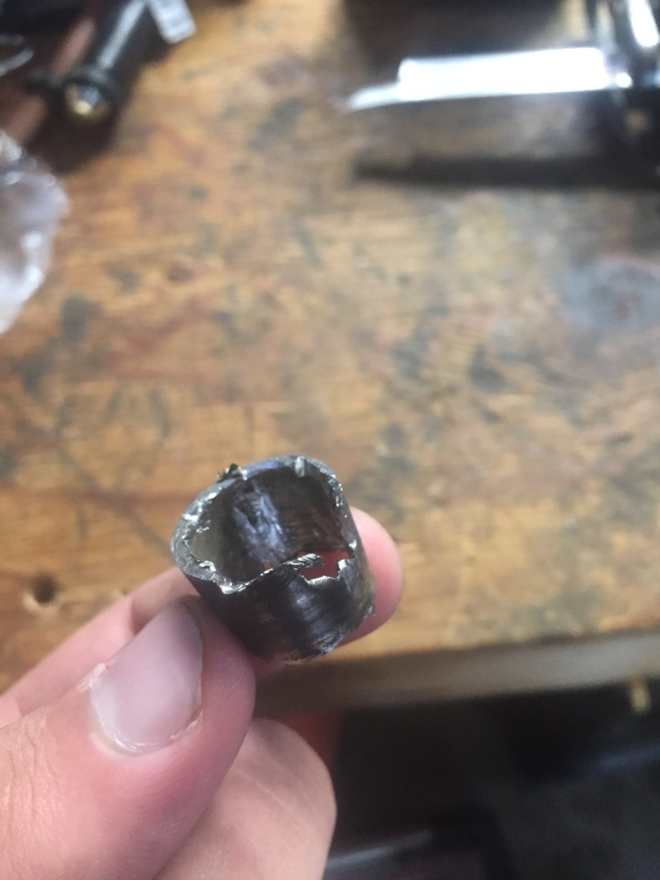

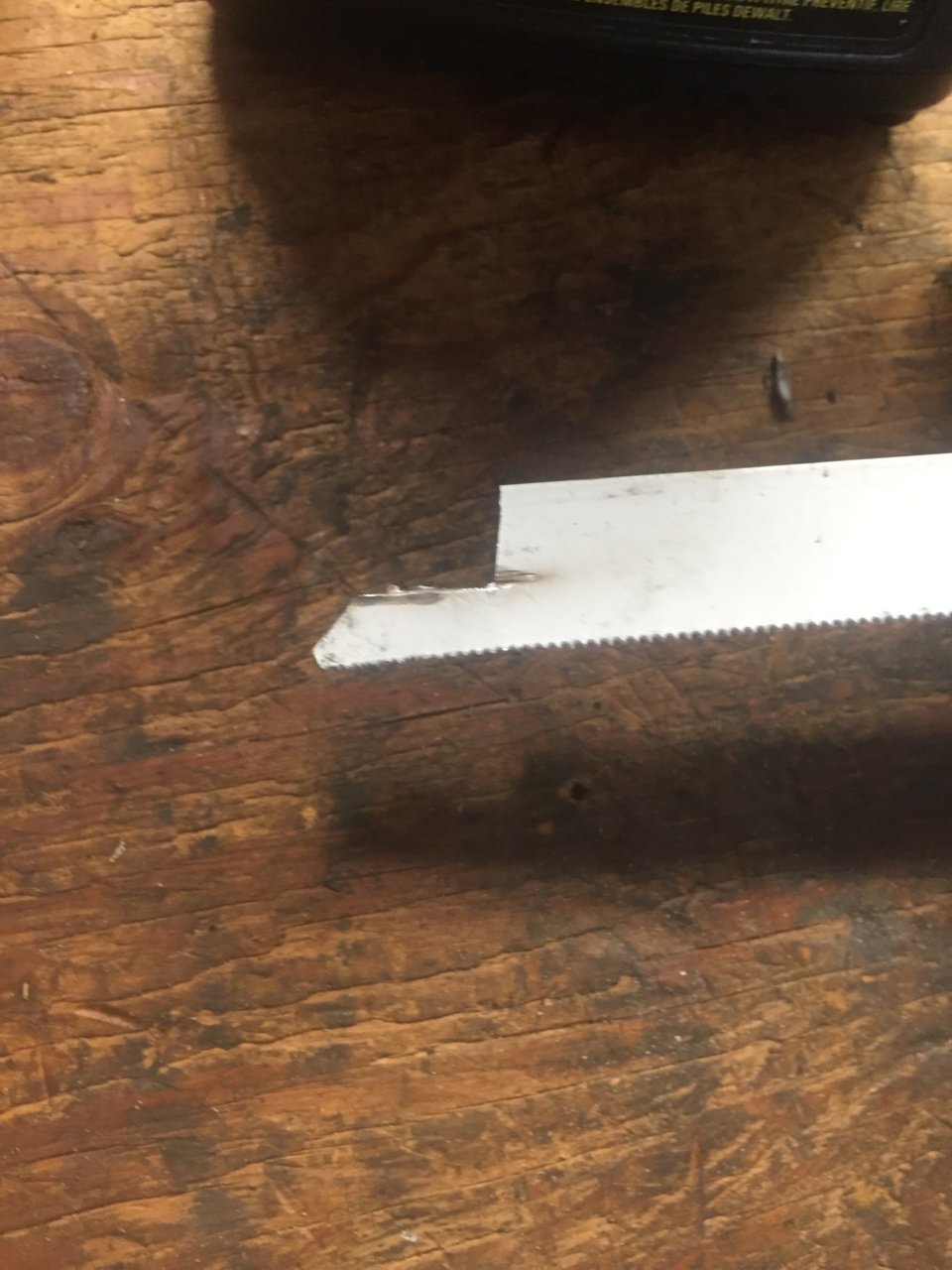

    Cut down a sawzall blade to make it fit
    Releaf cut it, and hit it with a punch and it flew out
