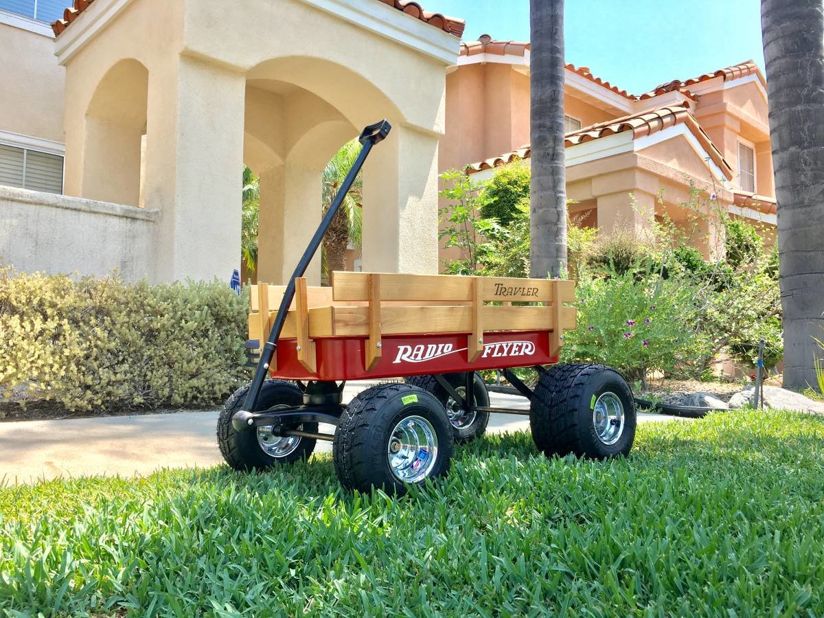

    Yeah but $550 and no suspension?

    If you had any idea how much the parts alone cost, you would not be saying that.

    Possibly, and to each their own. But I don't see spending that much on a wagon

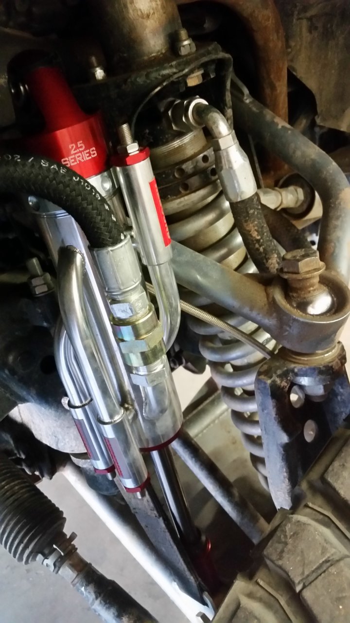

    Anyone know of a great inner tie rod joint for 1st gen? I rebuilt my entire front end recently (if it moves it's new) and I've already chewed through the oem ones that came on the Toyota roller rack.
    Here's a cool pic so more people read this.

    Hiemed steering

    I have heim outters now. I guess i could make a clevis adapter for the rack. Then its just harsher on the rack. Howe is the next step beyond that. The rabbit hole continues.. Eating inners is still better than changing racks for now.

    Camburg makes a clevis... and I you built a slider tube thing like a lot of people do for first gens to keep the strain off the rack you’ll be fine
