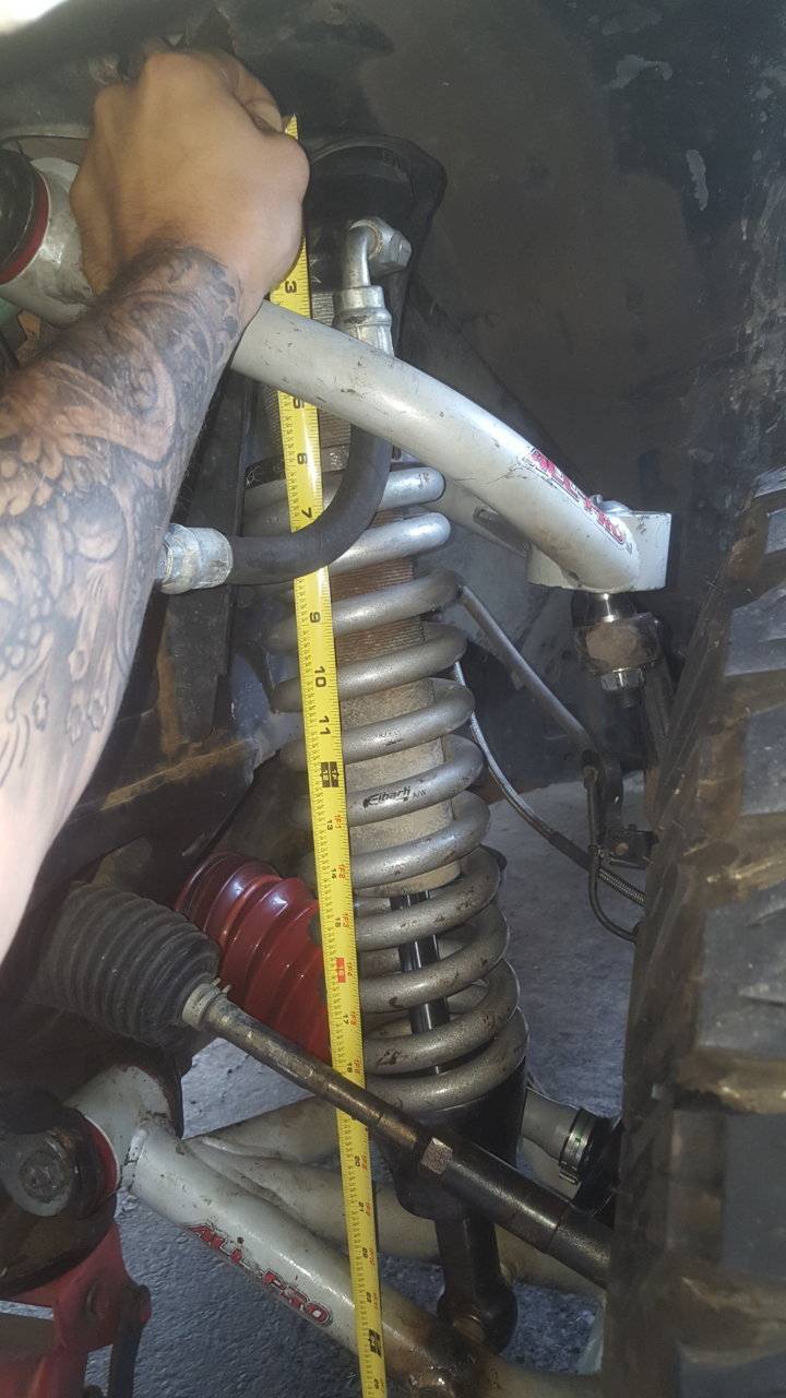

    anyone know where to find the fox part number on a coilover? the kit i got has a weird shock (~25.5" extended length, ~20" collapsed), top hat to bottom of the shock body is ~15in.
    the extended length happens to work perfectly before axle bind. cant check collapsed

    5.5 that was my bad. i edited it. i have no idea where they could have come from being set up like that. maybe theres an internal spacer?
    how long are normal 8inch LT shocks from the tophat to bottom of the can?

    Normal 8" shocks are around 16" compressed, almost sounds like a ~10-12" shock body but uses either a smaller shaft or huge spacer to limit travel

    idk if this helps anything. it has too long of a shock body and too short of lower eyelet to be useful.
    i really need to finish drilling out the lower bolt so i can cycle the kit. pretty sure i need a true 8in shock
