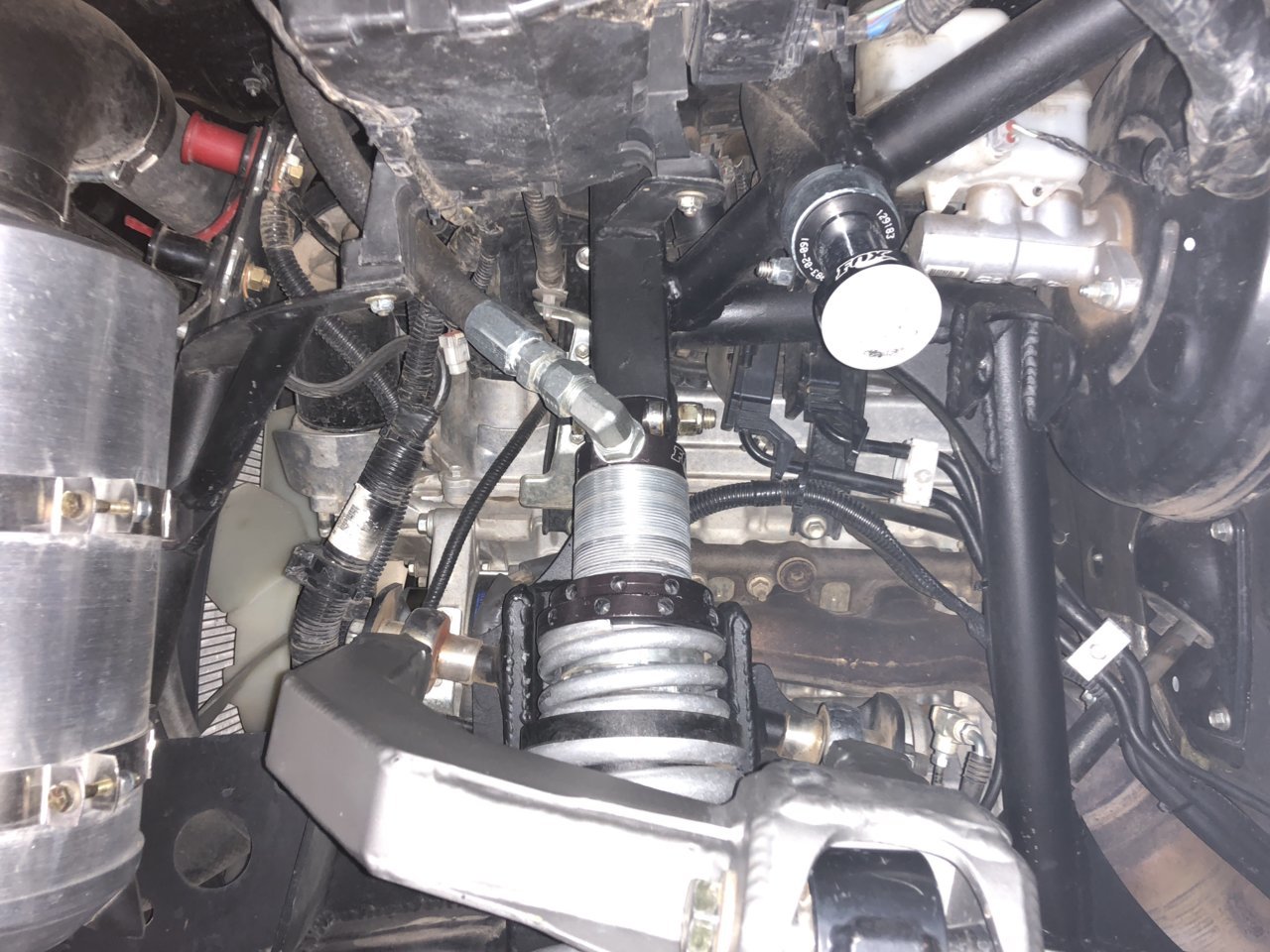

    Been discussed several times that unless you are bumping off the spindle or uca, using hydro bumps off the lca is not ideal due to the amount of wheel travel they will be influencing the suspension.

    There are really only 2 places to bump. Stock location or top of the spindle if you got a hard core race kit

    Gotcha, so stick with spacers on wheeler off road bumps. Those are super soft though, fack.

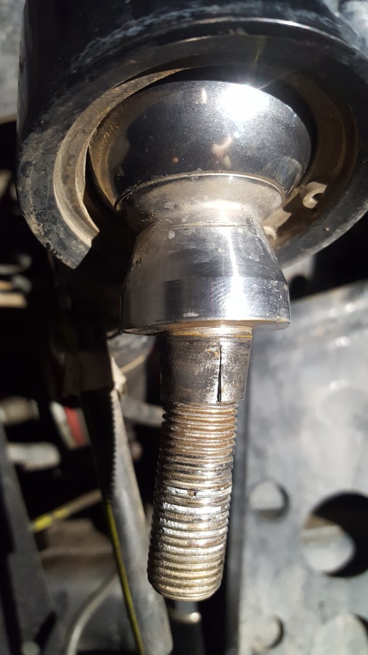

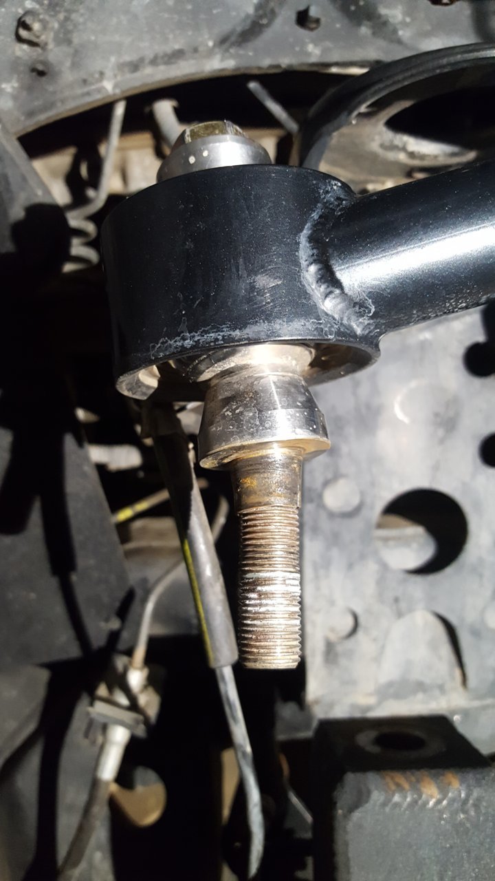

    How do you limit up travel?? I keep bending spindle/UCA bolt.

    With the wheelers bump stops. The only time I bent that bolt was from not running limit straps on my mid travel kit

    I bend it cause up travel not down travel.

    Camburg spindles not keeping up I guess. Gotta get me some grade 10 bolts.

    I know, you've mentioned this before, I just don't know how you're bending that from uptravel. That bolt gets bent from binding the uca misalignment spacers and you should be bumping long before that happens.

    @rasko is running lift spindles which means his actual suspension is set up much “lower” than the 4wd guys.
