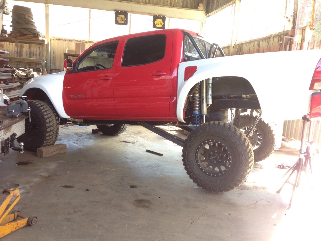

    Not true. Most off the shelf links will not work on a dcsb unless you want to put the c/o’s in the cab. Look at how far back the shock pocket is on the links in the picture above. Now look at how forward it is on the Camburg links. Sure you could cut down the end of the link that bolts to the axle but it’ll end up being far shorter than what’s ideal for a dcsb.

    uh no you’re wrong amigo. The shock location on most pre fab generic links will not work on a short bed. There is a lot more to link length and shock location than you realize.

    Oh and to the guy who is "building" his truck. Since it seems like you want nice parts and something that works good. Don't be scared and put the shocks in the cab. The dcsb trucks can't touch the longer bed trucks when linked because the shocks are so far back on the links. That being said when I get a flat next mine will be mounted right behin the back seat.
