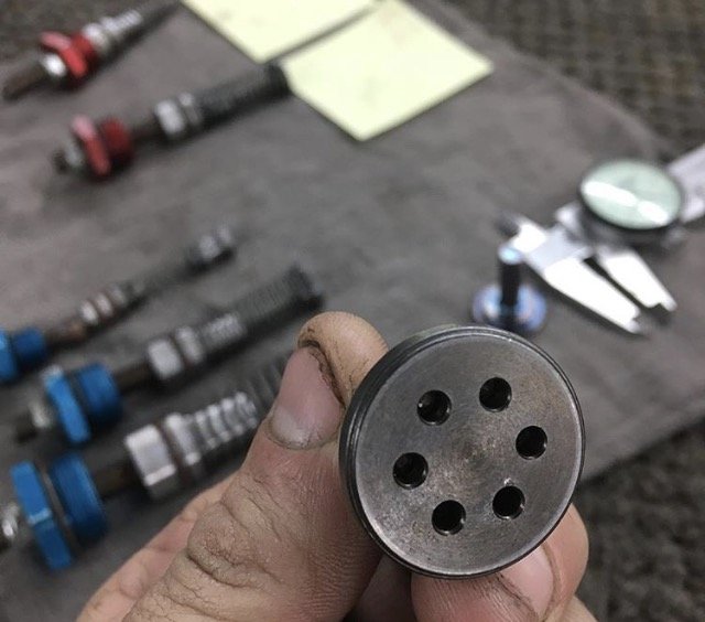

    Similar to the Fox gold valve? If i remember right the FOX gold valves bypass both ways

    Kinda. The gold valve is nothing but a freebleed tube that goes both ways. With the freebleed poppets wont ever flow as much as those and are more of a one sided change

    Giant motorsports shocks (solid shock co) are also setup with freebleed tubes too

    Damn...if you’re hungry you should eat a cheeseburger instead of your thumb

    Not mine lol thats my buddy at ads
