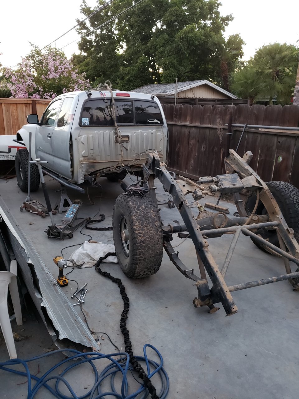

    Since this is the spacer bs thread
    Just for you @Evenflow
    Guess you won’t see my wheel flying down the hill now lol

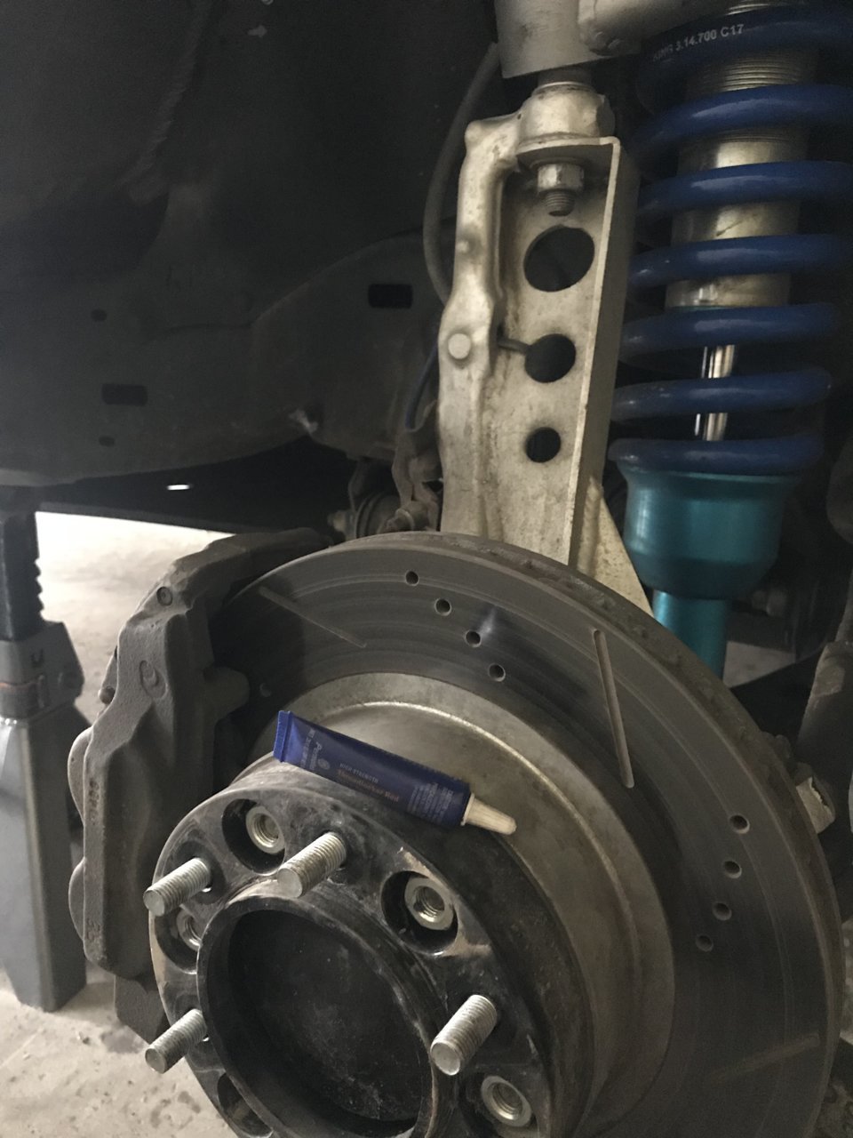

    i wouldn't use lock tight it eats up the oem zinc off the stud and will make them rust

    Every Spacer I have ever purchased comes with lock-tight and says to use it.

    Loctite prevents rust so it shouldn't really be an issue.

    :thumbsup: Bora says just tight to oem spec and wheel to oem spec...

    Nah I ran mine for a couple years and they said only to torque 12.5 mm studs to 70 ft lbs. w/o loctite. Checked them every tire rotation and never had one back off at all. Owner of the company told me in an email. Wouldn't loctite my lug nuts on my wheels either, but never can be too cautious - it for sure won't hurt you!

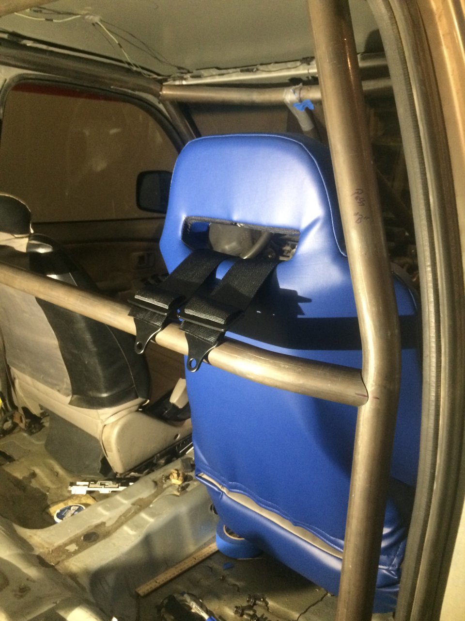

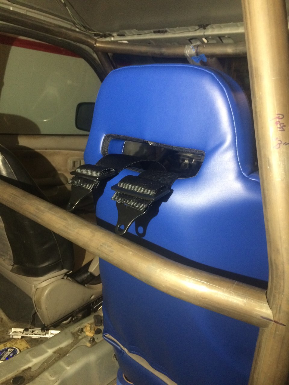

    Before I start cutting other tubes for the B pillar. I want to get your guys opinion on the height of the middle bar. I’m planing on welding on tabs to hold the straps. So basically what’s the rule of thumb for the strap location?

  15. Jun 19, 2018 at 7:51 PM

    My doors are the only stock things left besides the headlights

    Looks good from eyeball, make sure you got enough room to adjust the belts to fit you properly

    Cool thanks bud. I’ll keep that in mind.
