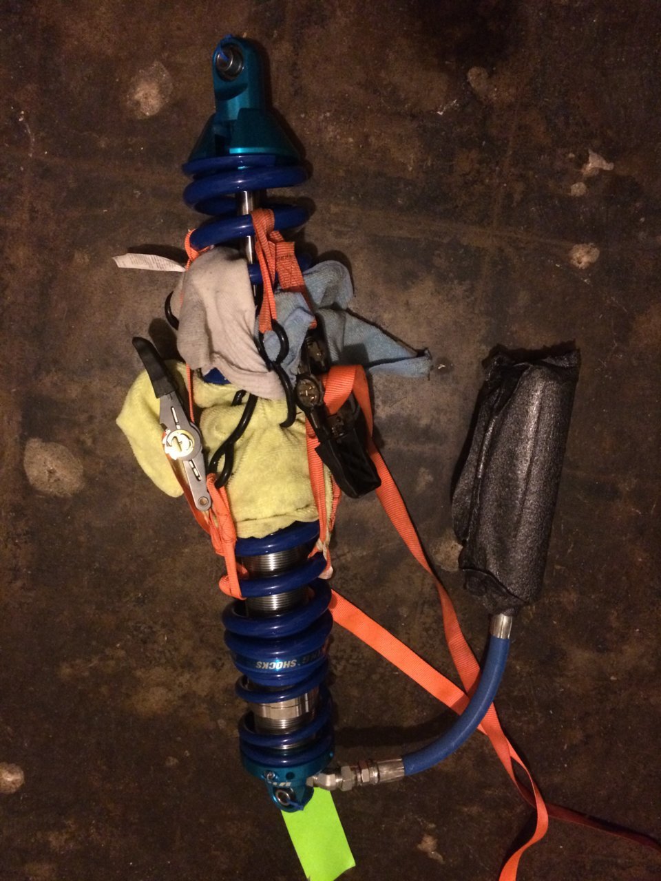

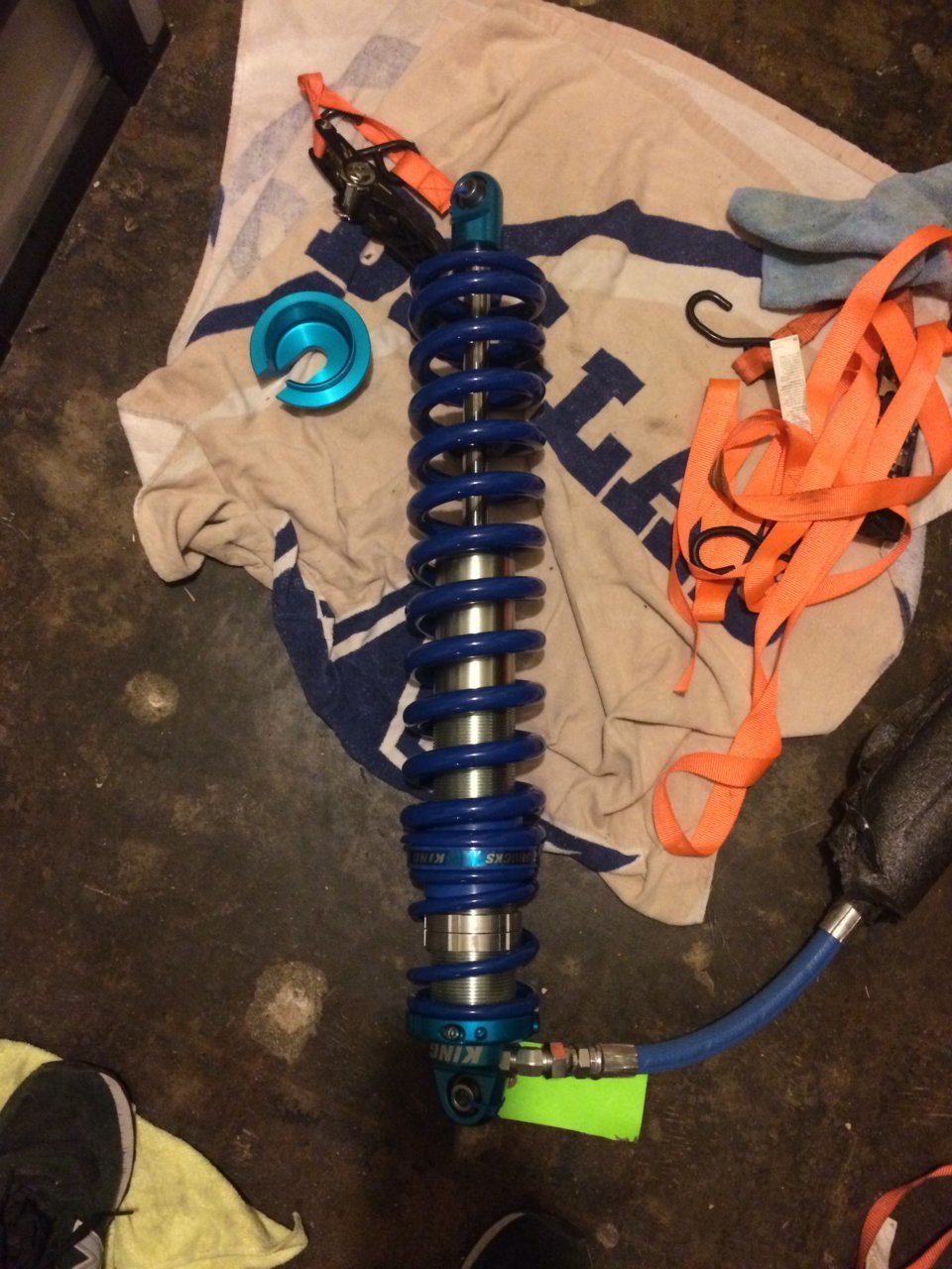

    Thanks - I think I'll have to compress it a little to get it to fit over the spring seat. It looks like the spring will be compressed no more than it is on my 10" coilovers when on there with the tender spring. Do part store compressors work for 3" springs - I've heard someone say they don't?

    I have a set of spring compressors that look like this:
    They don't fit the springs on my King's. They won't go between the coils to latch on.
    I'm thinking about buying this spring compressor to try out. https://www.amazon.com/Goplus-MacPherson-Interchangable-Compressor-Extractor/dp/B017H1AWMK
    A saw mentioned somewhere on TW that people have used spring compressors like this one. https://www.amazon.com/OTC-6494-Clamshell-Spring-Compressor/dp/B0002SRHU6

    I bought a clamshell style coil compressor from harbor freight for swapping coils on OEM bolt in Bilsteins on friends trucks and I hate it, had to cut it up and modify it to work and it still sucked.

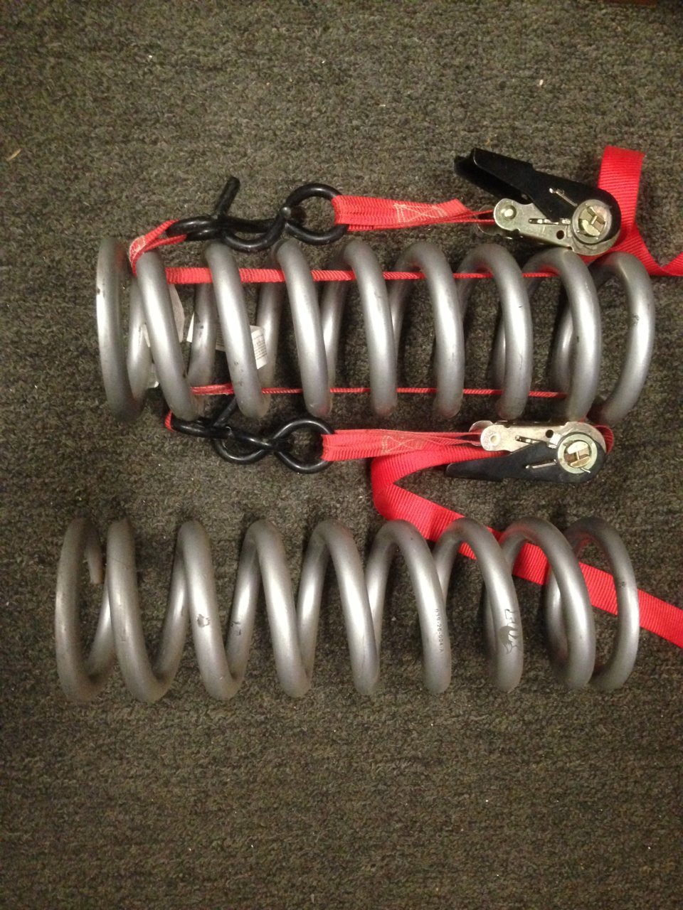

    You can use smaller ratchet straps for a little bit of compression, just keep the strap hooks on the outside and down by the shaft seat side so you can fit the coil over the body and then get the straps out easily.
    Use the threaded coil retainer to preload the coil a little once it's on the shock to take the tension off the straps before you unlatch them.

    Lol you read my mind!
    I was getting a little sketched out - it's hard to get enough pressure the way I was doing it and the hooks are a little too big to fit between the springs. I'll figure something out or I'll find a shop that's will do it for what I want to pay (like a nice 6 pack of soda lol).
    Maybe I should try one more turn closer to the ends...
    Edit:
    That worked!
