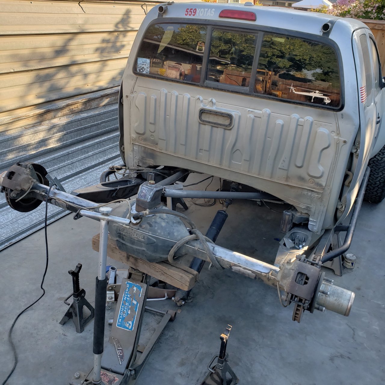

    My old 2wd T100 for reference. If you look close you can even count the 6 lugsIMG_0651.PNG.jpg

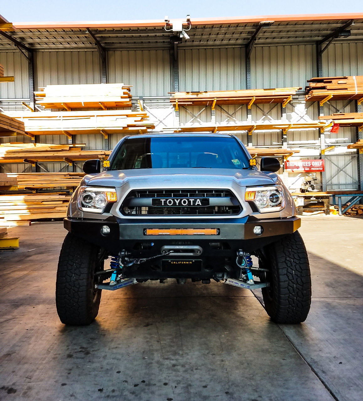

    Been lurking this thread for way too long, finally bit the bullet and picked up a TC +2" 4WD Kit.
    Photo is the night before my legit alignment.

    Thanks man! Still cant get my Camber and Caster dialed in 100% after 2 alignments. Going to replace rack bushings soon and tweak a few other small things.

    Upper link mocked up.... very little driveline plunge, 50% antisquat, bumps at 14" (jackstands are ridehieght basically) with 4" clearance from bottom framerail to ground...oh and it will fit 37's no problemo

    at flex wont those lowers hit the frame?

    Nah I checked....its close tho...the links kick out as they go to the axle some too(fights against link steer)...and if there was that much side to side action goin on....my shit ain't setup right lol. Swaybar too limits the flex factor too
