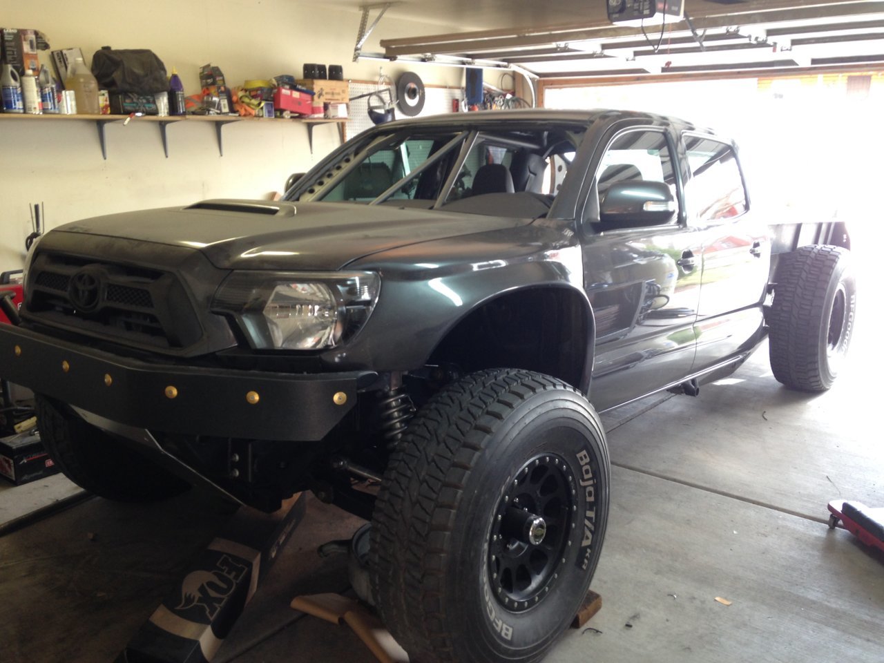

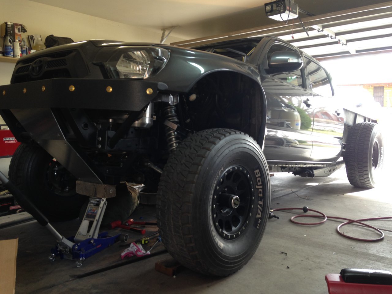

    I just went and double extra checked...full bump on one side and full droop on the other...then cycled it thru, it gets close to the slider but still plenty of room. The picture gives you an idea

    Looks like it will tuck 37s

    oh yea plenty of room, other picture looked a little close but was just perspective. looking good!

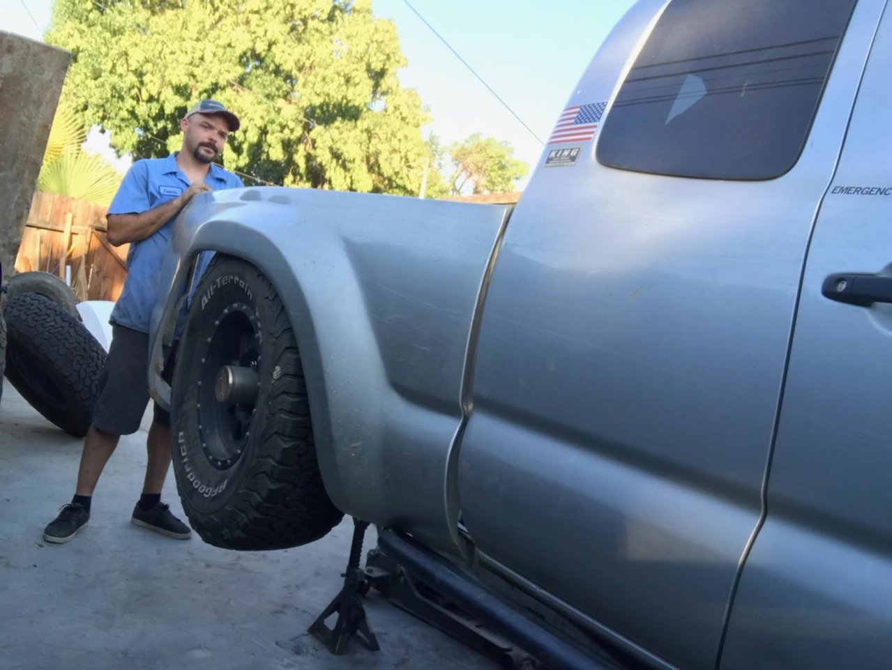

    999AA730-3381-43CC-B8B9-FCC46C4F1E8D.jpg E0E40C59-F7B4-4F9E-81EA-57B6CAC2675F.jpg I’d say your good for a couple more inches if your running 37s. Especially Toyos since they’re a true 37

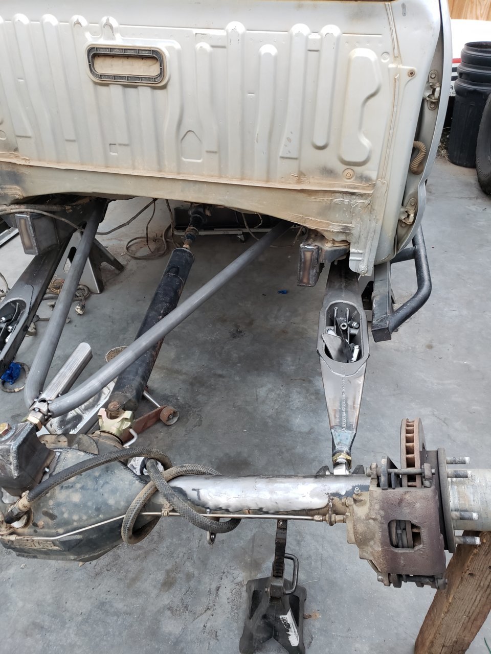

    Yea links are dumb right?....wait that's 14" of UP travel....down will be 16" ish...30ish overall

    So the link kicks out when it bumps when flexing. Interesting thanks for the pic.
