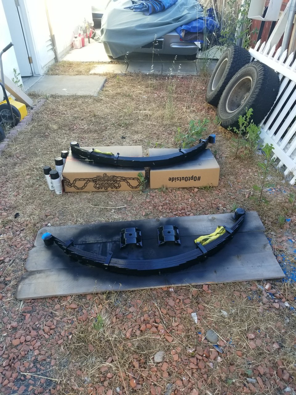

    getting every thing ready for next week
