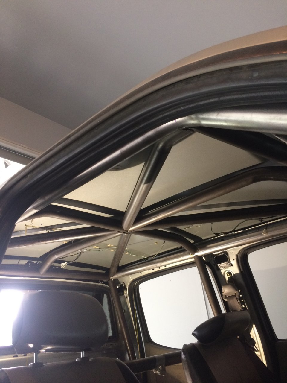

    Finished the roof to the cage.

    Looks good but is the roof rear diagonal on the dr c pillar notched only to the a pillar tube? It should be notched onto both tubes

    Yes it is bud. I was trying to figure out how I was going to weld 360 around every tube. What I was thinking is that I would be able to weld the front a pillar together. Then slide the roof forward over what I welded. But for the back I cant do that. I have to slide the roof C pillar back to slide in the rear roof tubes. If I notched the roof to saddle both A tube and C pillar, I wouldn't be able to weld underneath the notch. So I decided to notch to the A pillar tube to be able to weld it all together. I am going to add a corner gusset from the diagonal roof tube to the c pillar to give it the streangth it needs. It won't be as pretty but it will be strong enough.
    But if you have ideas to how I can weld under the notch at the A tube ,C pillar if i saddled the tube. I'm all ears. I would like to do it that way but this was the only way I thought of to do it.
