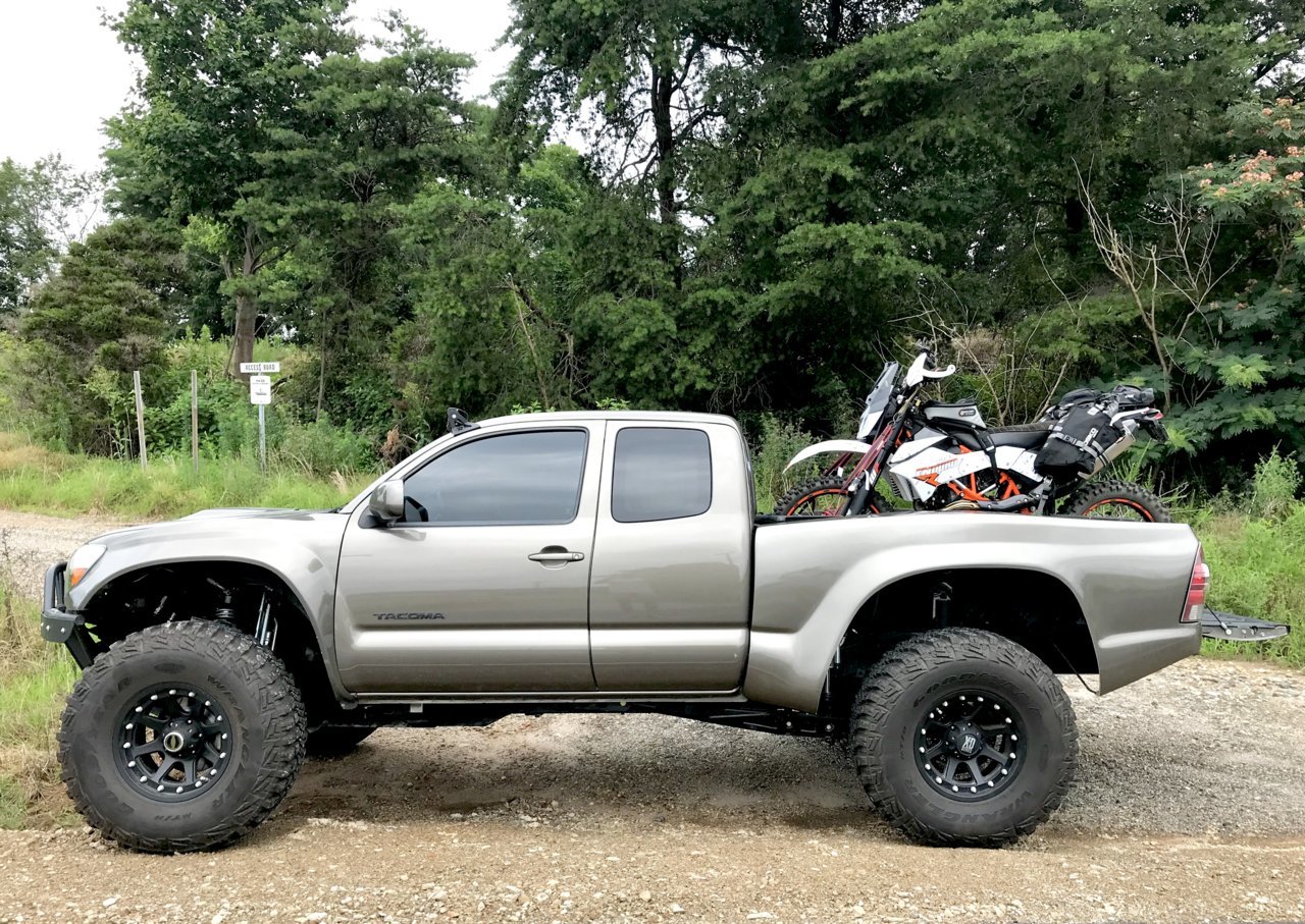

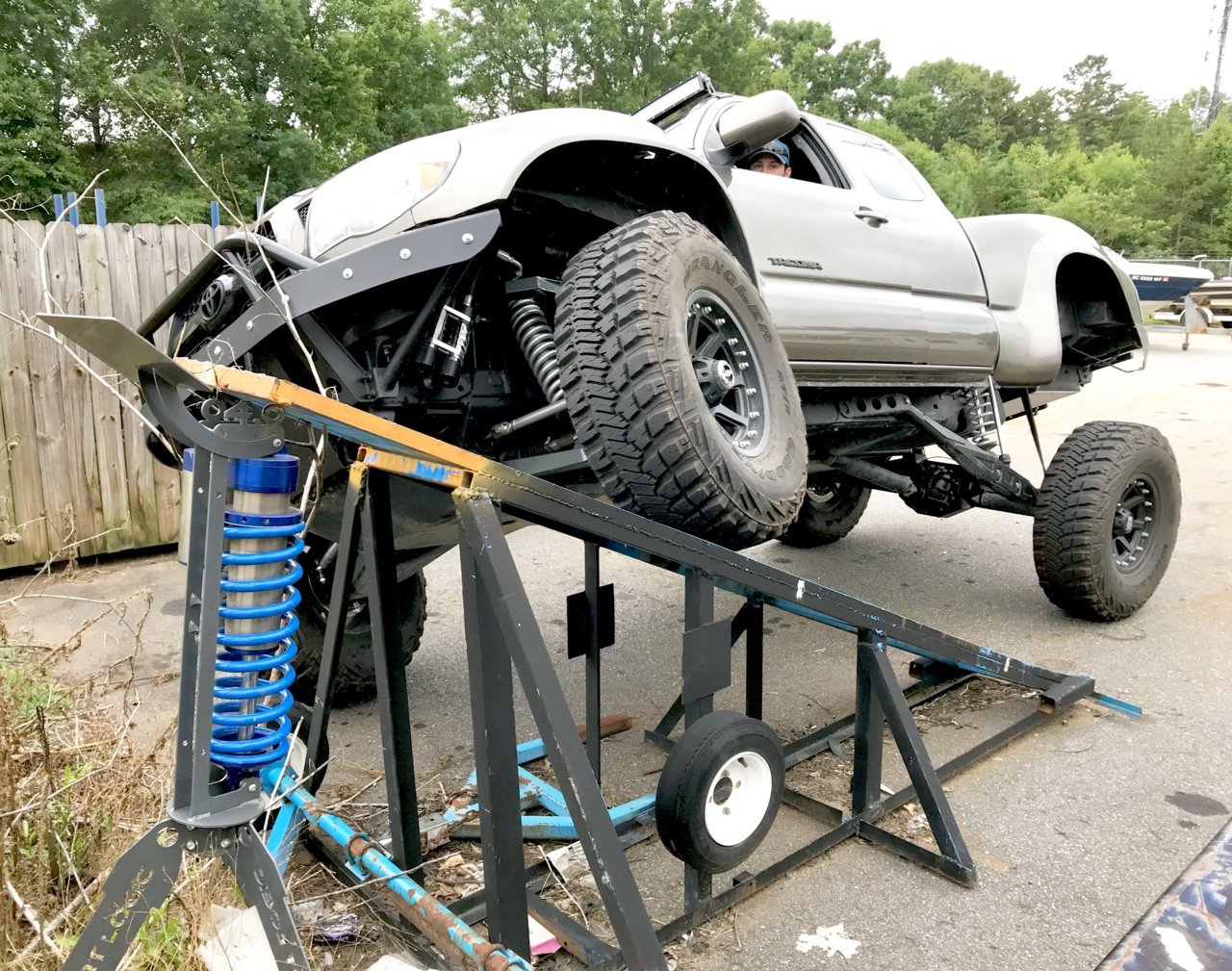

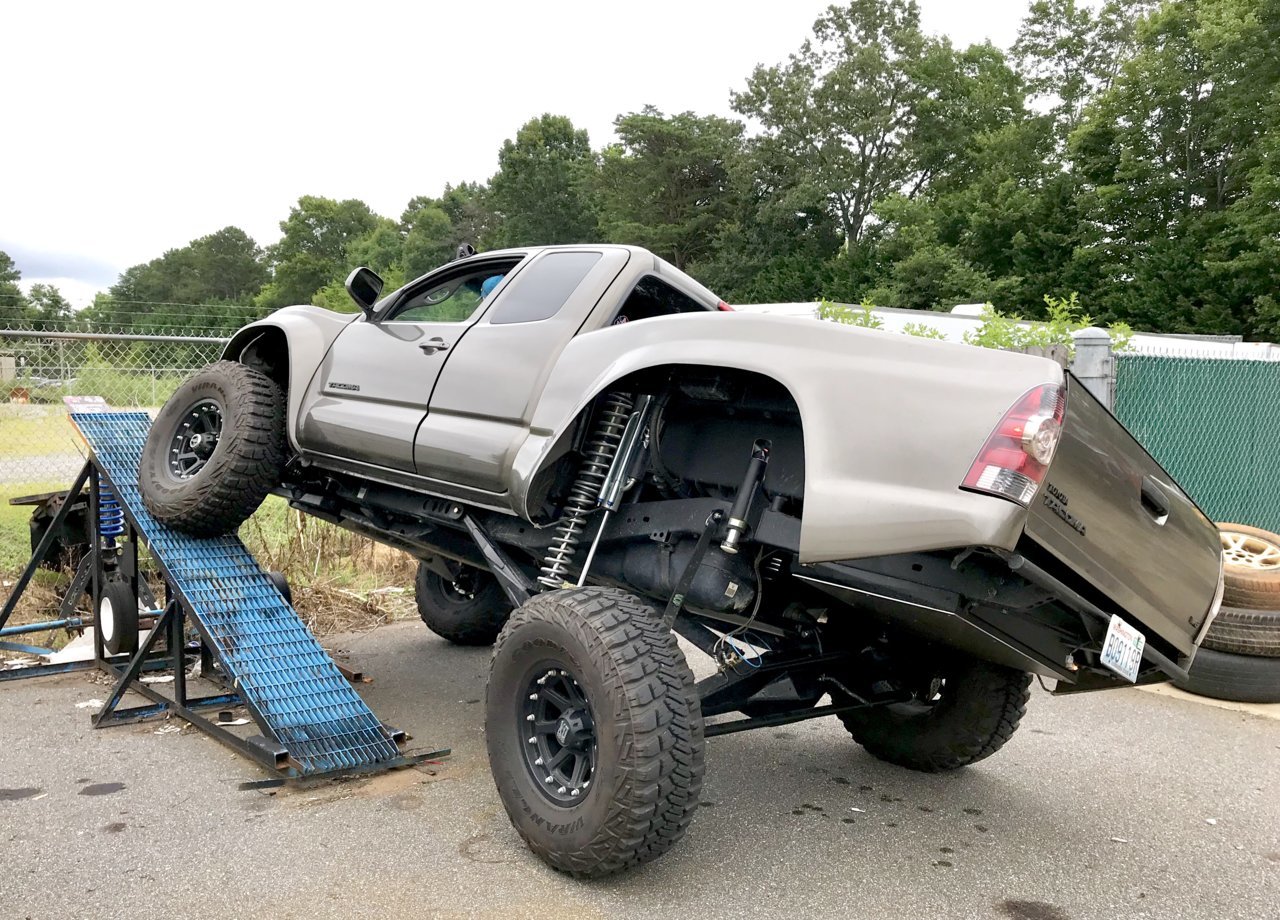

    Lots of travel in the rear, but front looks like it’s not budging

    Nah, he actually has one of if the highest travel # front kit made for our trucks. The lack of "flex" you are seeing is very typical of the IFS front on our trucks because we all run 600lb+ front springs.

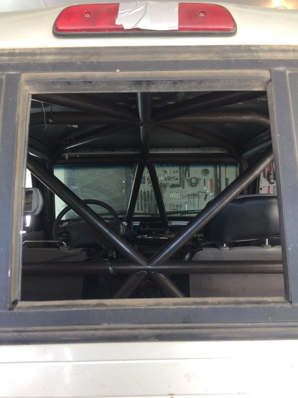

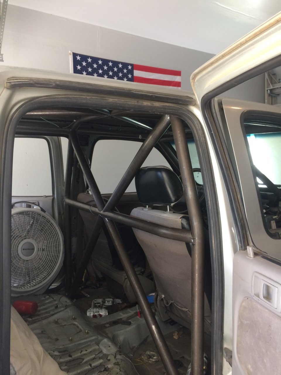

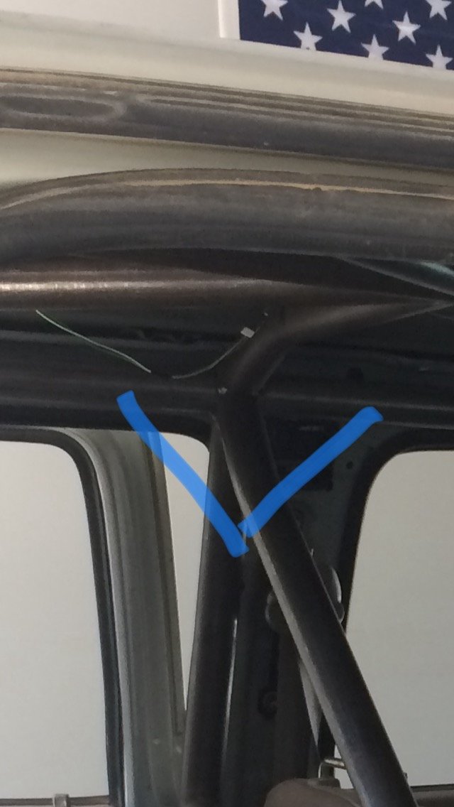

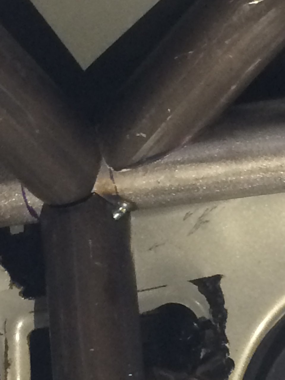

    B pillar done. Yes I’m going to add gussets on the T joint.

    T JOINT? Like by the seats? That T?....dont need to
    tubbsisland likes this.

    It's a pretty common practice...if your carefully with your cuts it's not that difficult to line it up and reattach it

    Why is there a coilover at the end of the rti ramp?

    Right here. Does it not need gussets here? The upright of the B pillar to the main tube that runs across the top. I’ve never built one of these so I’m learning as I’m doing.

    Ah that junction... probably be just fine without em
