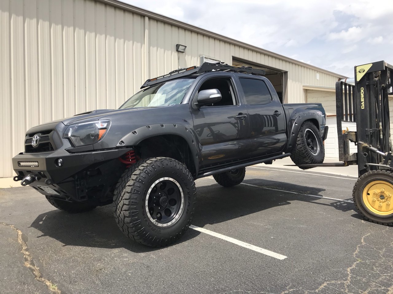

    Some shots of the recent changes to my taco. Took me 2.5 days to do start to finish. It was ALOT of work but not i'm looking forward to doing the front now!
    DMZ Fab bedcage
    DTF SUA Kit
    Deaver E30 Springs
    16" Triple Bypass 2.5 King

    How does it articulate with the stock beddies?

    I added a couple more photos of it flexing above. When flexing one side at a time with the forklift it cleared just fine (i trimmed about 1.25" off of my fenders earlier for the 35's). When we were in Moab last weekend I discovered that when both sides are tucked at the same time it puts my axle back farther and I hit my bushwackers so i had to do some hacking on the trail to get them to clear. I will need to do a little more on the new set of bushwhackers but that is it!

    Did the cage get welded to the frame all the way?

    yes it did. we chose not to drill and bolt it... way faster to weld it on.

    Ah good stuff man, I was gonna say if you didn't cut it up I would be cautious...looks good! :thumbsup:

    I did the same with the legs on mine...I don't know if the bolts would ever come loose over time, but I didn't want to keep tabs on them especially once the frame gets boxed.
