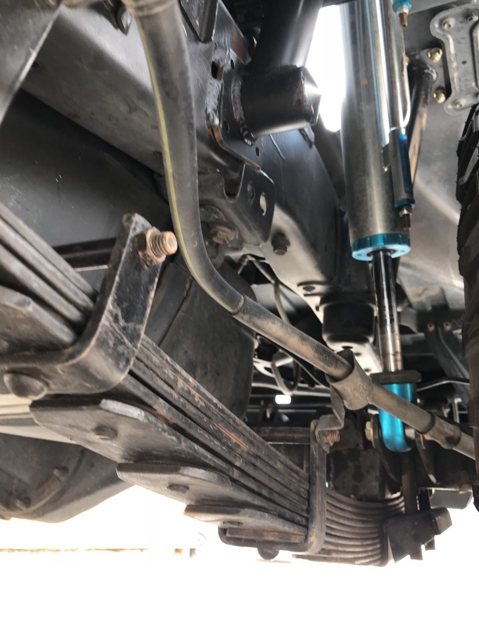

    the TC spring under kit works on the 5lug pulling 14"

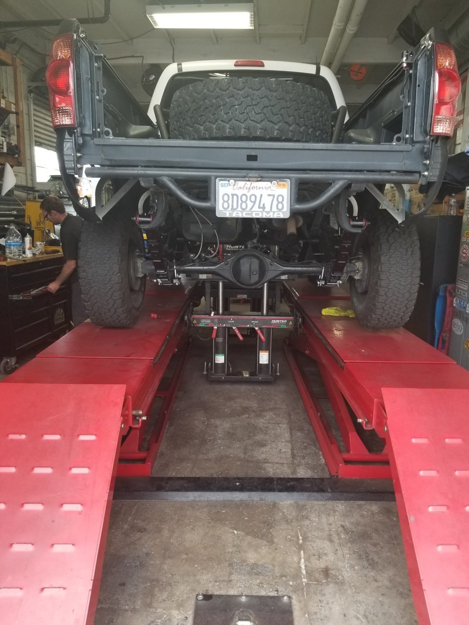

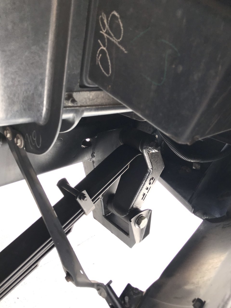

    DEAVER SPRING ubolt torque? 100 foot pounds ?

  13. Jul 18, 2018 at 8:43 AM
    paranoid56
    paranoid56 Well-Known Member
    Jul 25, 2012
    #83443
    3,442
    San Diego
    14 double cab taco
    you need to fix those ubolts. they should be not at an angle like that.
    raco.the.taco likes this.
  14. Jul 18, 2018 at 8:45 AM
    dillonk1602
    dillonk1602 Well-Known Member
    Apr 2, 2013
    #101176
    1,031
    dillon
    san diego
    tacoma 5 lug
    Vehicle Modifications: TACOMA 2007 FRONT TOTAL CHAOS 5LUG ,LONG TRAVEL KIT 13" OF TRAVEL KING COIL OVER (550 POUND SPRING RATE) (18 INCH COIL) REAR BED CAGE 16" SMOOTH BODY FOX SHOCKS 2.5 2.0 / 2.5 BUMP STOPS FOX ICON ADD LEAF PACK WITH OEM SPRING 11" OF TRAVEL TRUCK COMES SPRING UNDER BY MANUFACTURE TOYOTA REGEAR TO 4.0 WITH AUBURN UNIT ENGINE 2TR-FE WITH AFE COLD AIR IN TAKE DOUG THORLEY HEADER MAGNAFLOW EXHAUST TIRE S NEW KO2 32/11.5 METHOD RIM 15" WITH -20MM OFF SET
    i got the kit used and the ubolt plates came like that
  15. Jul 18, 2018 at 8:46 AM
    paranoid56
    Jul 25, 2012
    #83443
    3,442
    San Diego
    14 double cab taco
    the ubolts themselves. you have them at an angle. if nothing is keeping it that way, go tap on the top of ubolt to make it straight. once it does that (either by a hammer or just driving) that ubolt will now be loose.
  16. Jul 18, 2018 at 8:53 AM
    snowsk8air2
    snowsk8air2 how hard can it be?
    Sep 16, 2011
    #63607
    10,539
    Flagstaff, AZ
    Supercharged TX Pro
    2011 S/C and basic mods
    This
    You want them as straight/ vertical as possible.
    dillonk1602 likes this.
  17. Jul 18, 2018 at 8:55 AM
    dillonk1602
    Apr 2, 2013
    #101176
    1,031
    dillon
    san diego
    tacoma 5 lug
    going to drive it all this week and retorque the ubolts. taking the truck out this weekend. or should i wait?
  18. Jul 18, 2018 at 8:59 AM
    FlapJack935
    FlapJack935 i member
    Nov 25, 2013
    #117294
    3,196
    Jack
    Abq New Mexico
    Wannabe Trophy Truck
    Sick Gnar Trophy Truck Tacoma and King Ranch Raptor Killer
    you should fix them before you even drive it...

  19. Jul 18, 2018 at 10:35 AM
    txmxer
    txmxer Well-Known Member
    Jun 20, 2010
    #39228
    1,742
    California and Texas
    06 dc tacoma
    - Total Chaos 3.5 Long travel kit - Fox 2.5 coilovers w/ resis -Prerunner bumper -Fiberglass front fenders -Fiberwerx tt bedsides - Dmz Sua - fox 2.5x16 triple bypasses
    Just loosen it and straighten out the ubolt, not ubolt plate, and retorque.
    Im sure you'll enjoy the extra travel over the previous set up, have fun!
