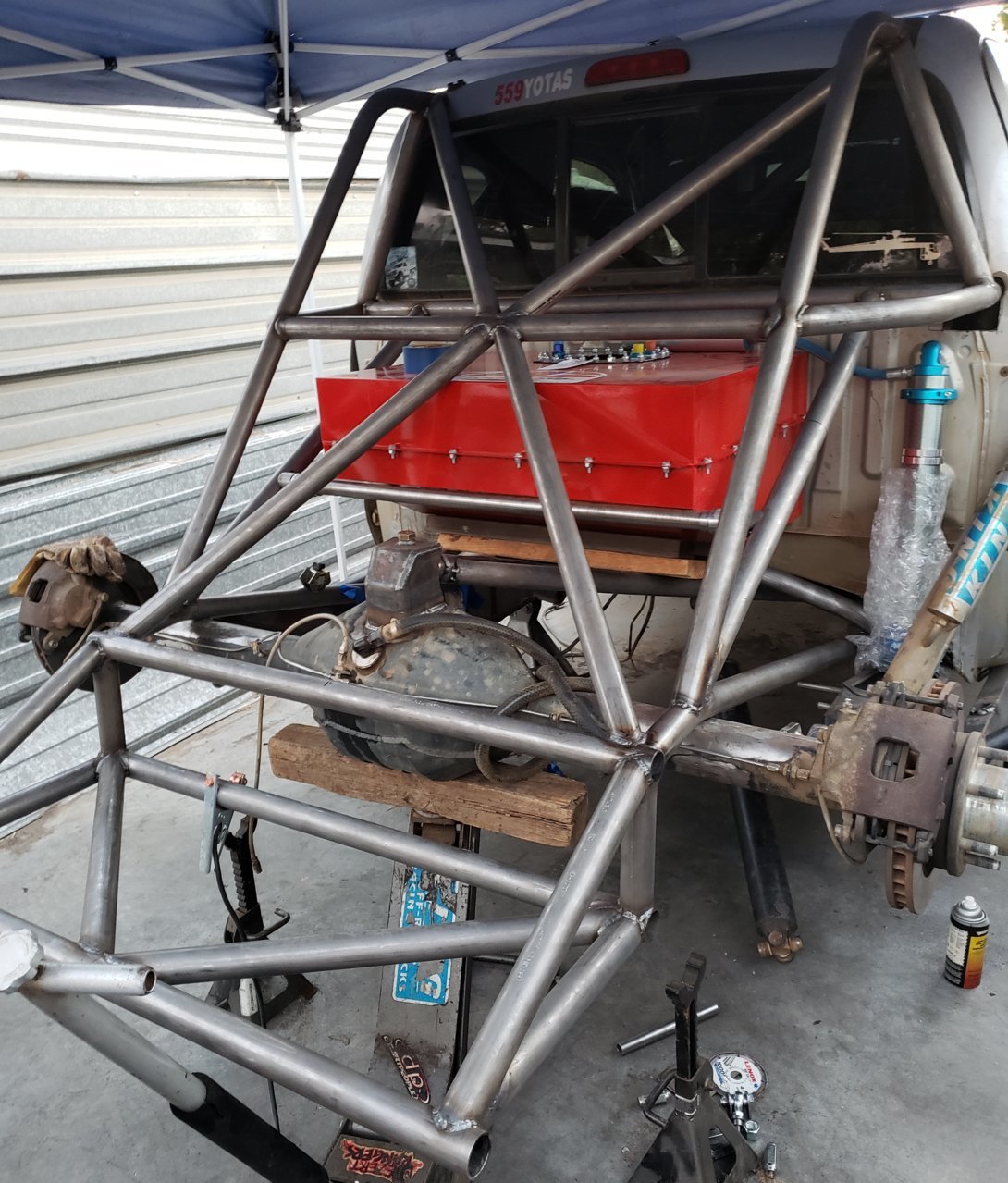

    Fuel cell is almost resting in its home...few more tubes in...PROGRESS!!!

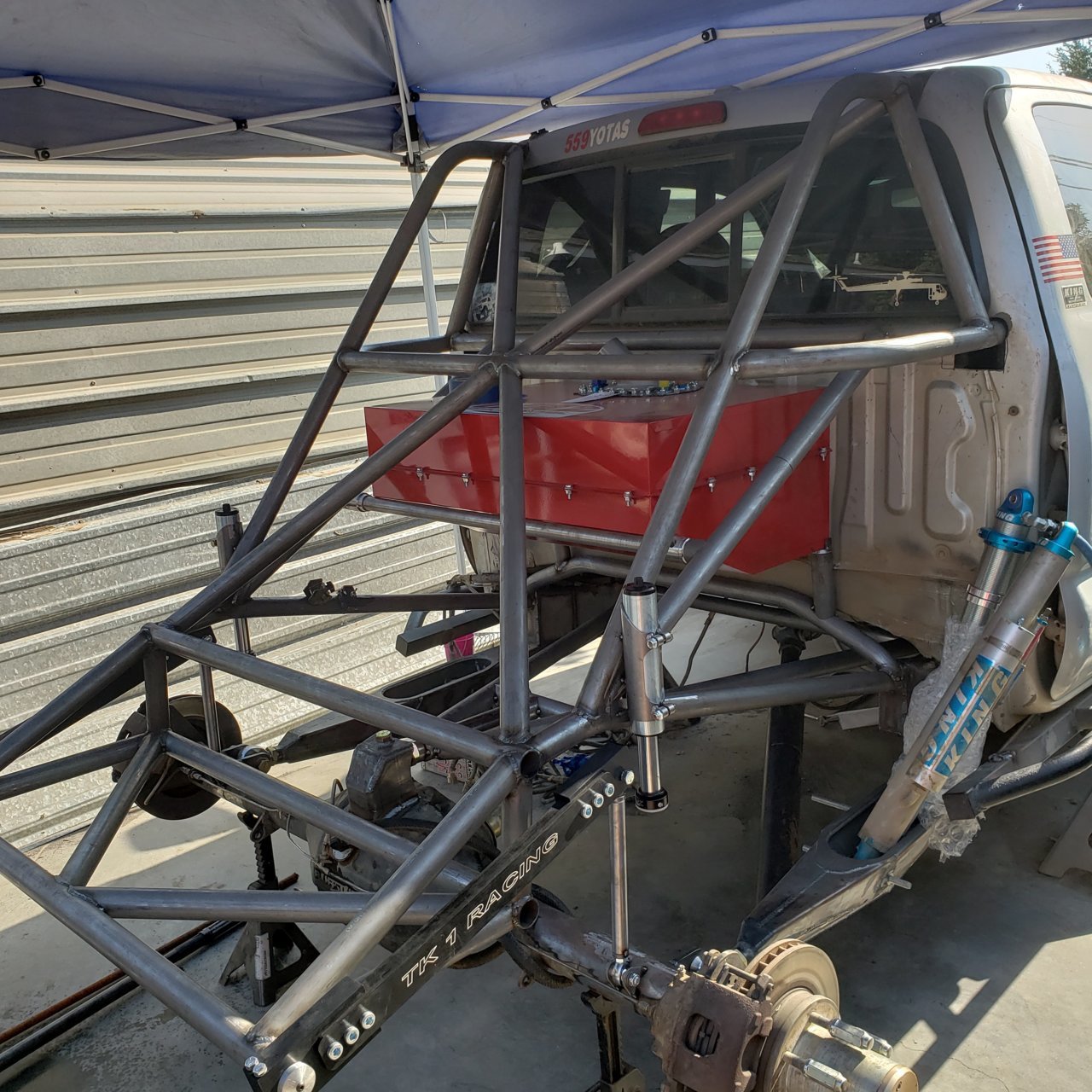

    Speaking of bumps got mine located and tacked on today and the swaybar links figured out...there about 3/4" of clearance between the swaybar arm and bumpstop lol. And got my fuel cell feet and crossmember bent up and in... soo hard to stay motivated in the heat here...was 108 today
