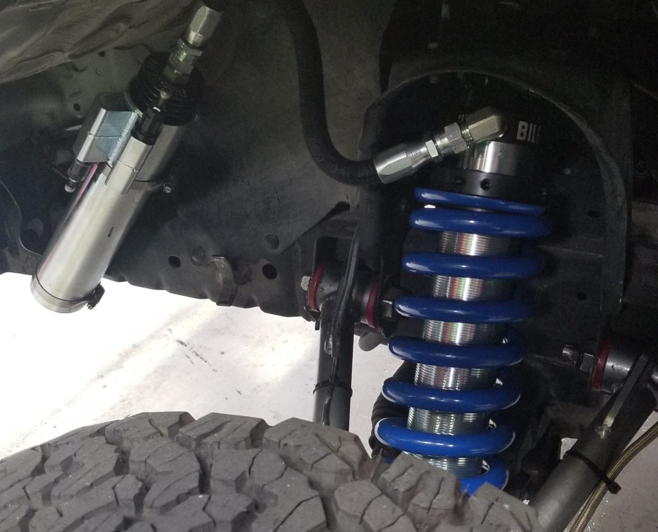

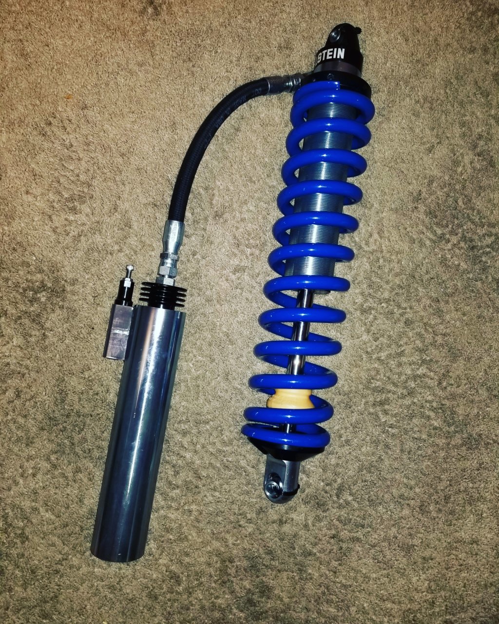

    New custom shocks, Look at the reservoir

    Those Billies are sick. What are the specs?
    I know bilstein makes some high caliber equipment but they're so hard to find information on.

    There 8" 2.5

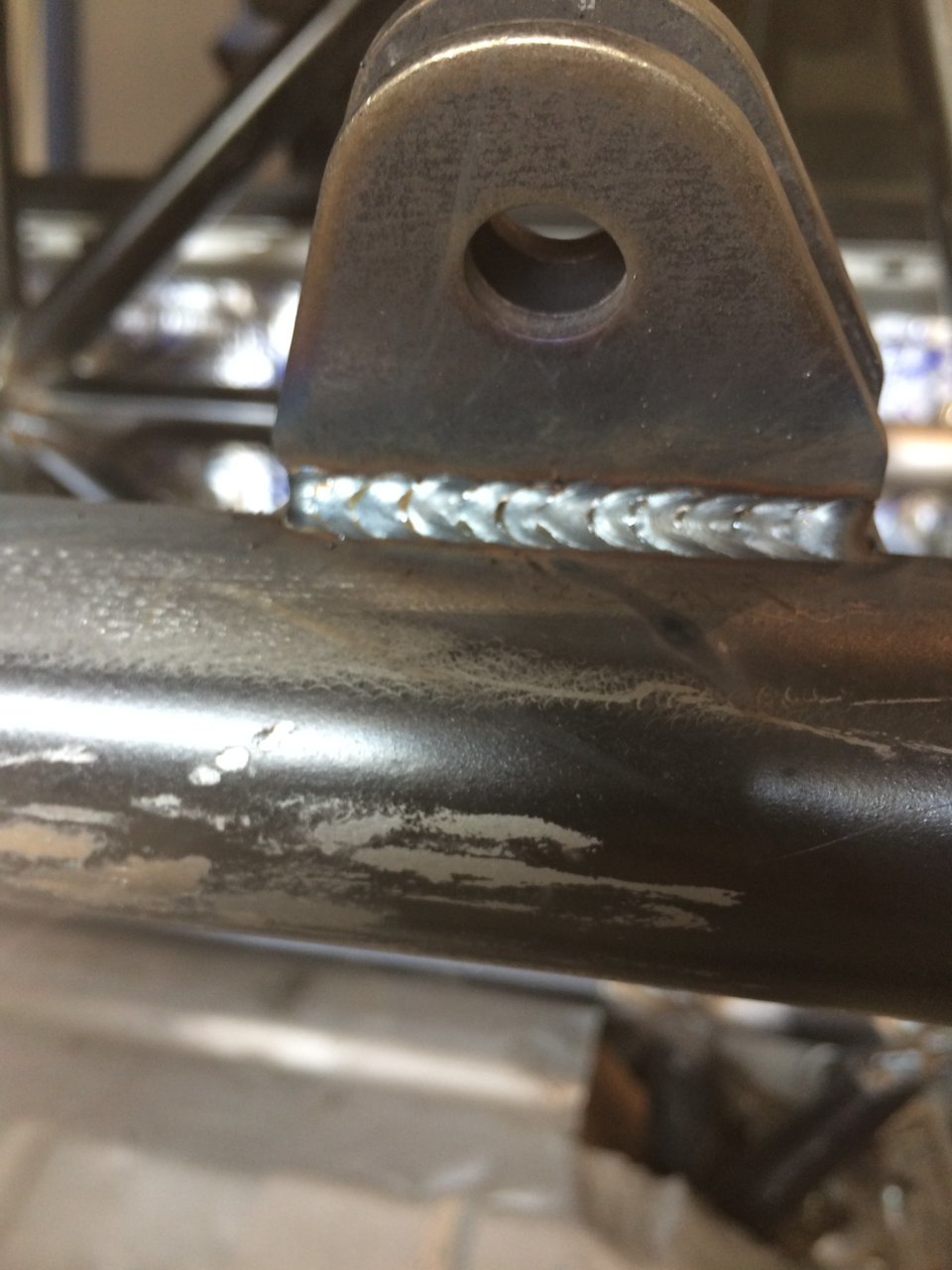

    Hey gents, The cage is pretty much welded in but I need some advice on a couple of things. I will be running tube across the floor from front of the truck to the back. But my question is do I really need to tie in those tubes across the floor from driver to passenger? My seats come with bolt in mounts so I dont need the tubes for the seats. For the harnes tab on the inside by the center console I was going to weld the tab to a plate and weld the plate to the floor insead of running tubes between the seats just for harnes tabs. What do you guys think. Thanks!

    I'd run tubes....they can be smaller...I'd make the seats and all safety stuff one with the cage and separated from the cab. Those across tubes kinda act as crossmember too for the frame of u think about it...helps with gettin into a t bone accident.

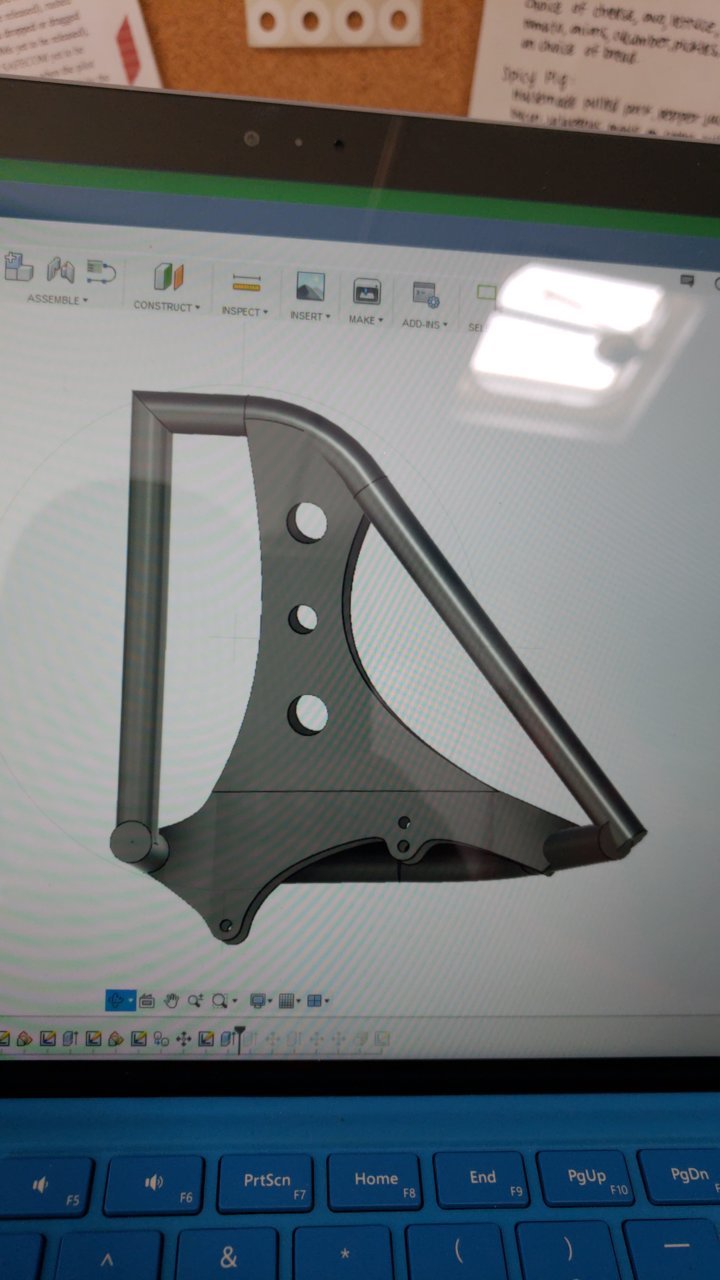

    Since I'm ar work doin the fires up north had a chance to start sketching up some shock towers for my truck

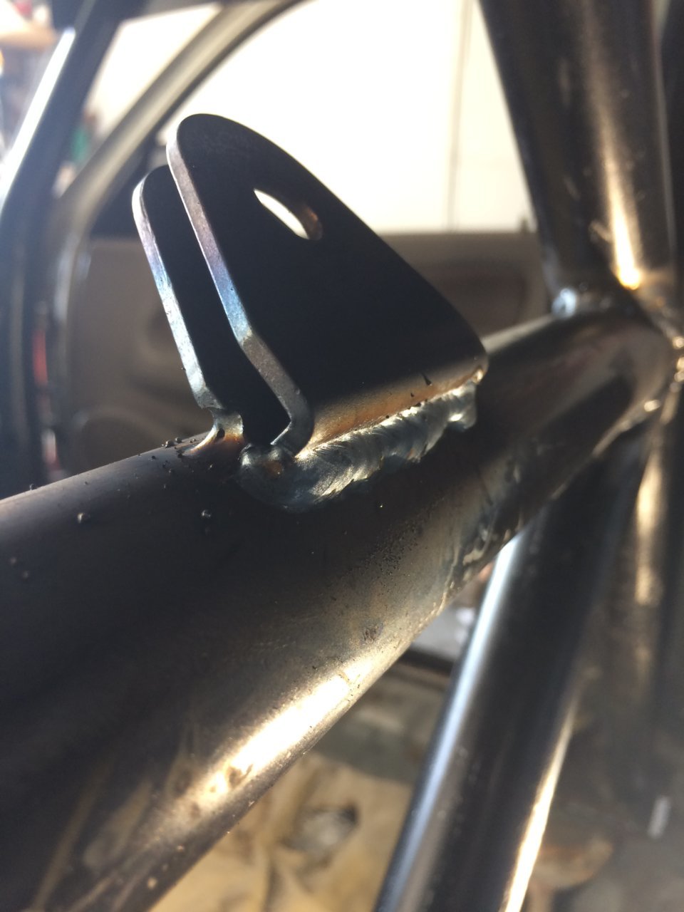

    I only ran two passes on my shoulder harness tabs. Should I run one more pass to bring the weld up to the edge of the tab on the back side and fill it in?

    Yea you could...prolly look a lil better...its fine tho

    Would there be any downside to doing another pass (besides extra time, albeit not much of it)?

    No in this case not at all...let it rip
