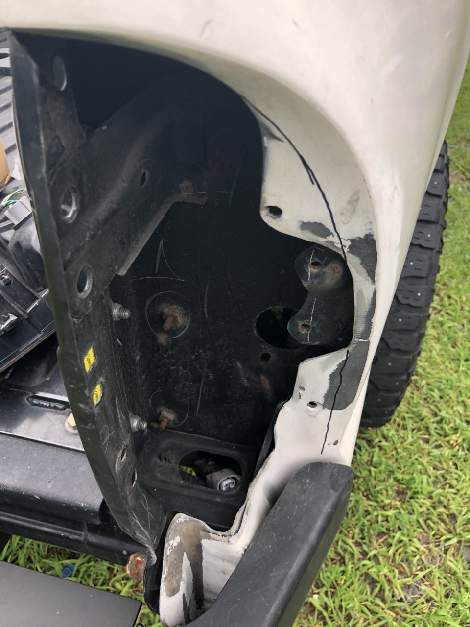

    Do a lot of guys cut the rear light pocket out of their bedsides so it can be removed easily as a panel without removing tail lights, bumper, etc?
    Thinking of cutting along that line and making a bracket for a couple fender washers further forward.
    The difficult part I’m trying to imagine is how to secure the tail lights better since they only attach via too screws. Bend up a bracket and Velcro?

    Maybe @dirt addiction can get you a pic of his setup. I saw it last weekend and it was slick and simple. I plan on doing something like his at some point.

    @dirt designs cut the OEM mounts off the rear fendersffor the lights out, then made brackets to hold it up. I can remove my bedsides and the lights stay in. I'll try to get some pics when I get my truck back

    CA6DB202-6CA2-456D-A665-8EFBE8AB21E7.jpg I built mounts. Just unscrewed plastic retainers and got bolts with same pitch, used tubing capped off with a hole in it. Takes 15 minutes to pull bedsides now

    Awesome, and you’ve definitely proven that stands up to the test. I’ll get on that tomorrow, thank you.
    Yeah, I salvaged those pieces off the bedsides (if we’re thinking of the same thing). They’re the vertical pieces that have all the captured nuts the bed gate hardware mounts to, correct?
    I was running no bedsides for a while with the lights attached by the two mounting points until they were flapping in the breeze driving down the turnpike.
