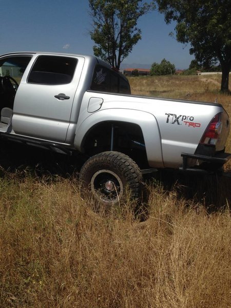

    Vehicle Modifications: TACOMA 2007 FRONT TOTAL CHAOS 5LUG ,LONG TRAVEL KIT 13" OF TRAVEL KING COIL OVER (550 POUND SPRING RATE) (18 INCH COIL) REAR BED CAGE 16" SMOOTH BODY FOX SHOCKS 2.5 2.0 / 2.5 BUMP STOPS FOX ICON ADD LEAF PACK WITH OEM SPRING 11" OF TRAVEL TRUCK COMES SPRING UNDER BY MANUFACTURE TOYOTA REGEAR TO 4.0 WITH AUBURN UNIT ENGINE 2TR-FE WITH AFE COLD AIR IN TAKE DOUG THORLEY HEADER MAGNAFLOW EXHAUST TIRE S NEW KO2 32/11.5 METHOD RIM 15" WITH -20MM OFF SET
    So guys I found out that my ring and pinion Angle is off what do you think about 4゚ shims for the rear end

    What is your pinion angle? Do you have driveline vibes? Why do you think it's wrong?

    Truck at offroadwarehouse and they say it off by 4 Degrees and no drive line Vibration on freeway but the Differential does look pointed down.

    I haven't got check the ring and pinion angle since I did that Spring under kit on it I did the total chaos Spring under kit from the 6 lug to my truck and the 5 lugs has a longer front hanger then the 6 lugs so it providing more lift on my truck plus i had to take out 2 leaf Because it was way to stiff

    How did you set the pinion angle when you installed the sua kit?

    the 5lug 2gen tacoma are Spring under by factory so I use the factory purges
