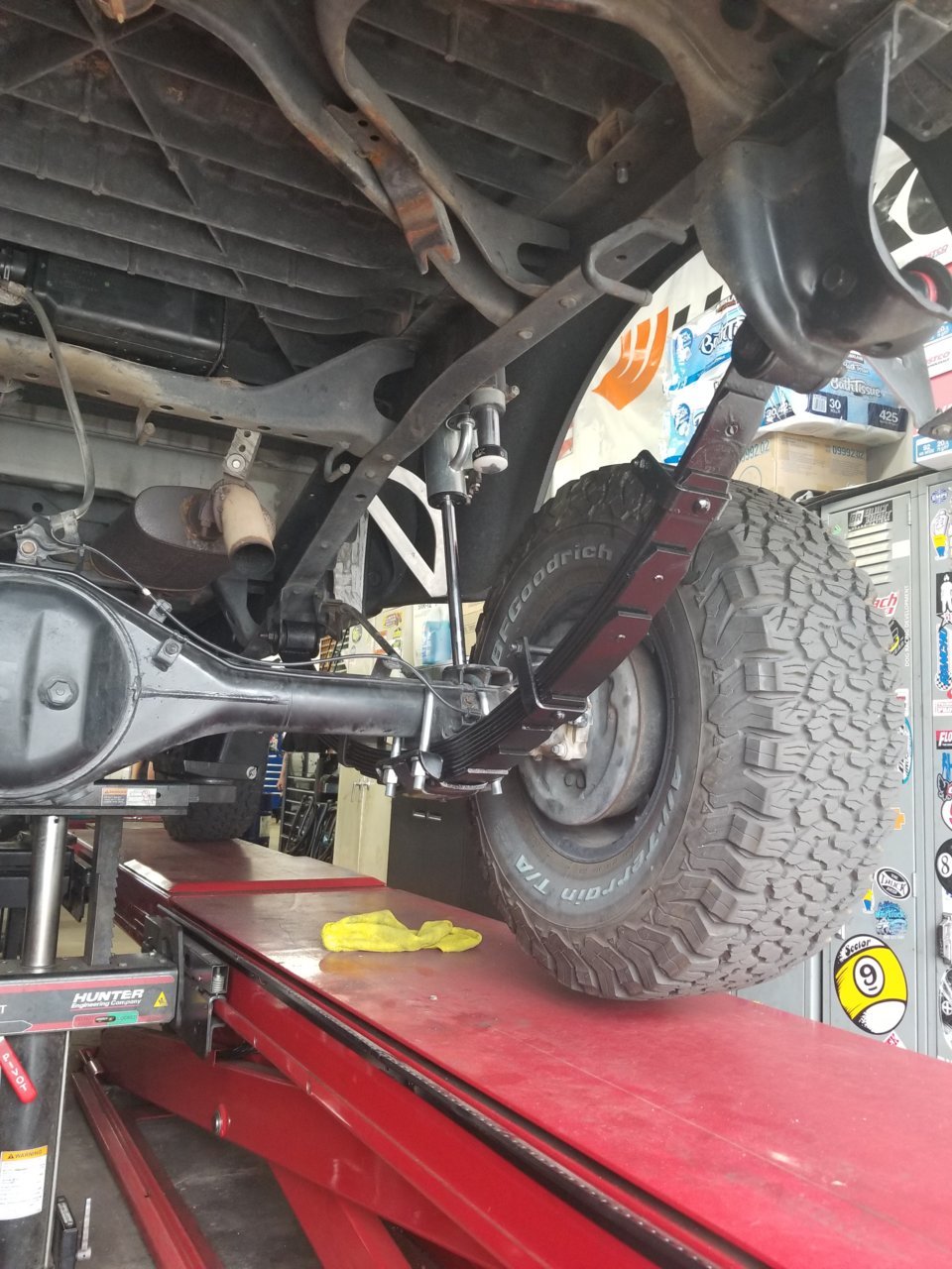

    If no driveline vibes then I wouldn't worry too much. Most shims however are around 2*so if something is setup wrong I would fix that. Welding on new spring perches sucks but it the right thing to do. I'm around 2.5* pinion angle at ride ht and have no vibes or issues

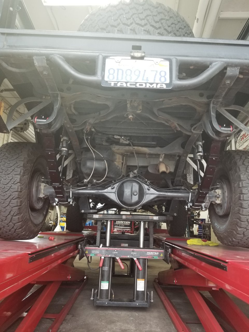

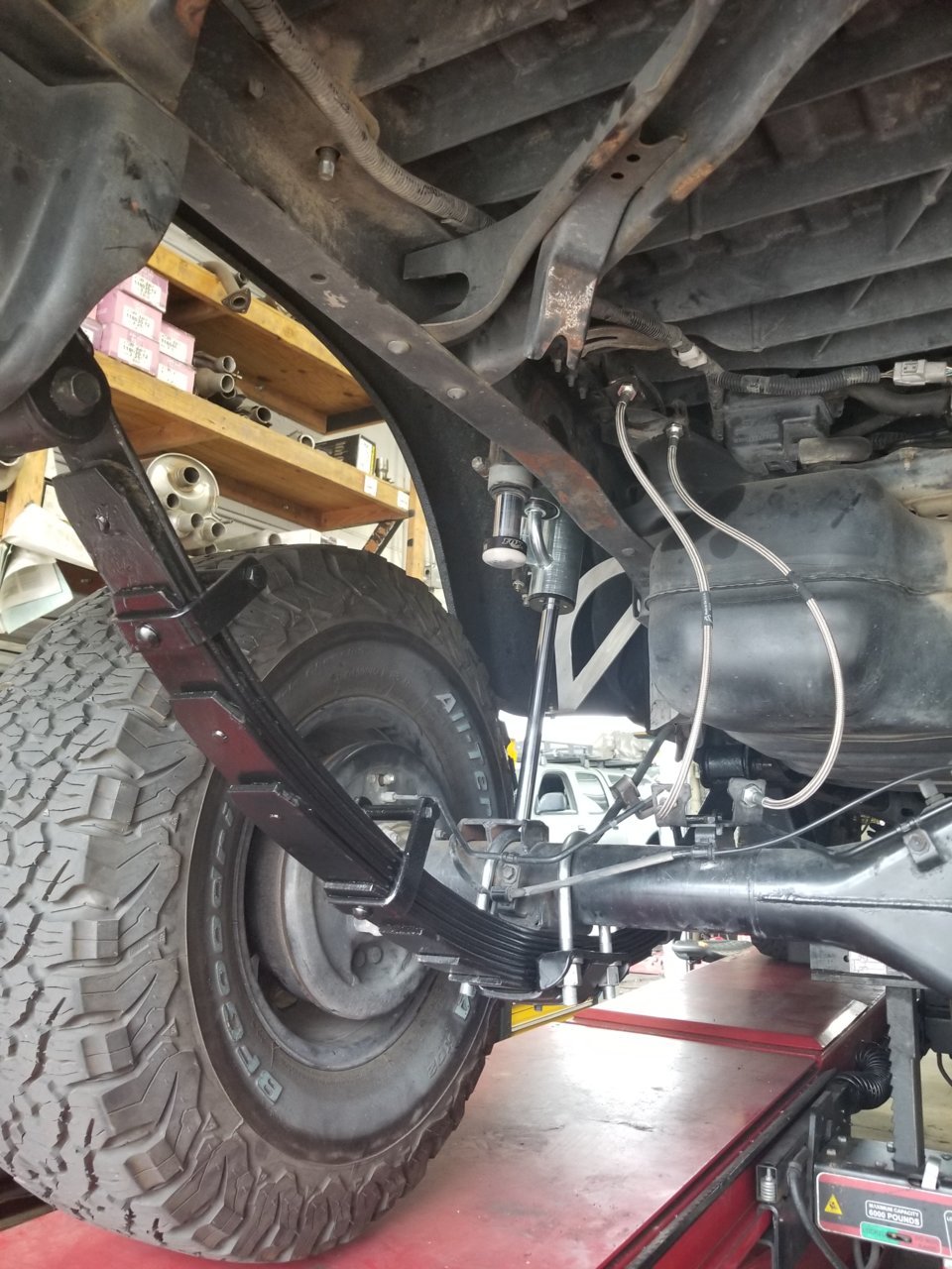

    Last time I saw it at full droop and yea I fixed the ubolts

    Not the best pic but ....
