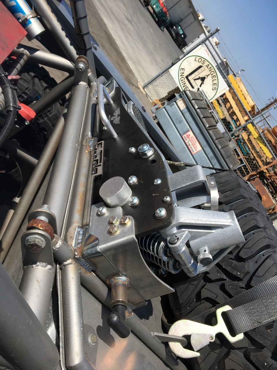

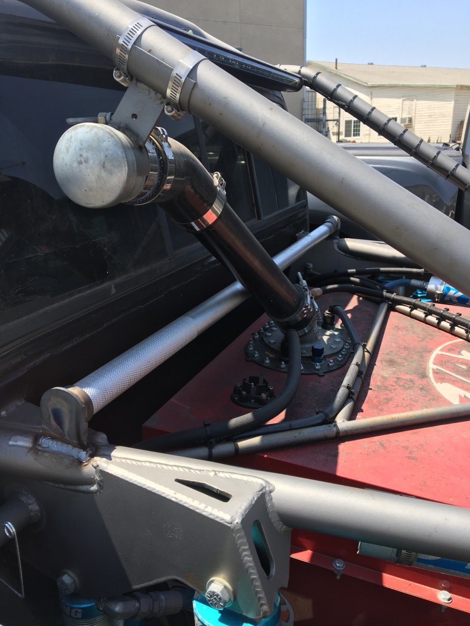

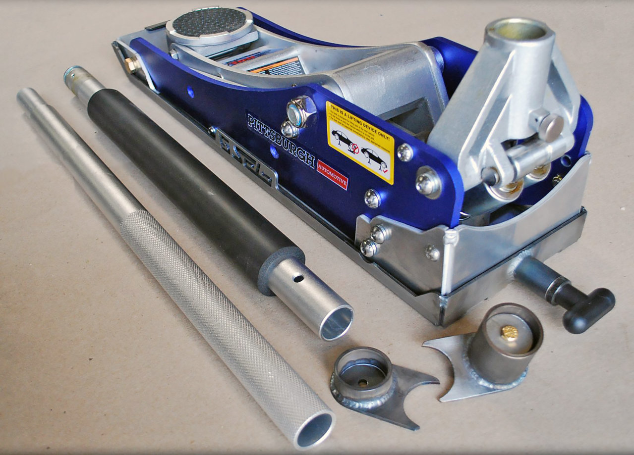

    I have the pro eagle one.havent really tested it out.

    Nice set up man, mine has the big plastic wheels on which make it entertaining to pull around. Def lifts up the truck without issue and man that jack is stout af.

    Thanks man. Yea I have the 3ton with the big wheels as well(wedding gift). But I have put the jack through some abuse. Definitely like the jacks. Just the like solos mount better than the pro eagle one.
