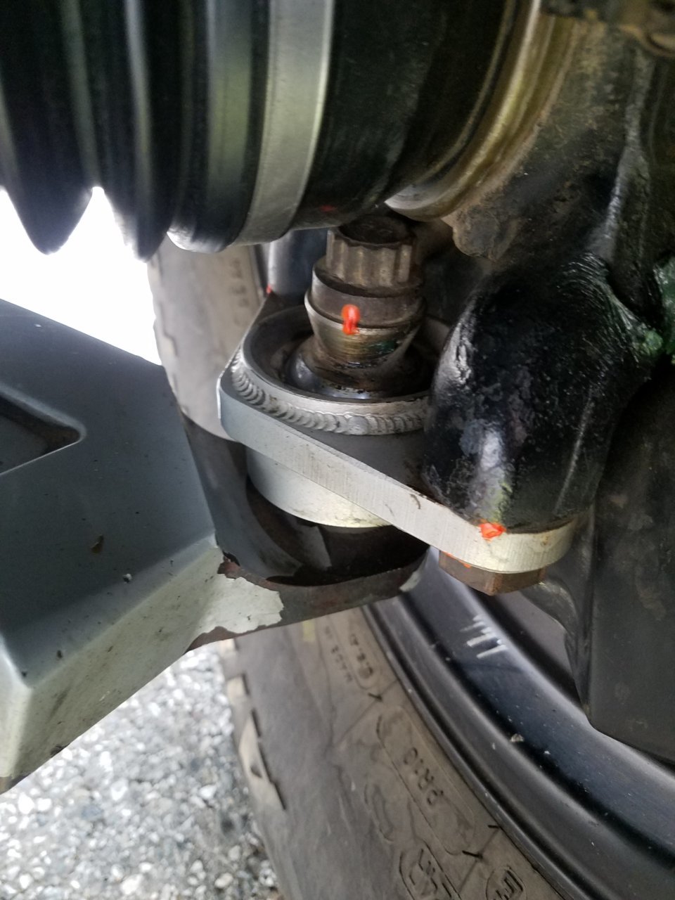

    Those lower uniball adapter bolts are a bitch, mine would constantly need to be retorqued. New bolt, new nut, didn’t matter. Total chaos told me to double nut it. Or just tac a little weld if the problem persists honestly.
    If I go LT again I’d get race lowers with integrated uniballs or choose a company with integrated uniballs. No adapters, pita.

    ill be ordering a new bolt. maybe it wasnt torqued tight enough (i got the kit used) and it worked itself loose after some driving. definitely something funky going on, but its tight now i guarantee that.
    true. ill see how it is when i get the chance to pull it apart. luckily its not going anywhere for a couple of weeks.
    tac weld seems easy enough for a new one. i should have just said fuck it and bought tc +3.5. none of this used +2 shit

    Mine was on a total chaos 3.5 kit... yours could be isolated to a one time thing but mine was weird. Tac it to be safe or double up.

    definitely. hopefully ordered the correct bolt 3/4inch x 4.5L :notsure:
    will do, thanks for the tip

    4.5" more that plenty. What type and grade bolt did you order?

    grade 8, zinc yellow-chromate plated

    id be a little worried about bolt head to axle clearance with those 12pt bolts. they tend to have a taller head i thought. there isnt a ton of clearance as is.

    I've never had issues..

    Solo machines a bolt head down to a 1/4" or 5/16" in that place - if you had to take some off the top I don't think it would be a big deal for the torque you're probably torquing it to.

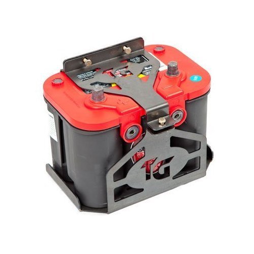

    optima battery yellow top #35 would it fit this ? just got new battery looking for something that would work with a 35.....

    Yes

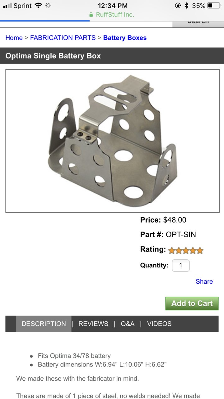

    You need the 34/78
    I have this one brand new that I’m selling

    Trail Gears website says 34/78 group.
