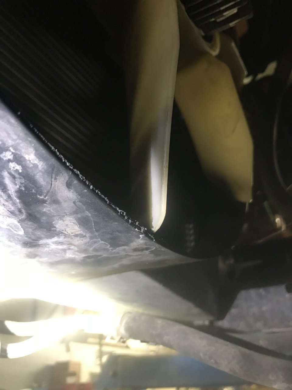

    Ended up installing the motor mounts myself tonight. They fit up to my frame perfect. They did not clear the starter on the drivers side. I had already done the passenger side so I tried starters from two different automotive shops Incase mine had been previously rebuilt and was out of spec. They were all the same, so I relived the mount. Fired the truck up to move it off the lift for the night and found that the fan is now rubbing on the fan shroud. Looks like the motor dropped about half an inch. I pulled it back on the lift and parked it till tomorrow when I can install the trans mount after work. My initial measurements don’t look like they will change anything but I reserve judgment until I bolt it up. I see your currently viewing the thread Anthony, have any input on this?

    Had that same issue when I swapped core support bushings.

    I had to put the large bushing on bottom otherwise the fan was hitting pretty bad.

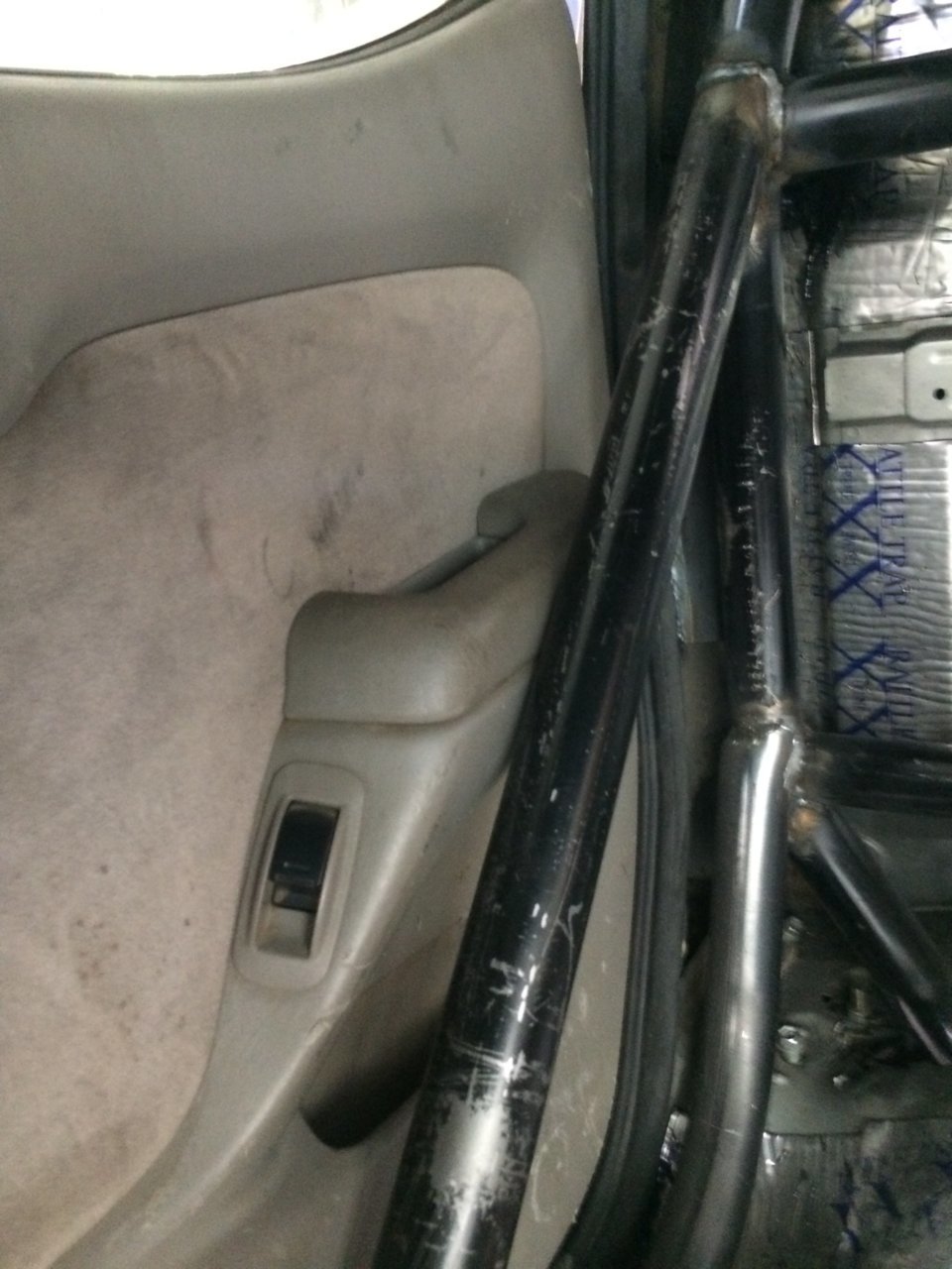

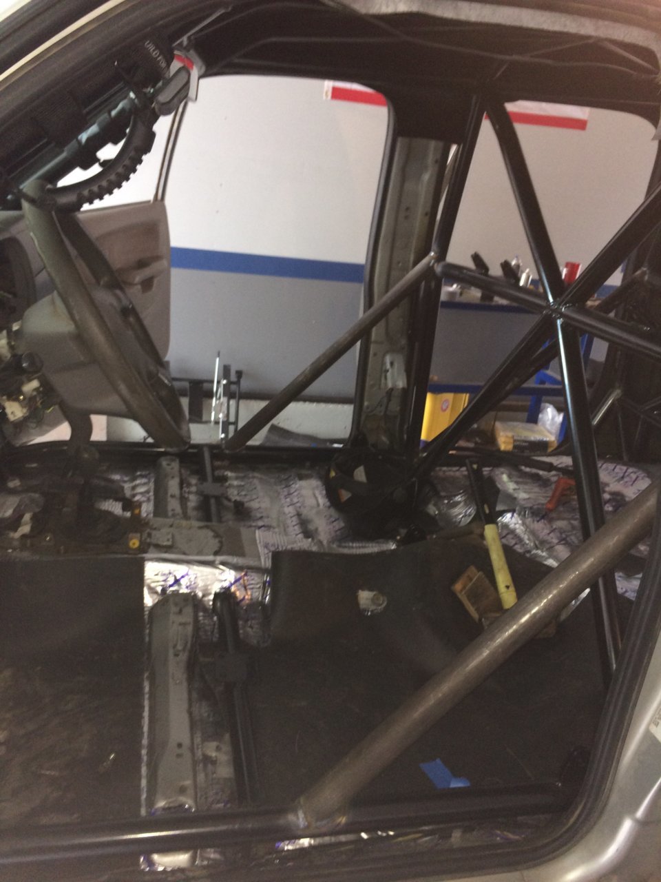

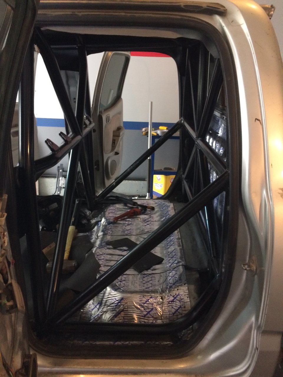

    Finally finished the cab cage. I won’t need to cut the front door panels, just the back ones.

    My fan is hitting the shroud now as well
