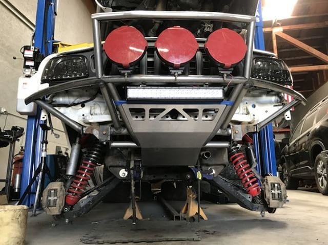

    What material/thickness do you guys recommend for a bed cage for a SUA setup. I wont say it will never be raced but chances are slim. I am also willing to do it right but don't want to spend extra money if I don't have to. Would rather put the money towards shocks.
    I have dies for 1", 1.5", 1.75", and 2" material. From what I have seen 2" is pretty uncommon. 1.5" seems like it is used for the supports and braces but the main tubes supporting the shocks seem to be 1.75".
    Is DOM necessary or can I get away with HREW. I won't be heat treating anything so Chromo is out.
    AssBurns likes this.

    1.75 for everything....and the cost difference between hrew and dom is negligible these days just do dom
    dira1987 likes this.

    Maybe elsewhere but here in Utah it is tough to get DOM from local suppliers. I can usually get 8' sticks from Ruff Stuff shipped cheaper than from the local sources but you are right, even then, I guess it isn't a budget breaker.

    .120 wall I am assuming? or can I go thinner?

    Ah 120 wall is good

    Hrew will work just fine honestly
