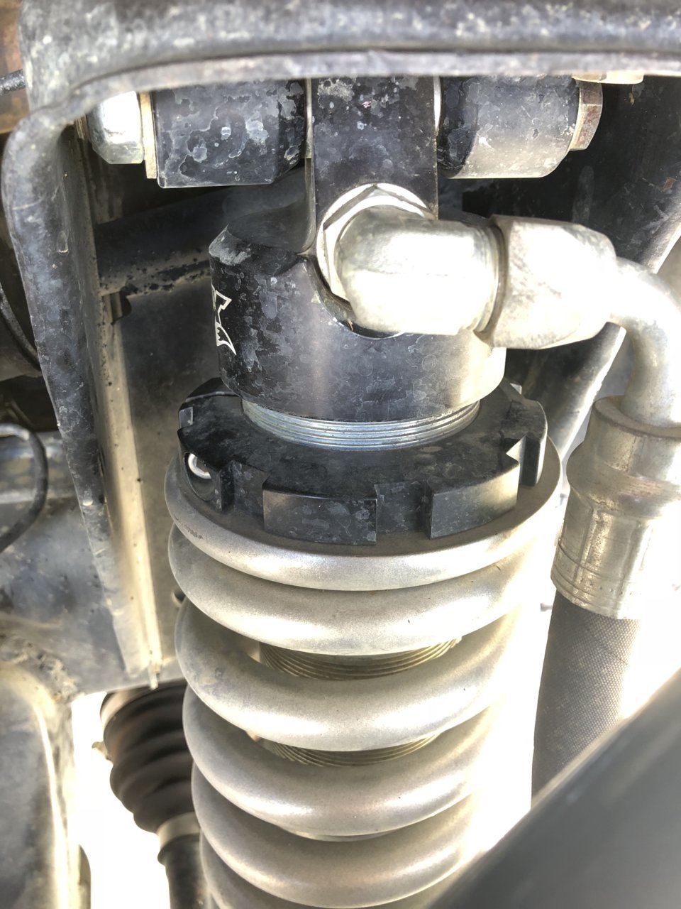

    Will a traditional spinner wrench work on this? If not, what should I get?
    Fox factory series coilovers with #600 spring. Also, how much is too much preload? (Camburg LT with 4x4)

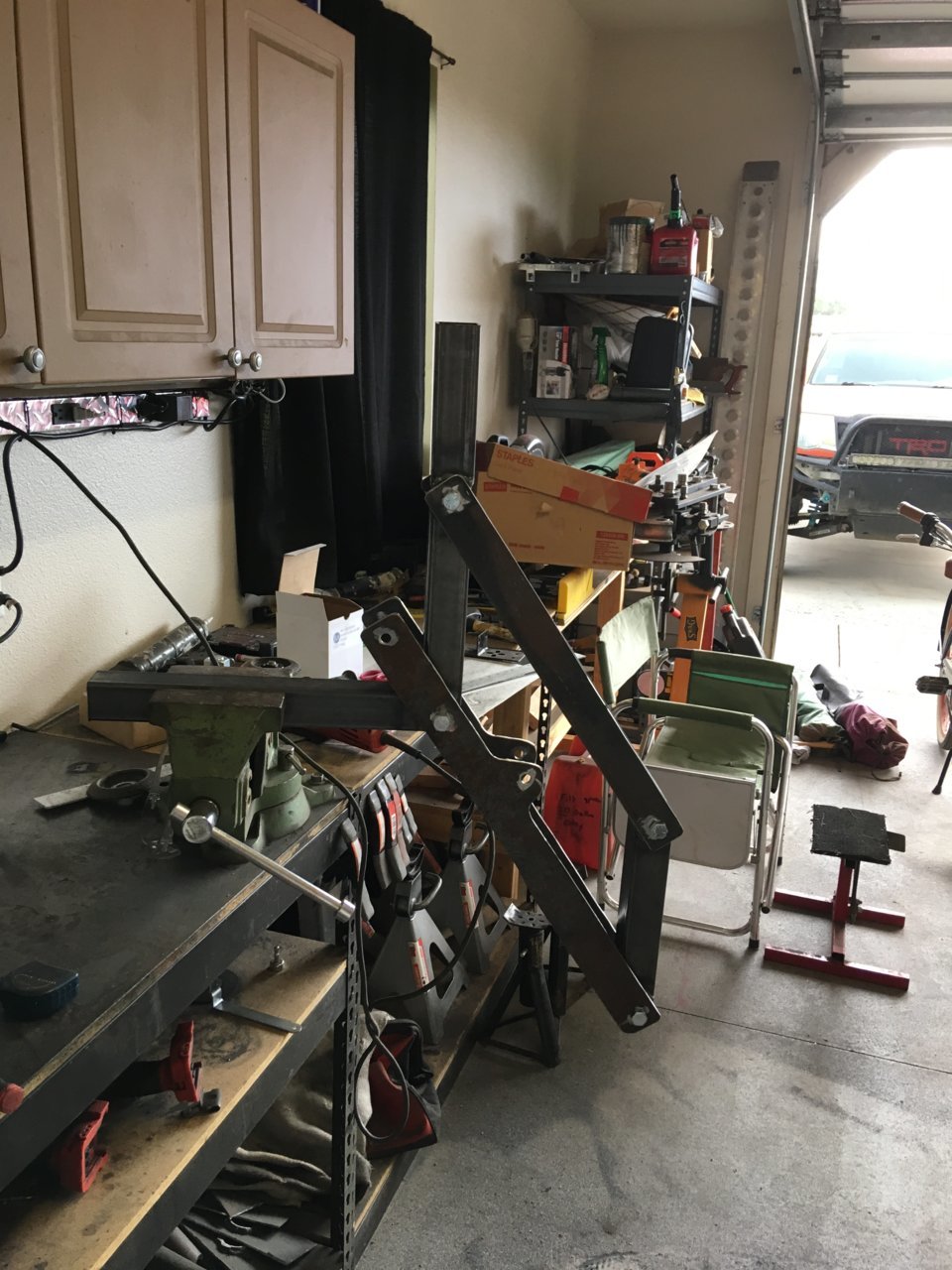

    LT mx hitch mountnin the works. Gonna be strapped somewhere between 30-32" of travel depending on interference issues.

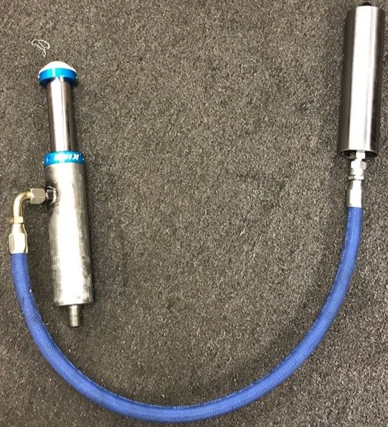

    That moment you think you have all the mods
    And find out you are wrong.
  10. Sep 3, 2018 at 4:44 AM
    Arcticelf
    Arcticelf Well-Known Member
    Jul 18, 2015
    #159735
    7,662
    Gladiator
    I'm trying to imagine how that could be necessary and failing.
    But I'm sure it's fun as hell.

    I'm pretty sure each resi you have adds +10 points of street credit, +5 points reputation, and 2" of extra travel over rough terrain.

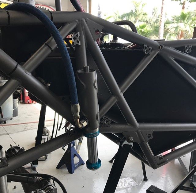

    It's on a few race trucks like Robby Gordon's and this guys who did the one in the pic - but yes you never know when they will show up on a street queen to keep the rear end from jostling the grey poupon in the arb fridge.

    Actually, if you have an rtt and skids you really do want a resi for your bumps because you have more weight in the rear. It’ll help negate the weight of extra accessories such as trasharoo, shovel, fridge, etc. I’m working on a patch for the guys with hydro bump resis, send me proof of purchase and I’ll grt one out to ya.

    For the same reason one puts remote resi's on any other shock?

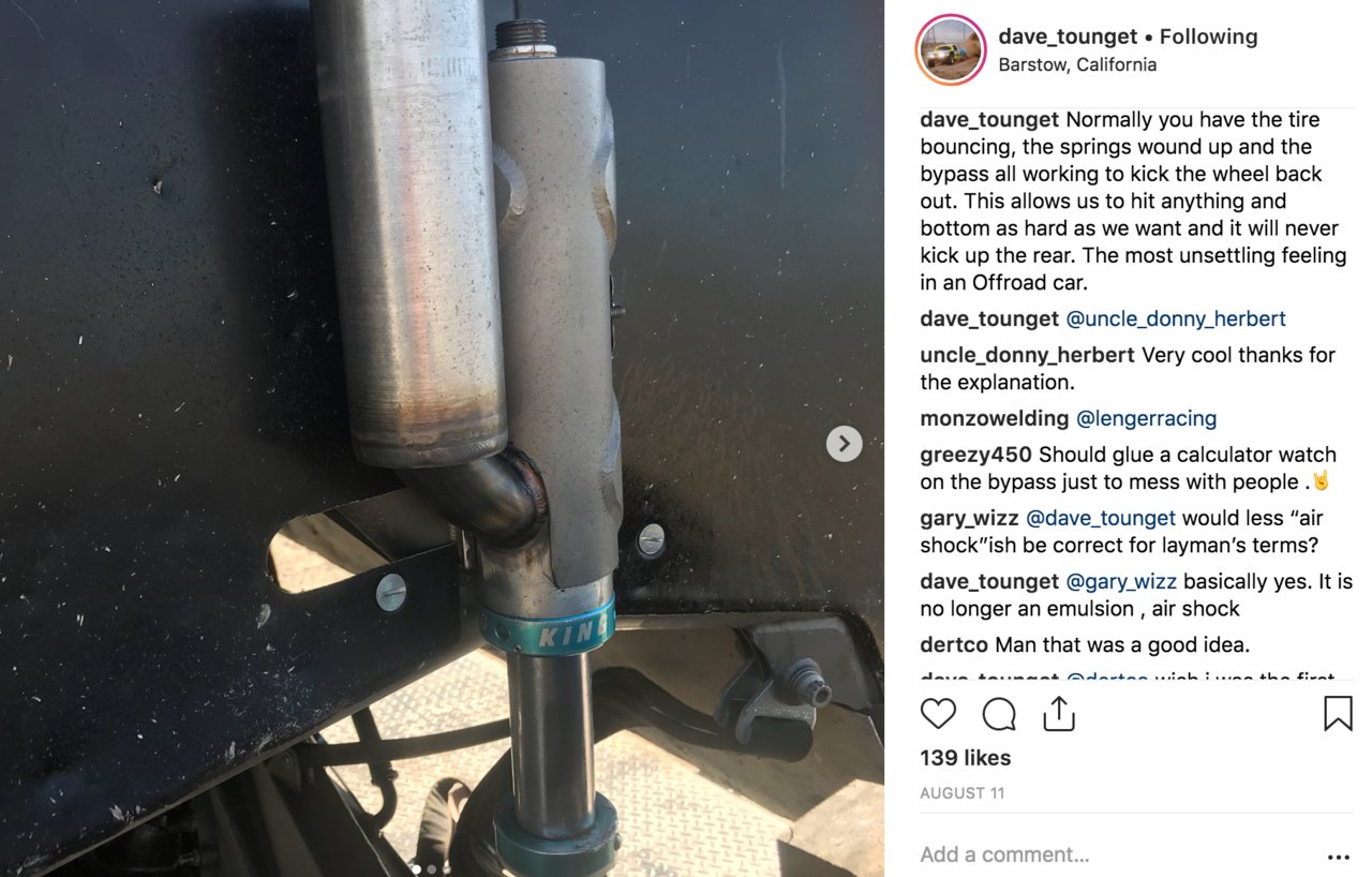

    I guess it's to cut down on the rear end kicking up.

    I don't see how the added reservoir would prevent the rear from kicking up when bottomed out. The reservoir just adds extra oil.

    Because it's below the valve stack on the piston, so the gas pressure isn't kicking the shaft back out as hard.
