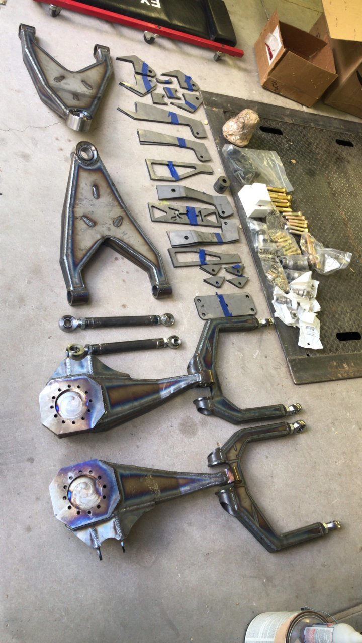

    0908181351_HDR.jpg Drove 3 hours to pick these up before work today. The guy I got them from is from LSK.
    Anyone have coil springs they want to get rid of? Looking for 500 and 600 spring rates
    dillonk1602 and MadTaco461 like this.
