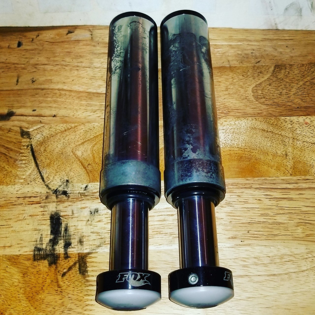

    For sale 2.0 2.5" I've had these for about a year seen the desert about 8 times $385 OBO

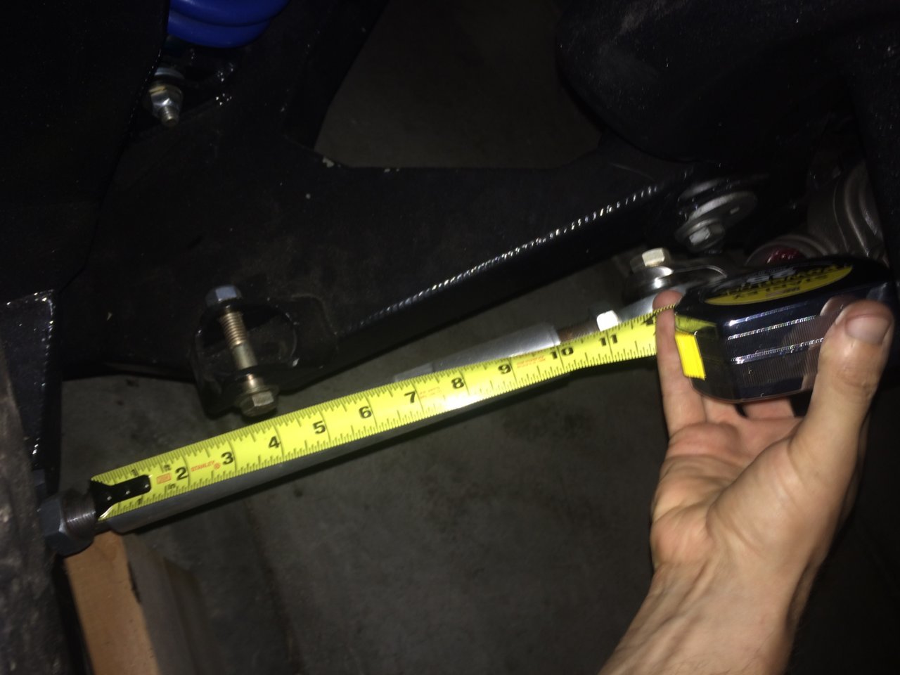

    My tie rods were 10" - I wonder if they're supposed to be shorter because I don't have the lift spindles, but I'll email them.

    look how much thread is showing on the heim, that isnt ideal. i would email them with the measurements and get there opinion

    Thanks! I wasn't sure if that was because the 600 # springs I have on there were making me sit high. I emailed them.

    tie rods shouldn't look like that regardless of position in the travel. if that was the case the bumpsteer would be completely unacceptable as that would be over an inch toe out per side at droop
