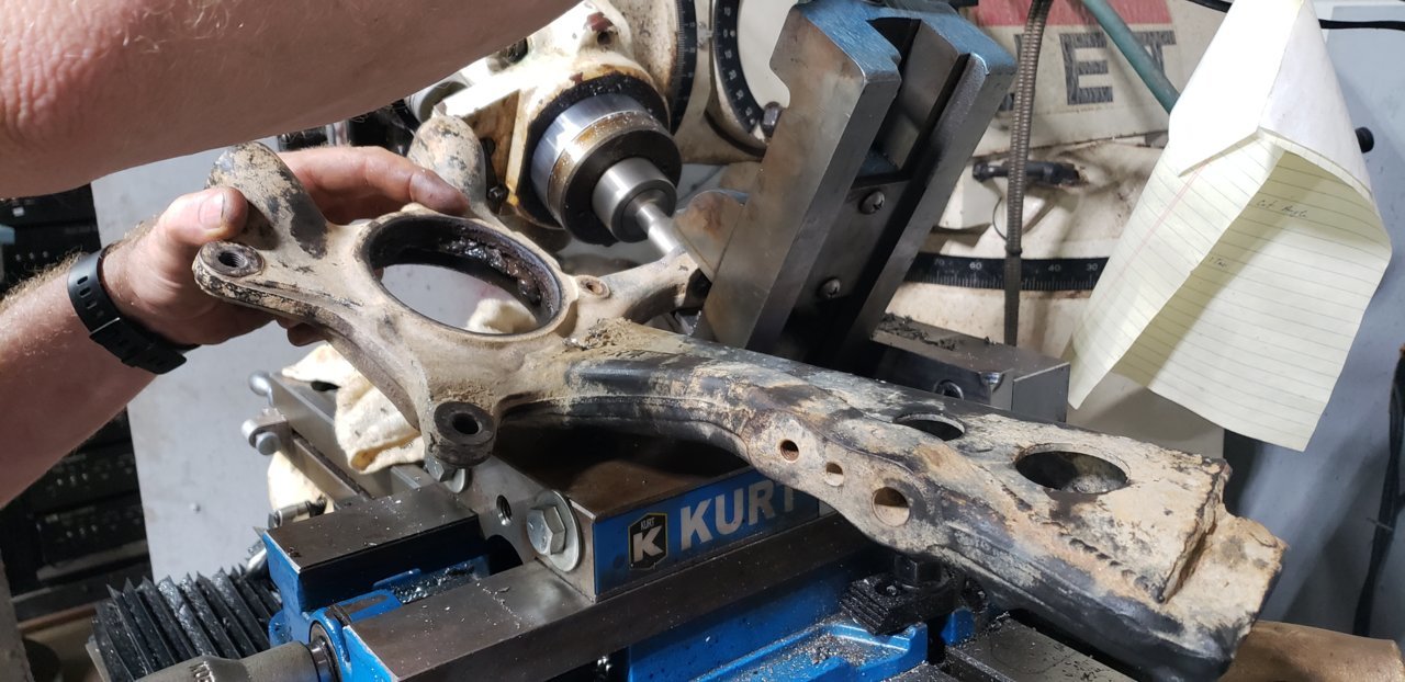

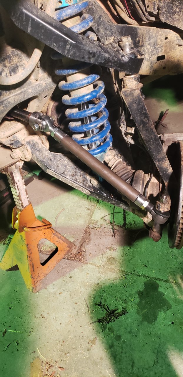

    Looking for thoughts on this. Feel free to tell me if it's dumb, weird, smart, whatever haha. But I am tired of breaking inner tie rods while wheeling (more rock climbing and trail riding than the go fast stuff). So I figured I would borrow the idea of heim steering but use a fj80 tie rod end. My theory is it will still have a weak point for failure if I get bound up to much, be easy for maintenence, and it is something autopart stores will have if I ever need one in a hurry.
    I did have to drill my spindle out and make a bushing to match the new taper but I'm willing to try it. Thanks for your inputs and hoping I thought of everything but you guys are a lot smarter than me haha

    looks good !!

    looks good
    are you running limit straps?

    Yes, hidden behind the spindle haha

    Emf rod ends has a 3/4 straight rod end you can use instead, but I like having parts I can get at auto stores.

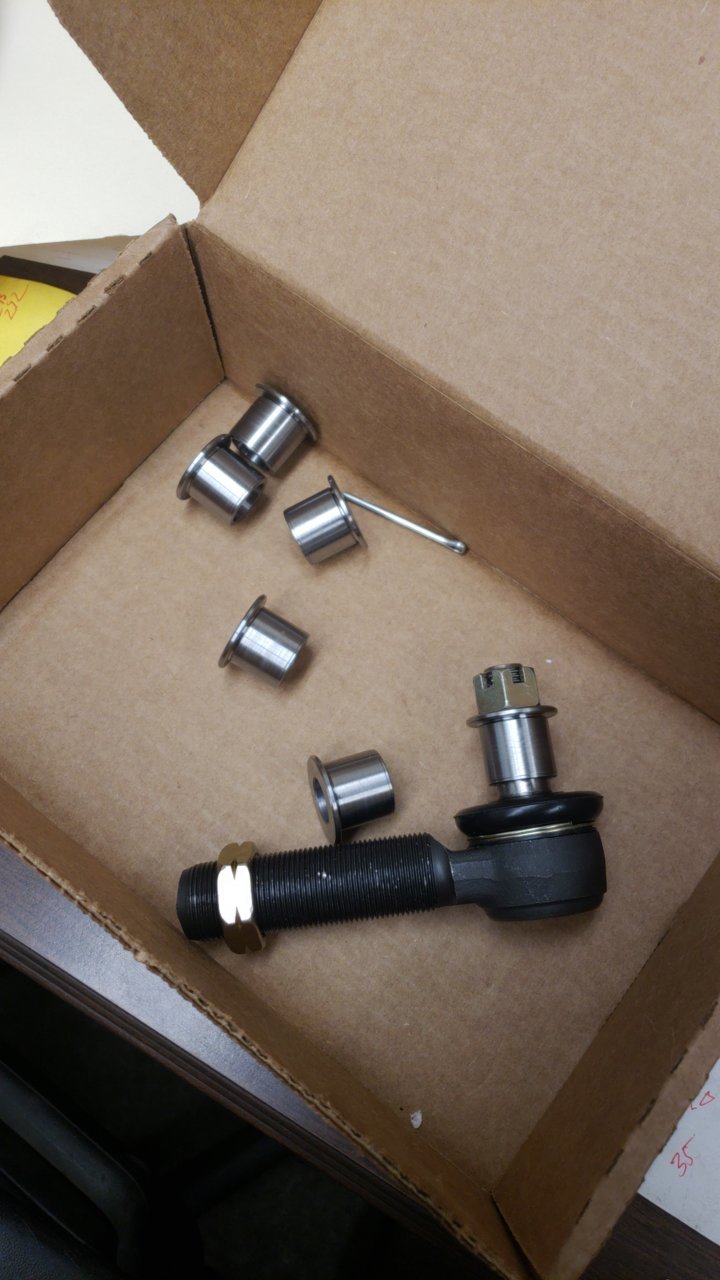

    I agree, plus keeping a weaker link in the mix. Where'd you get the inner heim adapter? My outer rod ends are starting to wear out so I should probably do this upgrade instead of just swapping them out

    Camburg makes them and I got them through poly performance.

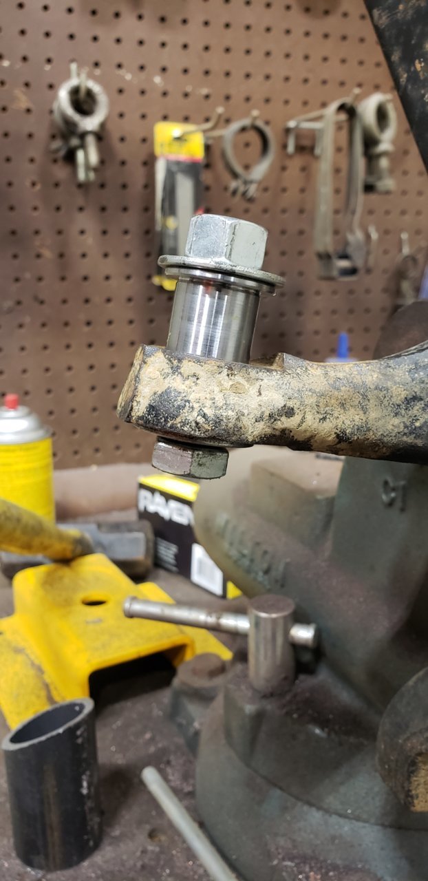

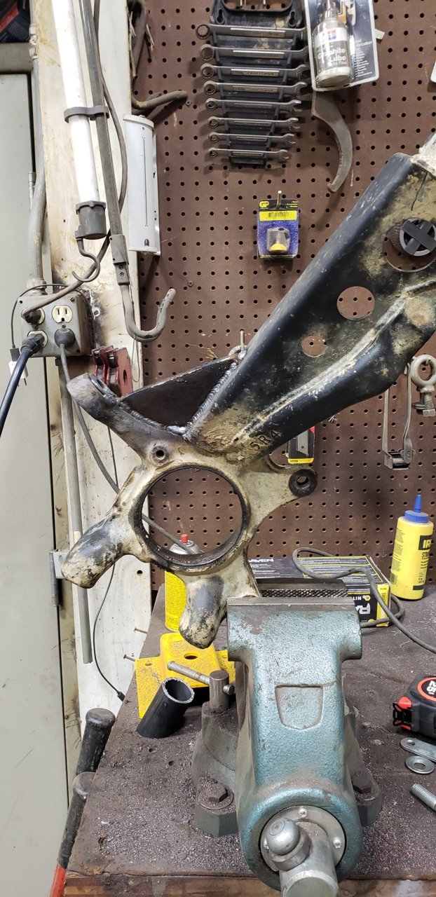

    20180911_202656.jpg my dad and I milled out the spindle to .875 then I had a machine shop make a bushing.
    Then I welded it in place and added another gusset to the spindle. 20180913_201712.jpg
    Everything but the bushing and tube can be bought from polyperformance
