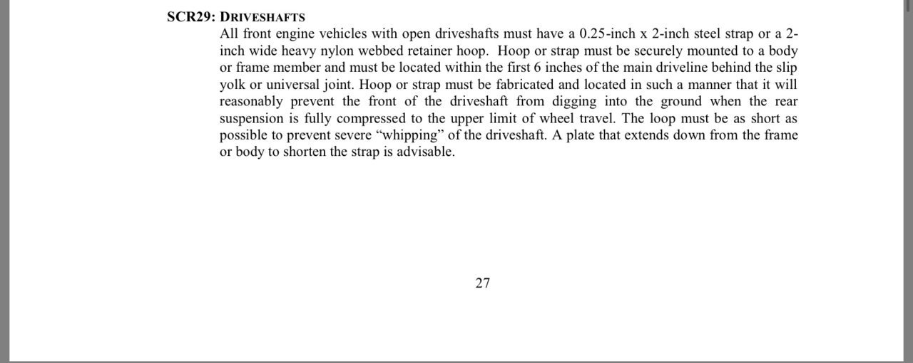

    All racing organizations require the use of a drive line strap.

    Unless things have changed in the past 2 years that’s not correct. We never ran one on the 6100 and never had an issue through tech
    Edit: looks like you are correct now sir. PG 27 of the BITD rule book
    Just a normal plain Jane limit strap

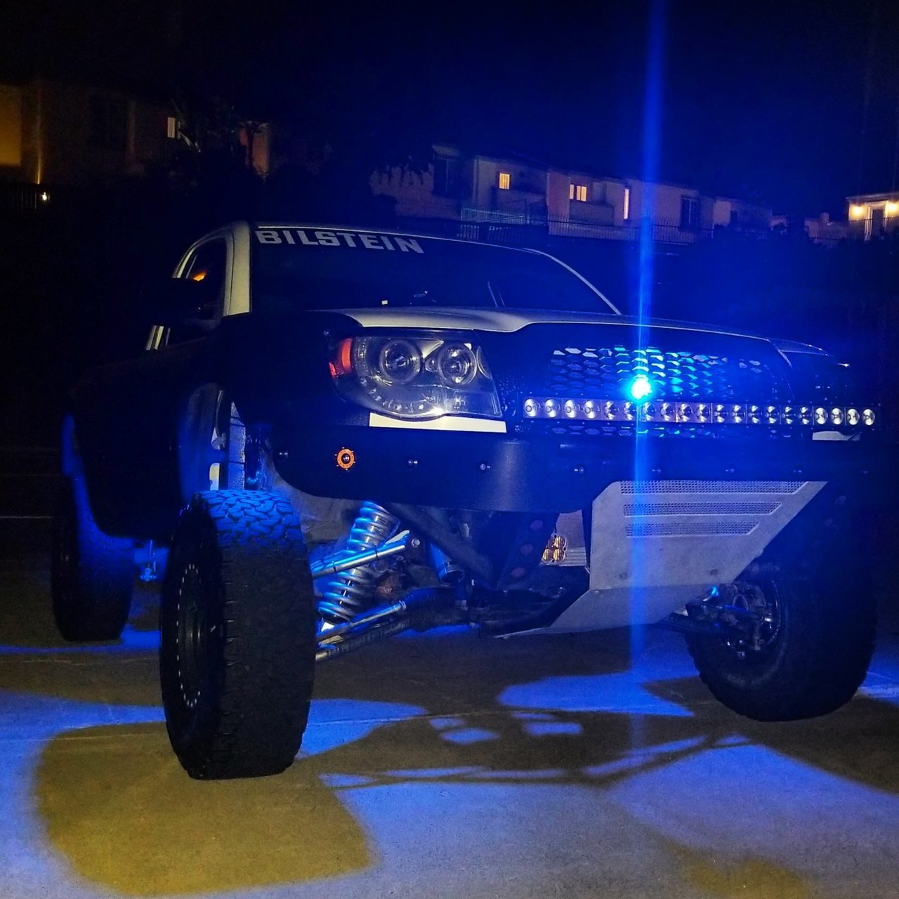

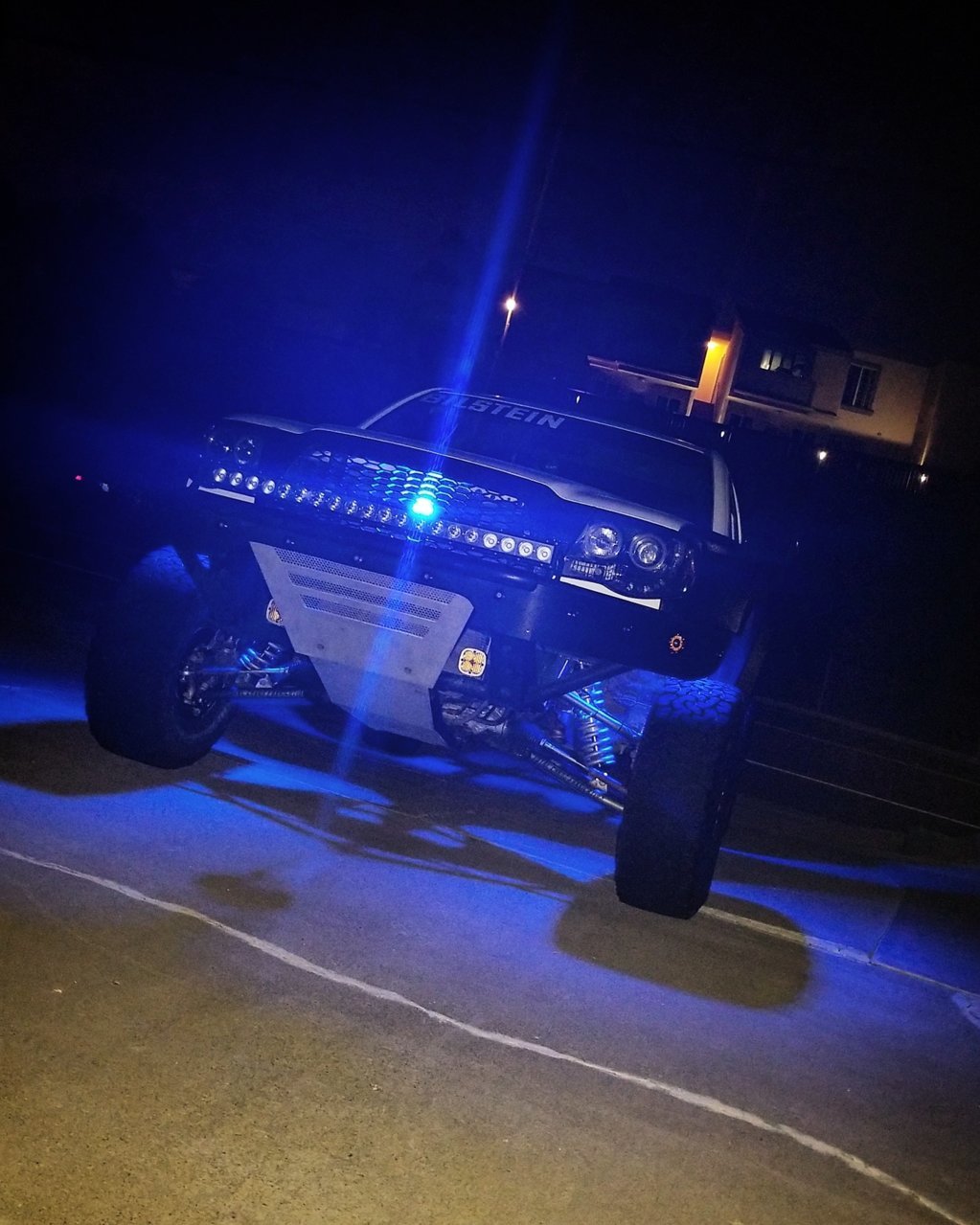

    came out sick KC-lights @jeff b
    just need to finishes up the wiring for the amber lights and under hood :cookiemonster:
