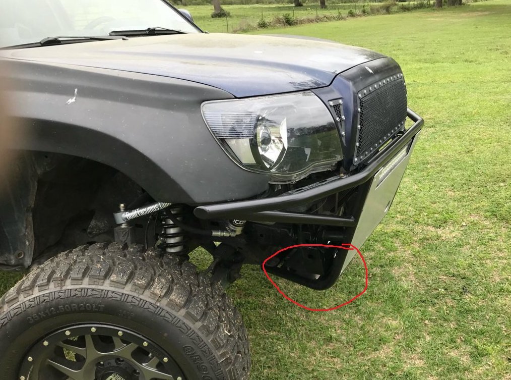

    That’s approach angle... those tires will hit first. Your snow plow will hit before a tire ever comes close...

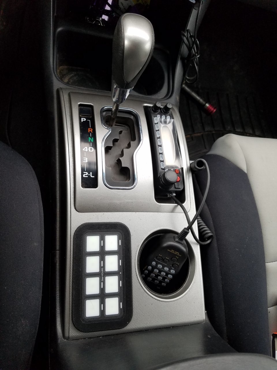

    You have a hanger for the mic, right? Don't want to be a Richard Cranium (It's a Weatherman thing).

    that looks slick. that radio fits in nicely.

    Are you genuinely illiterate or do you have trouble comprehending written English? You need decent approach angle because you APPROACH embankments... keyword, APPROACH-verb-
    1.
    come near or nearer to (someone or something) in distance
    I have hit embankments straight on multiple times. Obviously it depends on the angle and size of the embankments, but since my bumper is closer to 90 degrees, I can hit obstacles that are closer to 90 degrees without hitting my bumper

    Here's the deal, his"approach" angle isn't bad. If he chopped the lower cross member his ground clearance would be better and give him a better skid angle. @mthouse01 think about it like this. You are blasting through the desert and round a blind corner at speed, and shit, there's a rock taller than your cross member, dead center in your tracks, narrower than your track width. It's going to hit your skid first! Your near vertical skid plate angle hitting it will try to stop the truck, while something with more angle on it, will try to lift the truck and glide you over the rock. Get it?

    So when I chop my crossmember off, Slim up the front bumper and glide the front end over that rock. Explain how I am going to get my rear axle over that rock? I’d rather mess up a bumper in the middle of nowhere than an axle

    You APPROACH embankments at an angle. Physics 101... I mean if your embankments are curbs then I understand now. But your 2wd so you’ve never done more than that I’m guessing

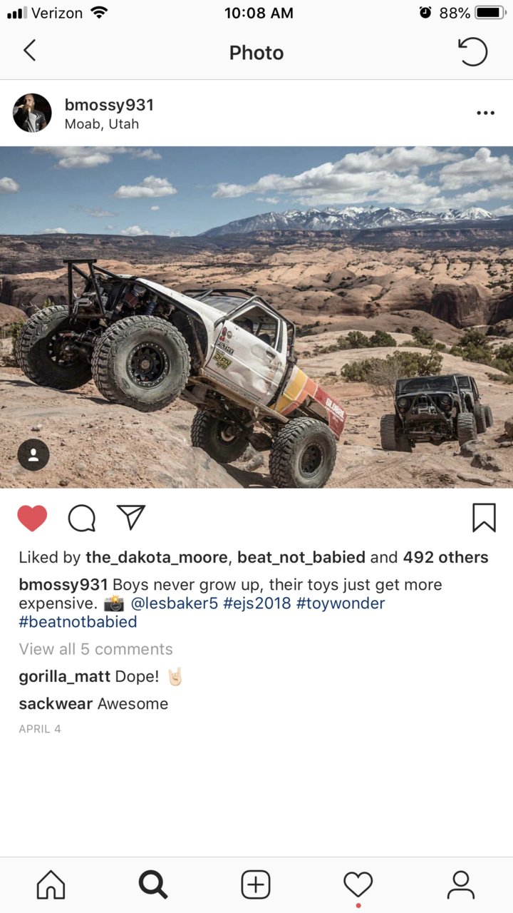

    Angles...

    Yeah, it just wasn't installed for the pic. It hangs off the pax side lip in line with the vol/squelch knobs.

    The Yaesu 7900 has a remote head, so the speaker and radio body are under the seat. Only the face plate is mounted there. Makes for a nifty setup
