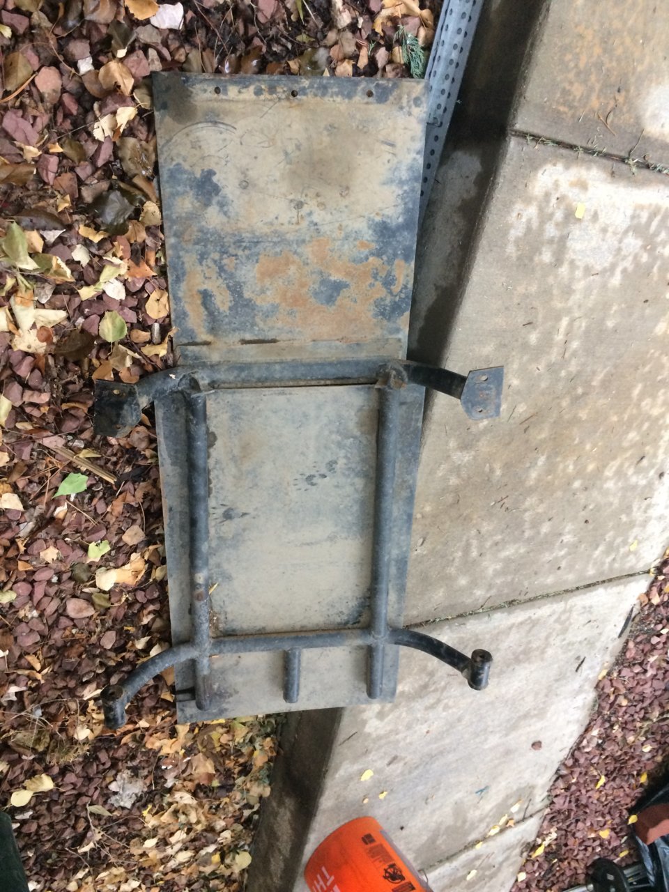

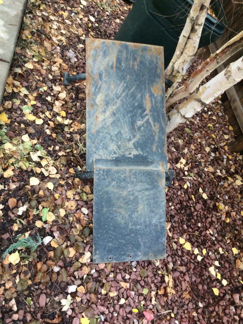

    Are people making their own skids out of 3/16” steel or are you referring to using aluminum plate?
    Seems a bit difficult to work with 3/16” steel.

    Mine are 3/16" steel. I cut the cross member and welded back in a piece of 2" square to make my skid supports off of. Pics in build thread somewhere

    Mine is 1/4" with tube support and bent to shit. Glad I made it beefy. It can support the whole truck on rocks if need be. But like others, I suggest using square tube. Shape would hold better then my bent round tube. Bent tube likes to bend back out a tad and making lining up bolt holes a bitch.

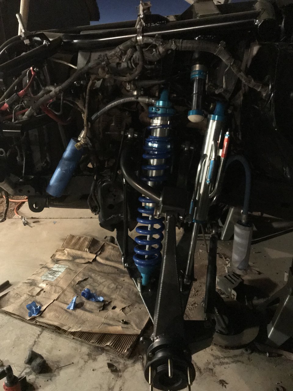

    @Anthony250 took rough measurements to see about making shock hoops today. A ton less stressful working with a knowledgeable guy when it comes to stuff beyond what I've done before - way past it really. Fall back plan is to buy solo's hoops but if we can make some I'll save a bunch of money
    :spending:
    Right now the brake booster interfering with the bypasses seems to be the biggest problem that will have to be worked around...
    Stoked to be moving forward again after a couple months! :bananadance:

    Anthony mentioned we could swap out the bypass rod ends for welded ones - the bypasses are brand new and there's a chance I could get them swapped out for free from King... we'll see, thanks for the pic brother - did he make sheet metal towers for the shocks and coilovers - I'm pretty sure that's what it looks like.
