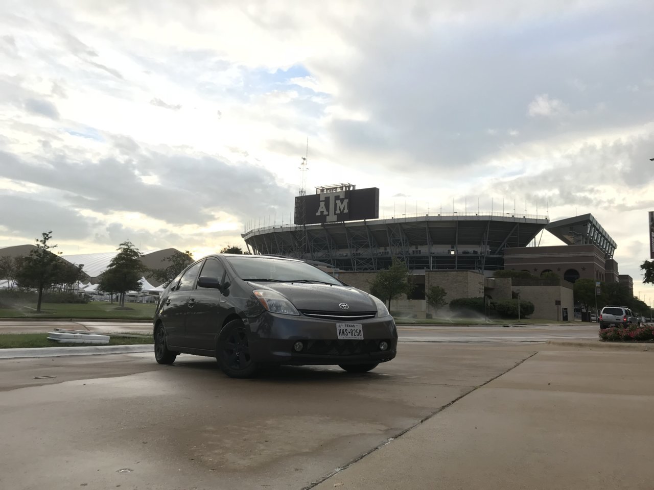

    I was thinking about living dangerously and scooping a Yaris. How much that run?
  14. Oct 12, 2018 at 7:10 AM
    TrapComa
    TrapComa Well-Known Member
    Dec 29, 2013
    #119396
    695
    Mason
    Cedar Park, TX
    07 Indigo Ink LT PreRunner
    Wannabe prerunner, wannabe overlander
    I paid 8000 for it from a carmax in Georgia. I came across it on eBay, I had someone look at it, paid them and paid 400 dollars to have it shipped to Texas. It had 77000 miles, the batteries are still in really good shape and it seems was really well taken care of. My mom has a prius with 200k with nothing besides maintenance. Mine had the brake actuator go out, but was covered by Toyota to a tune of 2200 dollars, and my coolant control valve went out recently that costed 500. I am at 99k, hoping to get over the 100k hump with no more issues.
