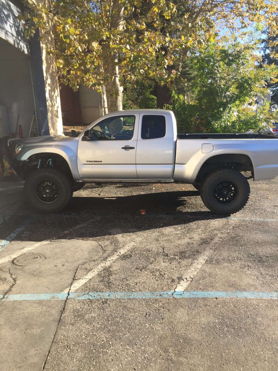

    A2213E08-98F8-48BB-9B04-4D3765F412B6.jpg Bedsides finally on.
    Just gotta start piecing together a LT kit for when I get to my next duty station, haven’t driven the truck in 14 weeks...
