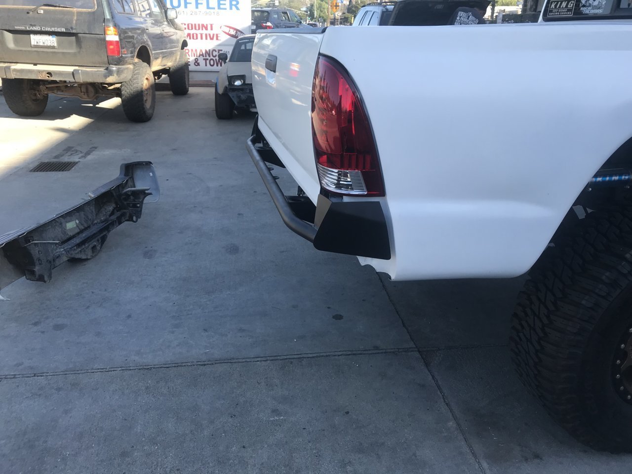

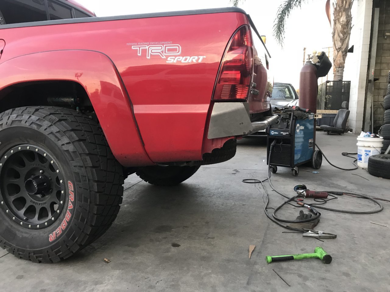

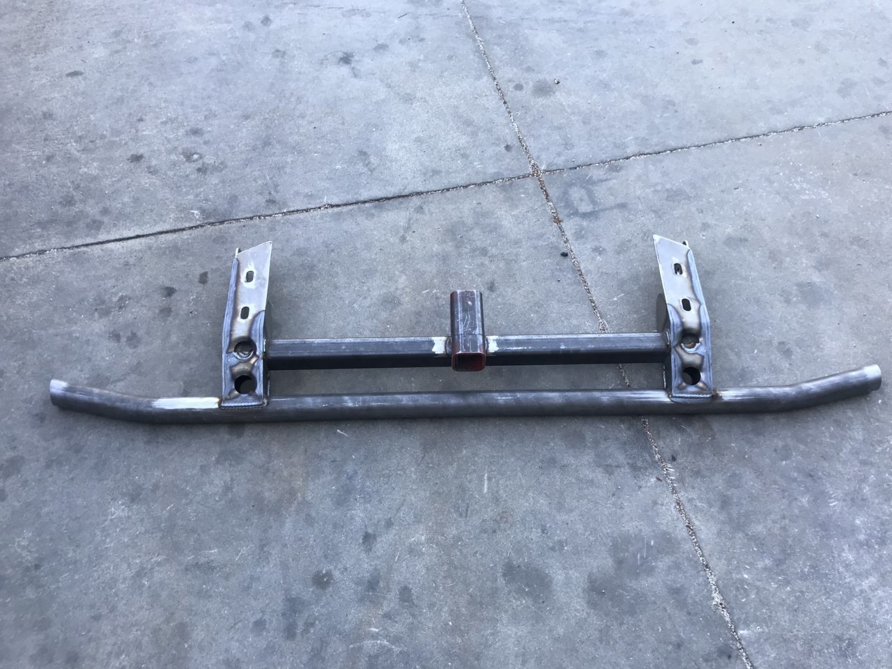

    I don’t think anyone makes a production bolt on rear tube bumper like your talking about. Here’s a few real simple ones I’ve made. I’m sure you could have your fabricator whip something up.

    Yeah. That’s exactly what I want. Looks killer. How much did you charge for that

    I can’t really remember but it wouldn’t be an accurate reflection of what it should cost as I have a really well paying career and no shop overhead so it’s really not a representation of what a real shop would charge, plus I’m in California so labor rates are probably significantly higher.

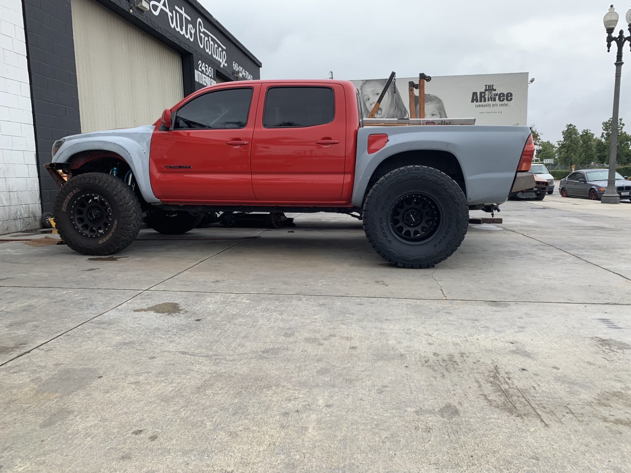

    Something about primer gray on red - I like that truck a lot and the bumper is really sturdy looking. :thumbsup:

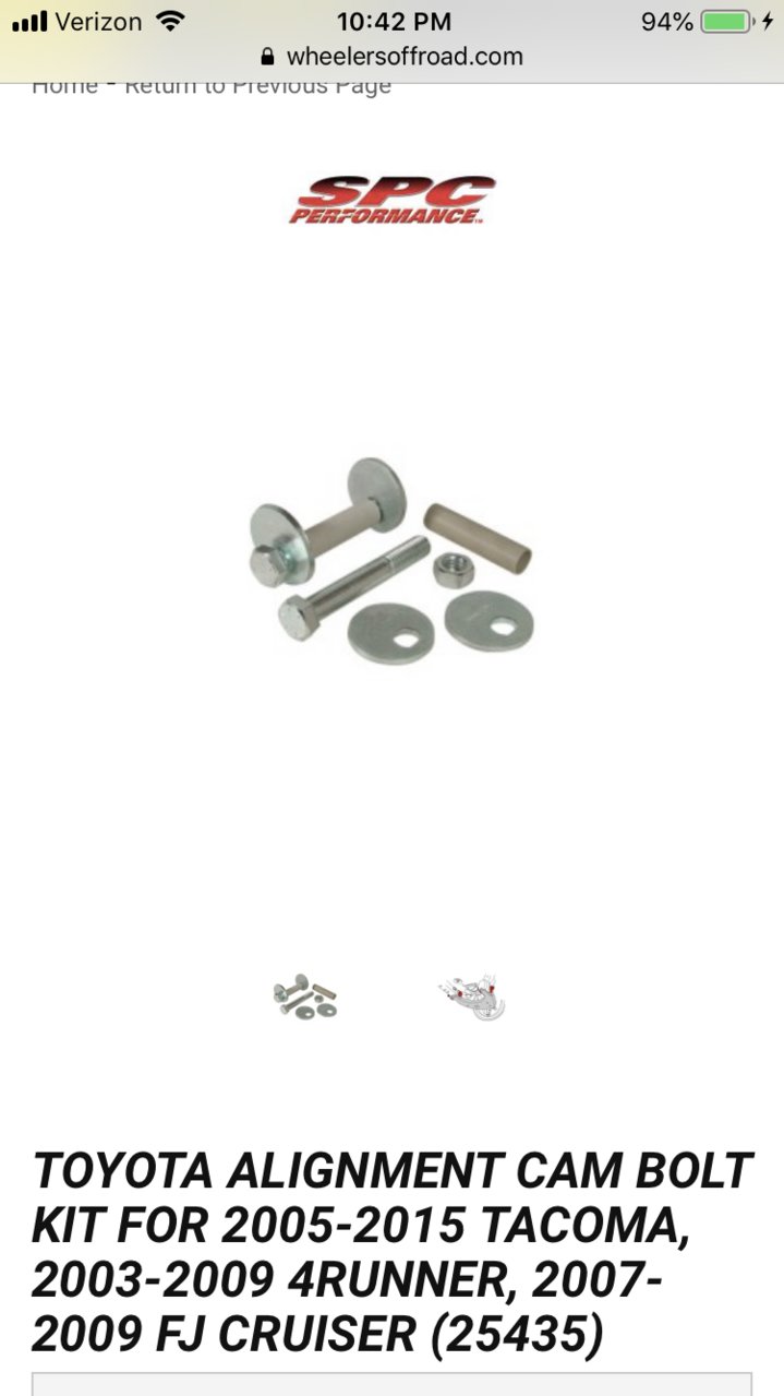

    Has anyone on here used these alignment cams? Any reason to believe they’re better/worse than OEM? I have to order lug nuts from them anyway so I’d like to get it all together to save on shipping.

    Those look way worse than oem. Alignment can’t be adjusted with a wrench like oem

    Didn’t even notice that. Looks like I’m going to OEM. Thanks

    Looks like a keyed bolt design.
    If they are anything like any other aftermarket ones..id go OEM

    You’re probably right, the bolt holes in the cams don’t look perfectly circular.
    The main cam on mine that’s frigged is a front that has ruined threads from bending the alignment tab offroad then moving back and forth on the drive home. I think I’ll be able to just replace the bolt and the threaded cam, and the sleeve and other cam are fine. I put my suspension back together today and sent it home with a big impact. I think when it comes off again it’s not going back on I needed the bay in the shop though

    Not nearly as good as oem. I had a stripped cam bolt and didn't have time for a dealer to order one so I got one at a parts store. Oem is a lot better quality.
