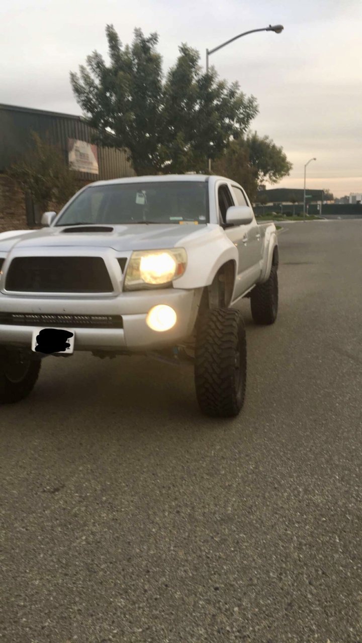

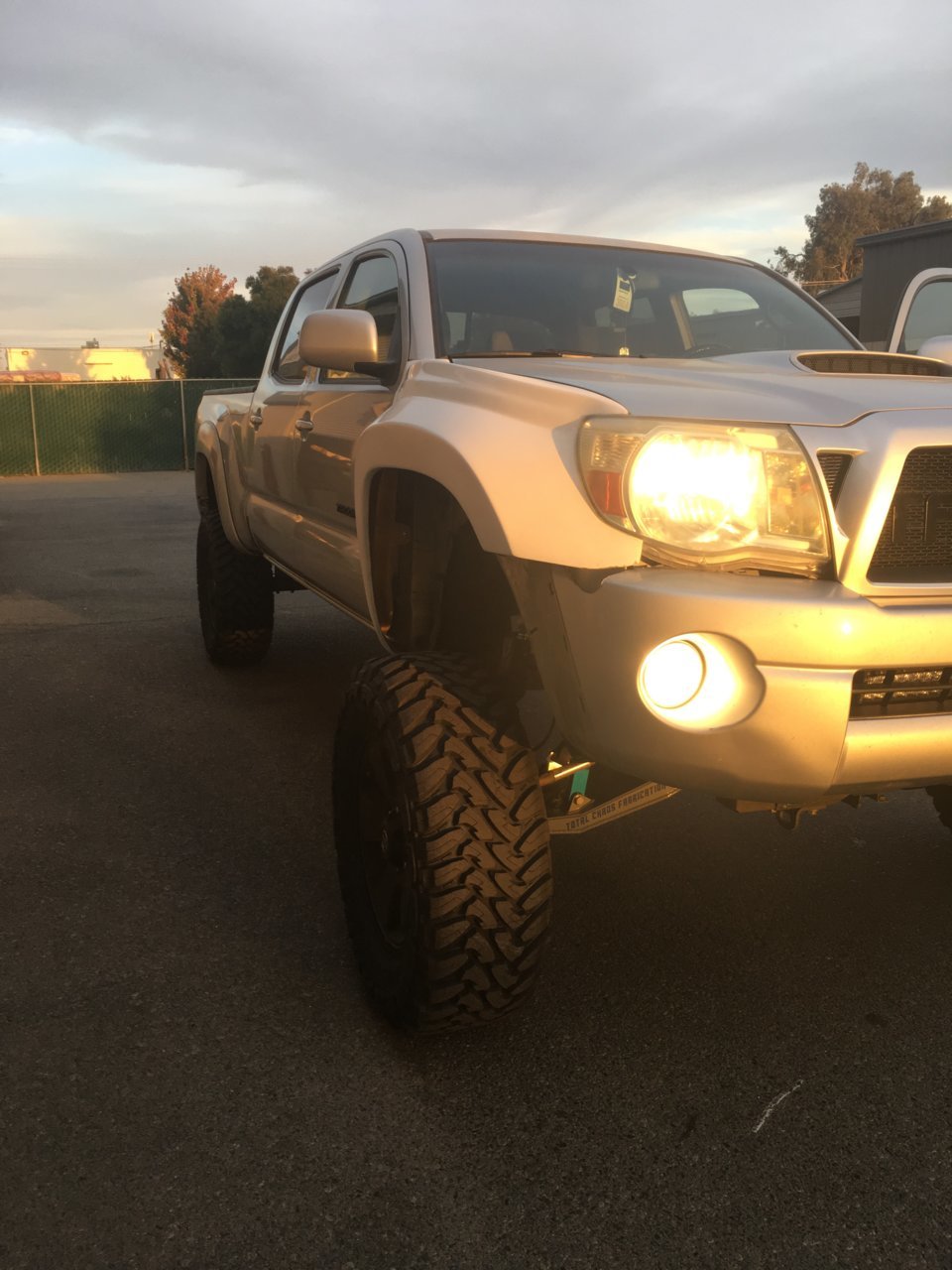

    I need options on a bumper. Any suggestions.

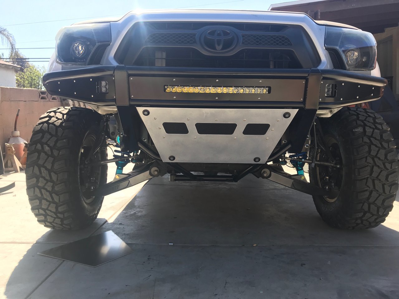

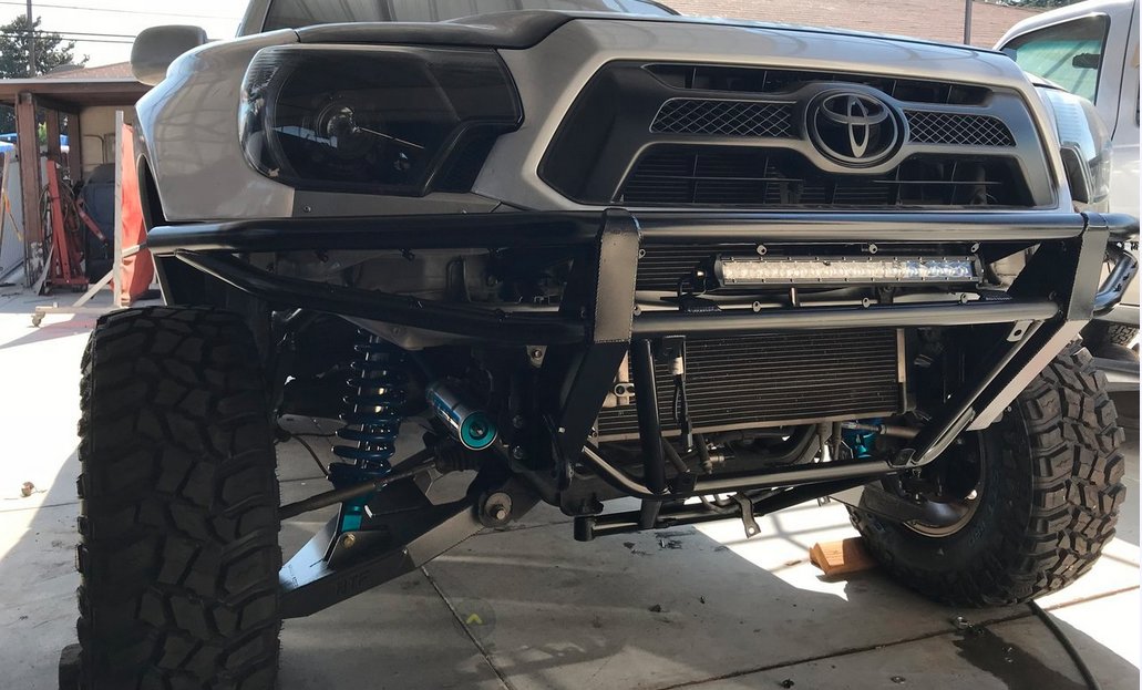

    BTF or DTF but DTF might be done with taking any new orders. Here's one by BTF on @miseenplace's truck. I'm thinking of seeing how much they'd charge for one for my first gen.

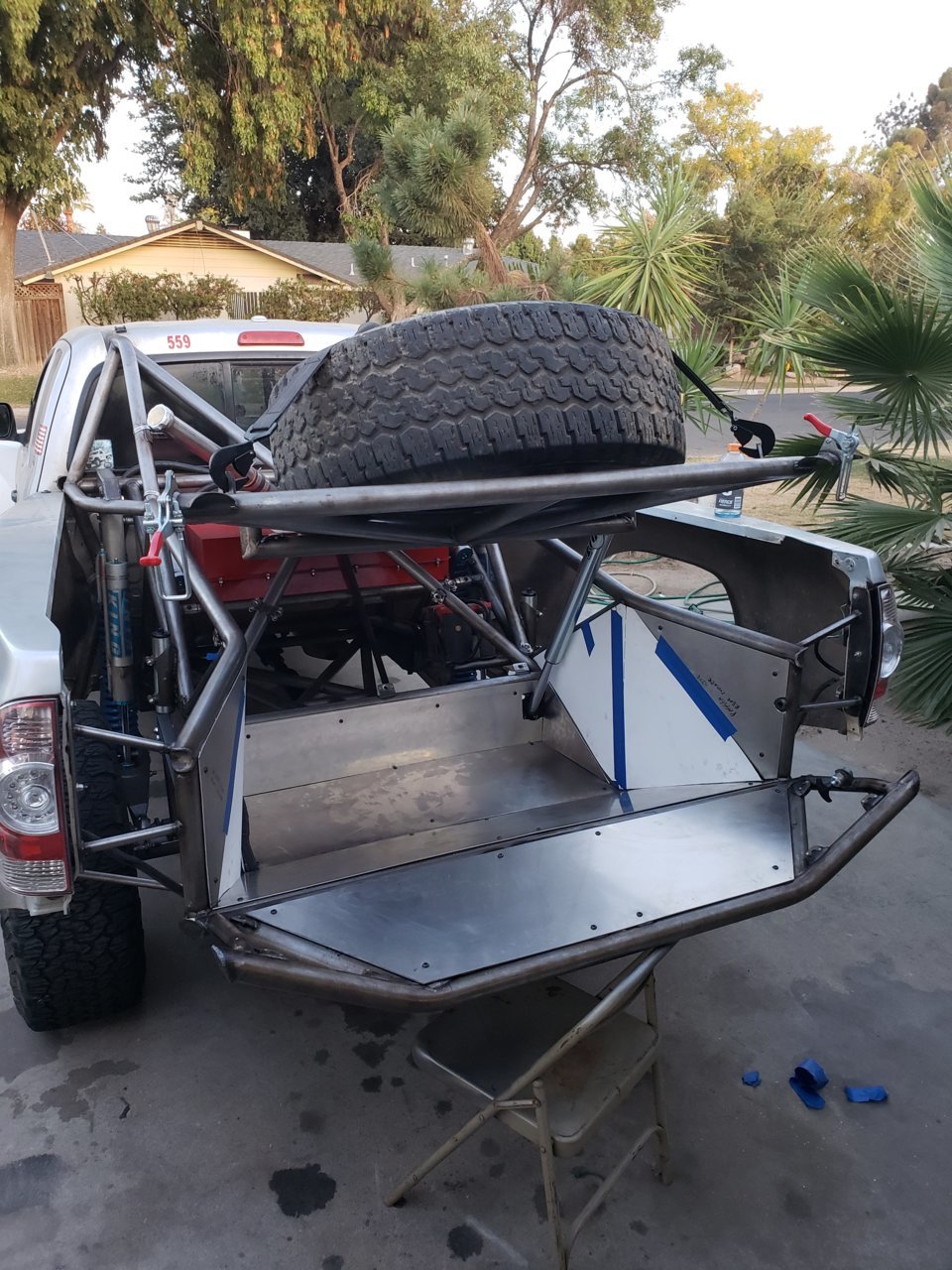

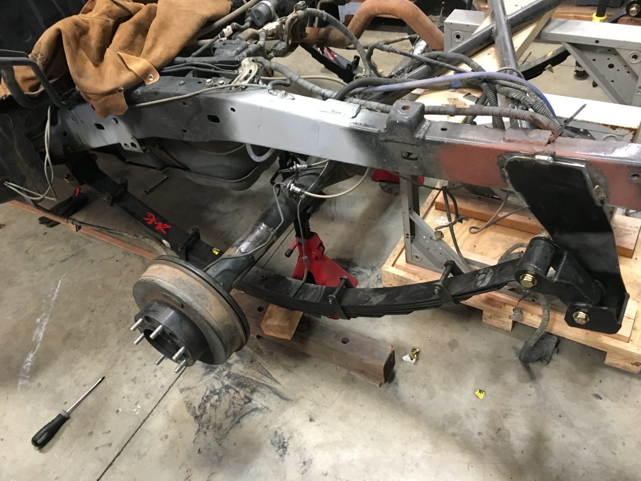

    Hopefully getting this thing finished up today! Only 6 months out of commission post theft took some time to add bumps and reinforce the rear. Can't wait to see how it handles!

    Check uptravel before hitting bumps at ride height. I'm guessing you'll want to shorten those to 2-2.5" to keep from constantly hitting them.

    Do you mean actually shorten the stroke of the bump or raise it's position? I appreciate the feedback!

    Shorten the stroke. Can't be 100% cause you're a 1st gen and I'm 2nd. But you just don't want to be too close to them at ride height.

    I went with 2" rear bumps

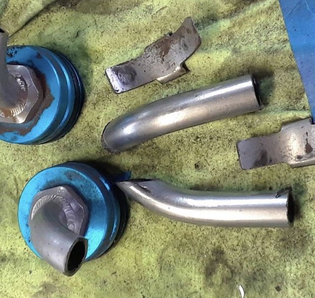

    Movin resis around?
  19. Nov 4, 2018 at 7:15 PM
    DMCtacoma
    DMCtacoma Well-Known Member
    Apr 11, 2014
    #127447
    405
    Brian
    Prescott,Az
    08 caged long travel preruner
    Almost everything
    Going with a bigger resi and port size. Stupid prerunner series 3.0 kings have to small of a port compared to the shaft diameter. Adding a couple more tubes too
