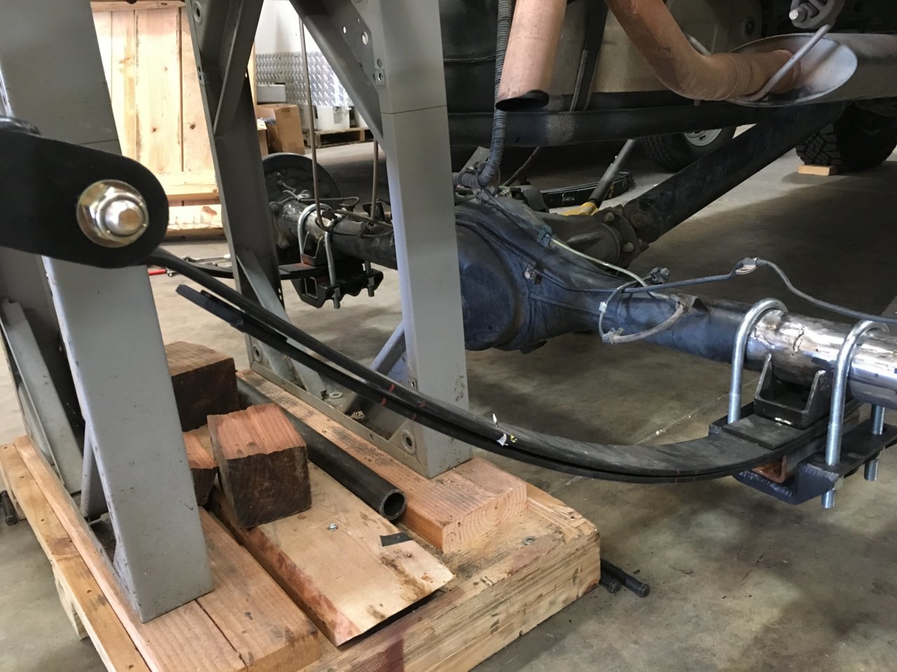

    This is not just a helpfull tip it is an absolute necessity. IE: if your leaf pack is 2” thick and you do not maintain that true stack height you will never get your tabs placed properly. Depending on if you are spring over or spring under you will be off by +/- 2”. For the DIY home installer a simple chunk of wood cut to the same stack height as your leaf pack works too.

    I would agree for spring over as you need to account for the thickness of the pack for bump placement. But it's not necessary to be exact for spring under, just need to do something so you can snug the ubolts

    @Arcticelf, @snowsk8air2, @Hawk373, @Evenflow,
    Thank you for all the helpful info, I appreciate it. I think I can start tackling this today or tomorrow. I’ll hopefully have time to disassemble both packs today.
    One of my concerns was knowing where to mount left and right on the axle. Do I want the shocks toe-ed in or out? Or not?
    At ride height or compressed?
    Again thanks for the help I’ve been and will keep searching for useful info on this.
    I’m SUA with DMZ Kit and cage 16” triples.

    1) assuming the truck has been driven, there are witness marks on the frame from where the bump hit. If it's a clean build you'll have to cycle to properly set the bump location, although the high can be determined with this method
    2) absolutely correct. Doing some quick math, using 10 degree shock angle, and worst case assumption for shock travel (fully drooped, 16" shocks) it's 1/4" off. If you're at ride hight or somewhere in between it will be substantially less.

    Looking from the rear the shocks should be straight up and down.
    Tim has always, and recommended to me that I notch the frame 3/4”, but he also acknowledged that plenty of guys who haven’t notched have had no contact between frame and shock. He does it for piece of mind; I felt the same. Just maintain a minimum of a 1/2” from the frame and you should be ok.
    Seems daunting, but notching was actually one of the easier parts of the install. When you’re cycling the suspension after tacking in your lower mounts: at full compression scribe a line from the back of the shock to the frame; at full droop scribe a line from the front of the shock to the frame. Make approximate 45 degree cuts inward from those lines 3/4” deep (or whatever your preference) and then cut the top and bottom to pop that piece out.

    Since you have the bed off, make sure you account for the bed thickness where the cage bolts through it when setting up your lower shock tabs. Worst case you don't and end up with a little bit bigger safety gap, but just something to think of
