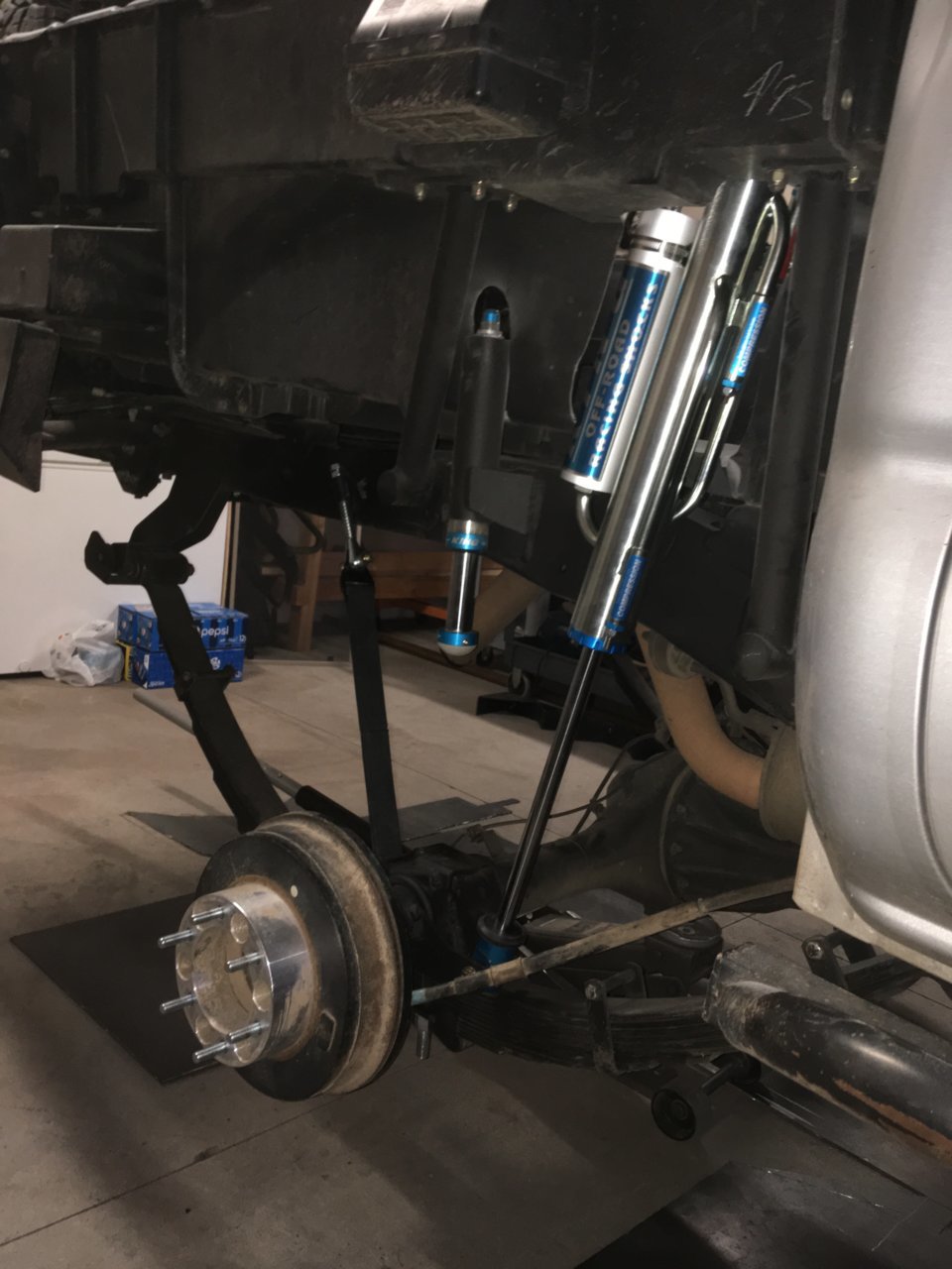

    Not the best close up, but my shock tabs straddle the outer ubolt and the lower rod end sits right above the outside edge of the leaf pack.
    That's at least a starting reference for you to know you're in the ballpark. I can try to get more pics tomorrow if you want

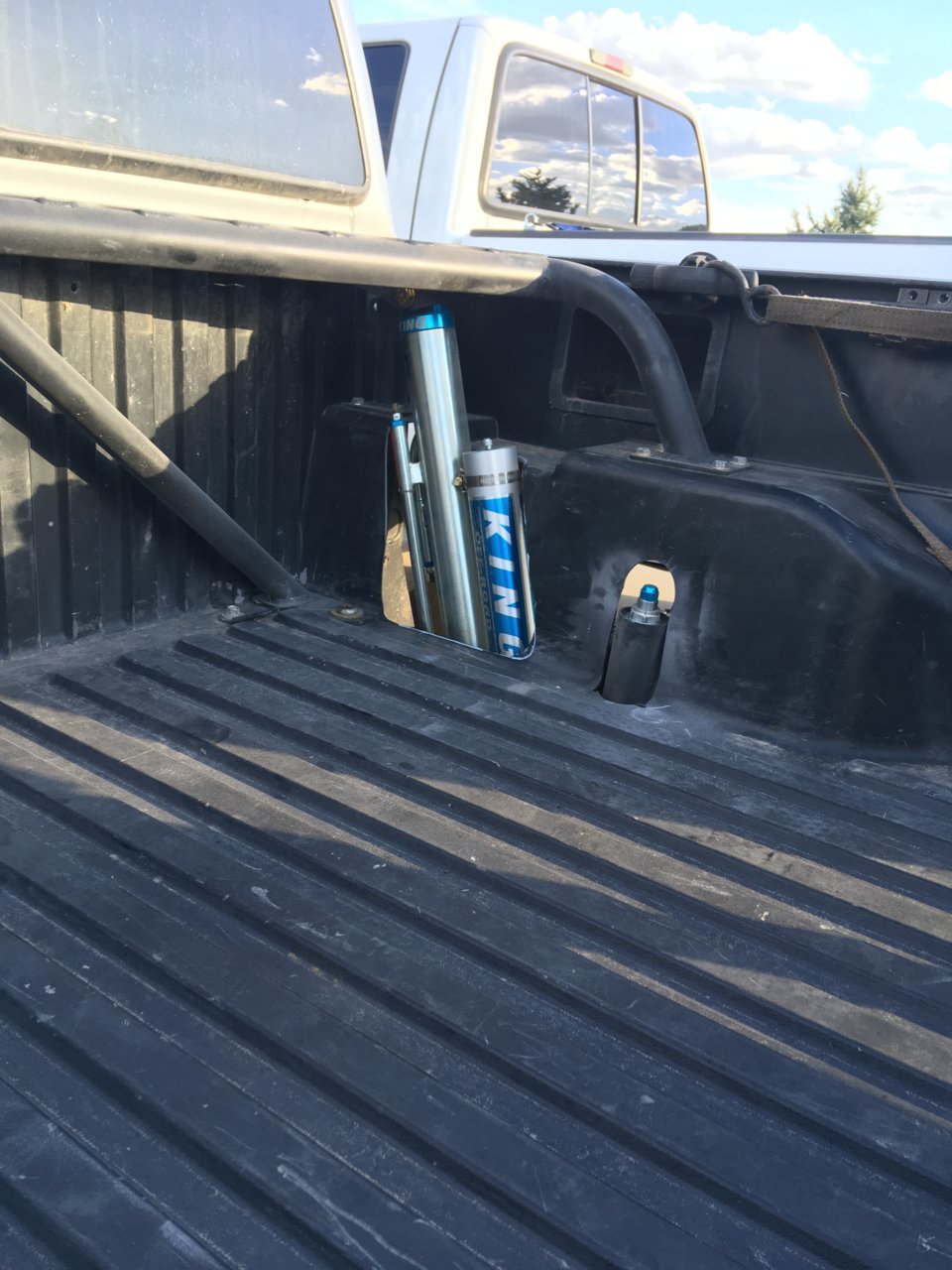

    So I made the mistake of going midtravel when I should have gone long travel in the rear...
    I need some advice on what I should do to get 16" or more of travel. I currently have a TC spring under with shock relocation and it bucks like crazy, I think the 539/540 deavers are just too stiff even with two leafs removed.
    I was thinking of getting the dmz kit but dont know where to get a pre fabbed bed cage or what to do about fabbing my own. (I want to cut the bed as little as possible)
    Also if you want my tc kit its all for sale

    DMZ has a prefabbed bed cage for their kit, and their kit is very good. Minimal bed cutting to get the shocks through. IMG_1364.jpg

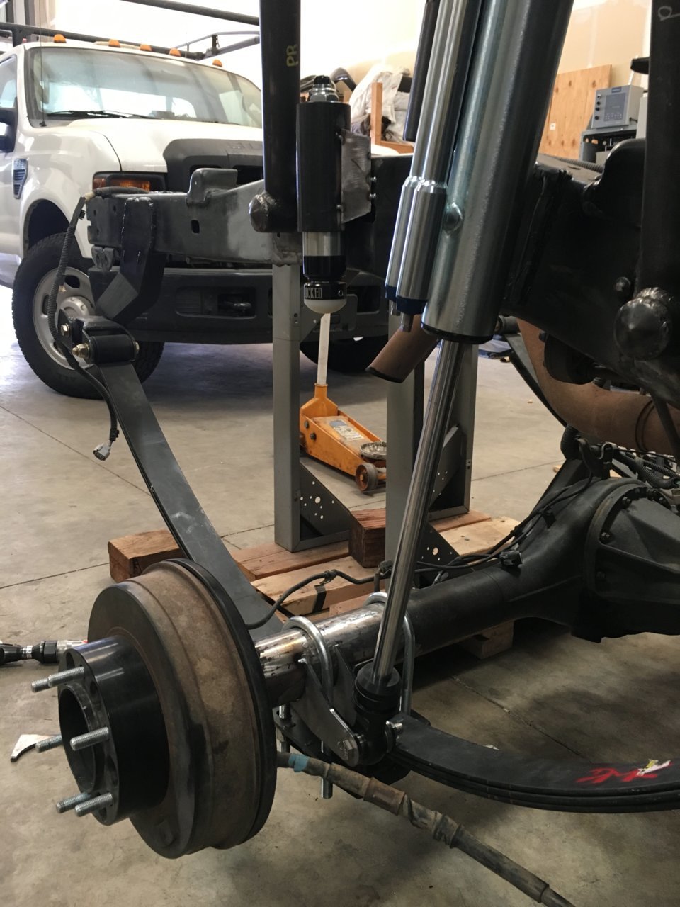

    @Hawk373 So I had a long day yesterday so I turned into a dumbass, I remembered when I got home I had the other side of the axle on a jack stand! I’m sure that’s was messing up my numbers. Also yes I know I burned the perches in backwards, I had no instructions and went of other people’s pics. I talked to Tim about it. I can work around it.
    Thanks for the responses man! The help is appreciated!

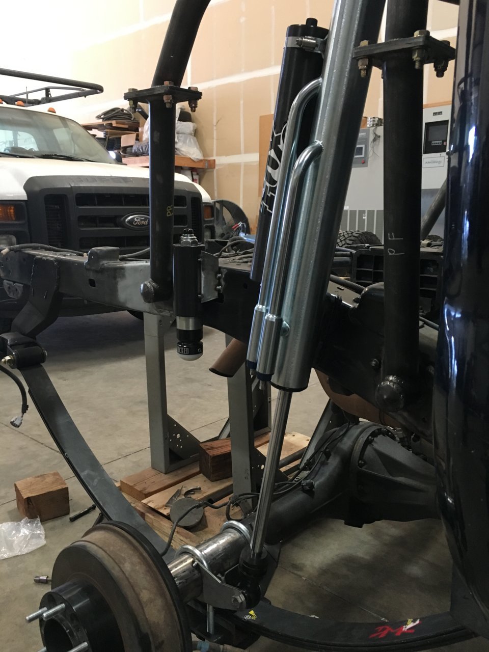

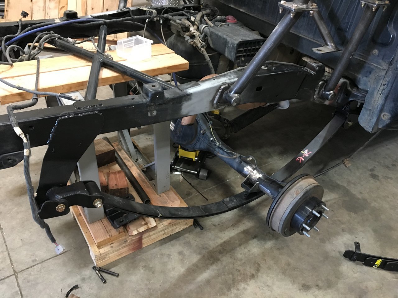

    What do you guys think?F61C2DBC-C1AE-4560-8DBF-12E6470C4E17.jpg BA734537-AB29-4FD3-AB73-B22576DDD84A.jpg 678DB46E-6DA9-4D59-832B-5A40D814D368.jpg

    Lower the shock tabs and raise your bumps to where the axle is almost hitting the frame. Looks like you can get another 2" of uptravel.

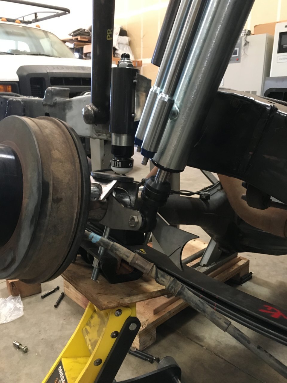

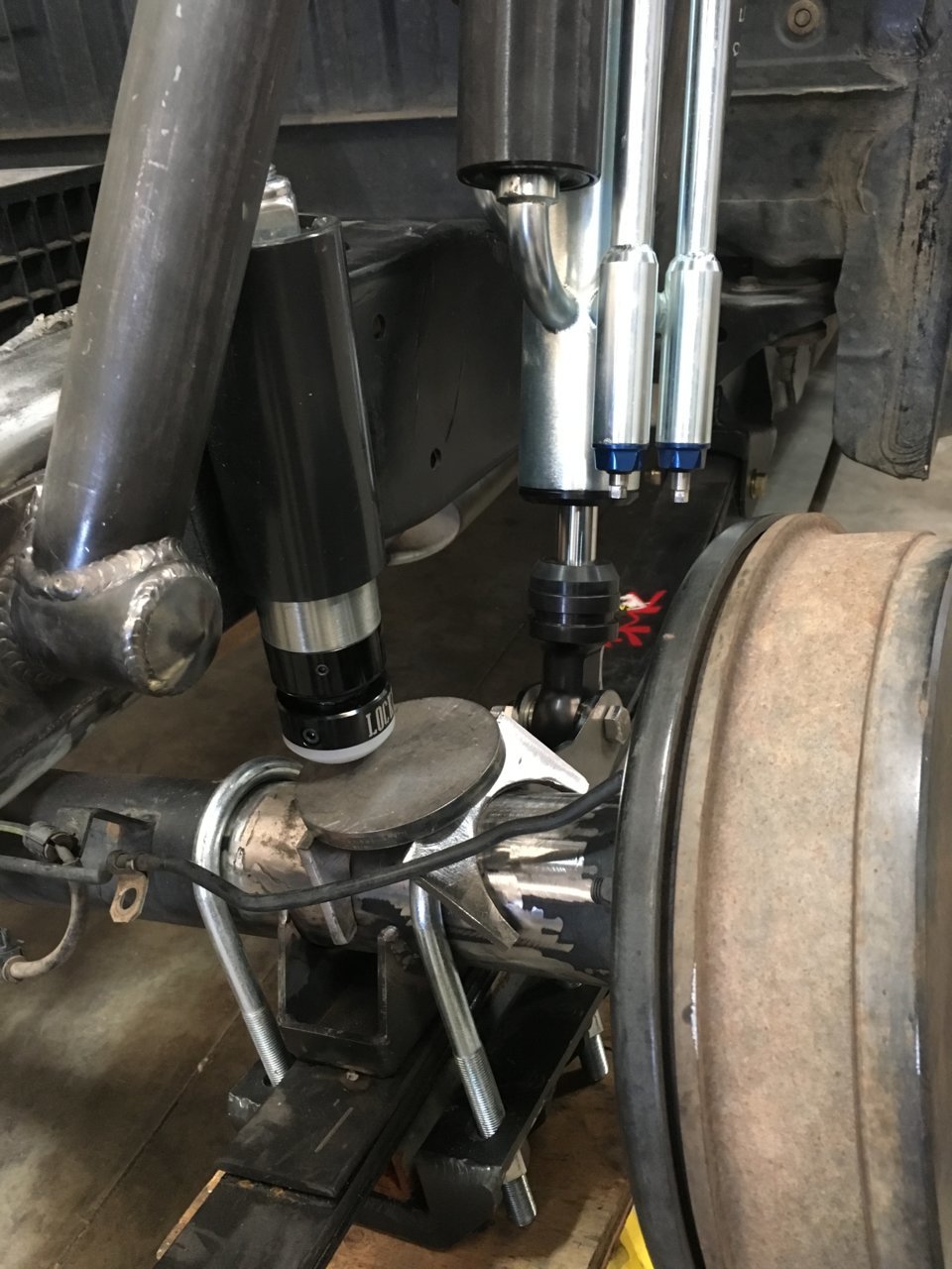

    Moved shit8F27BCB3-FF3B-474A-B421-CC069B24E8ED.jpg D416CC76-4063-4161-8BAD-A25D54AB027A.jpg

    Why are you only lifting one side of the axle to check bump travel? You should be doing both at the same time.

    I cant seem to jack it up high enough when I do both sides at same time
