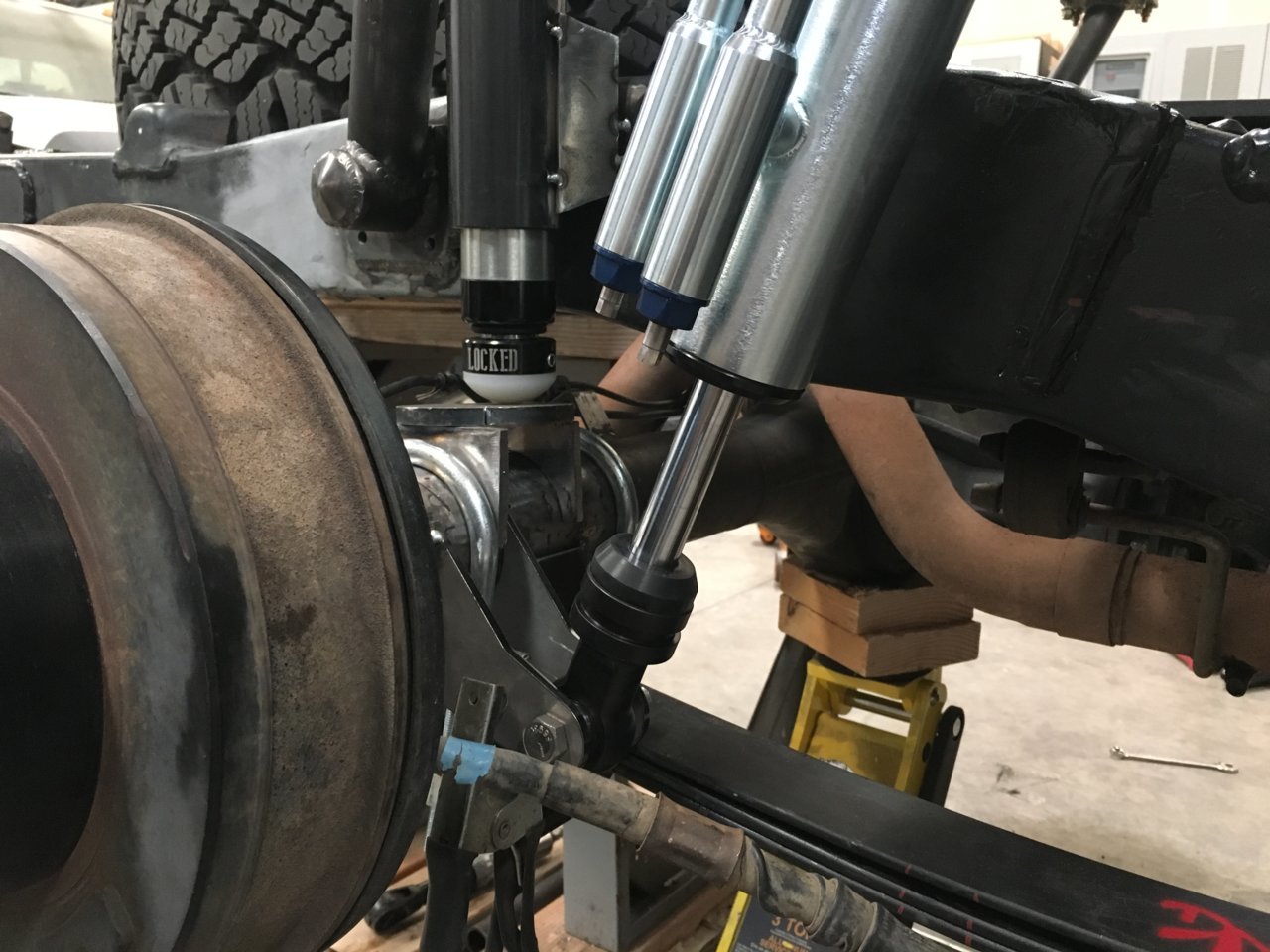

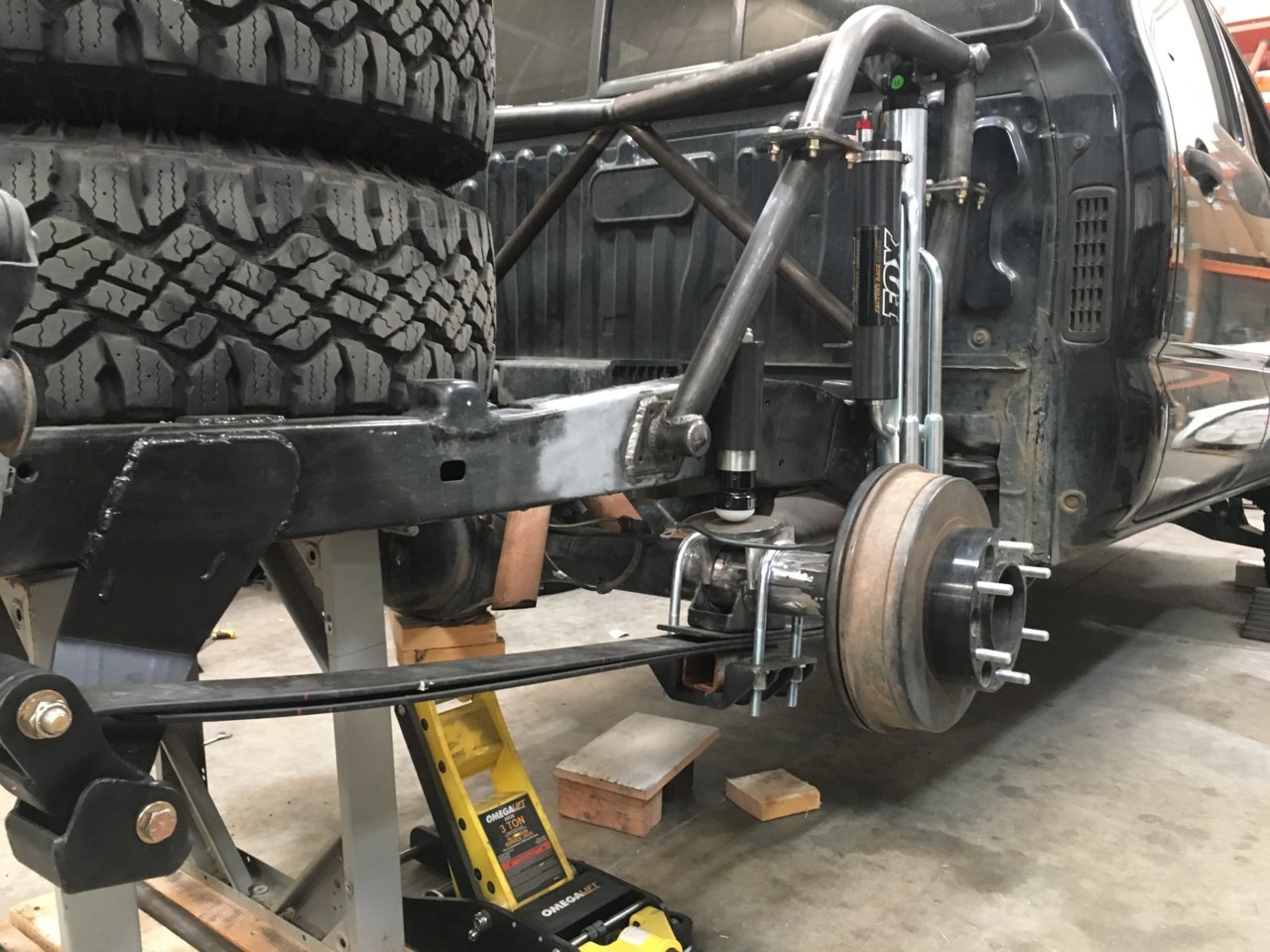

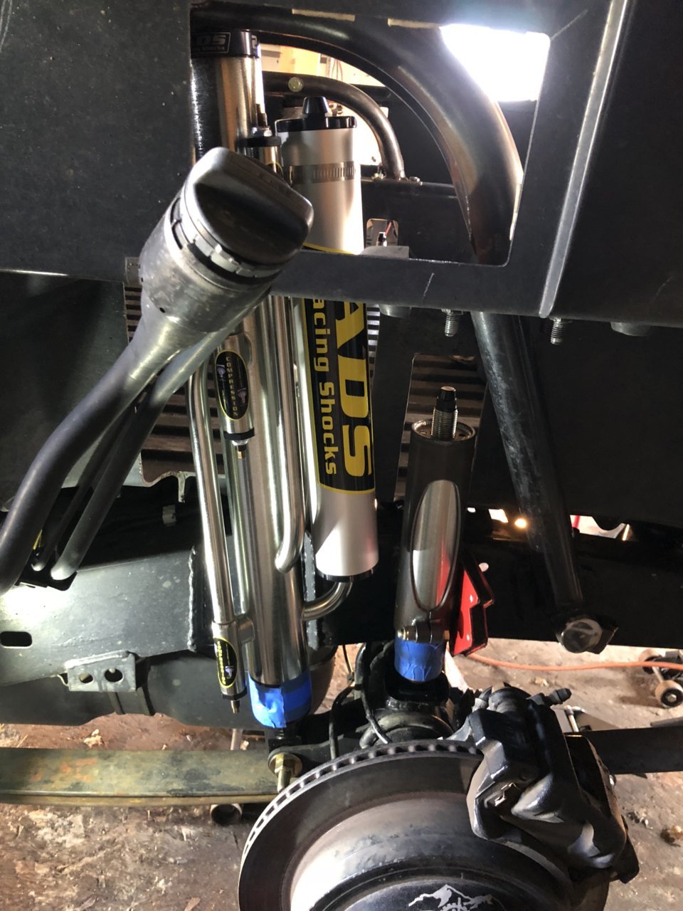

    AD45204B-DDE2-4B2A-87E9-850446C825B8.jpg Look okay?!

    If you aren't bottoming the shock out on full droop id move your lower mounts up a bit. Hell Id move the bumps up an inch at least.

    Get everything you can out of this thing. You can always shorten limit straps/make adjustments, or on the other side raise the strike plate later. Once you fully weld the cans it will be tough to move them and cost you a new set possibly.

    ^This. There's still a lot of usable room on that shaft. If others haven't chimed in already, I think I've seen people bump with under an inch of shaft left in uptravel and as @Hawk373 said you can always raise the strike plates.

    I don’t really know.
    Should I set to use the maximum amount of shaft at full bump? As in the is mostly compressed.
    Then there seems to be a lot of unused shaft at full droop.
    I wasn’t sure so I went in the middle
    I can raise the shock mounts for sure.
    Also I did move the bumps up more
  8. Nov 8, 2018 at 1:21 PM

    I got the axle 1/2” from the frame and set my bumps off of that position. I welded some falsework tabs just to hold them in place, then built the mounting structure around that.

    usually when i setup foxes like that i leave a 1/4” of shaft showing fullbump that rubber bump on the shaft can compress some if worst case it needed to.

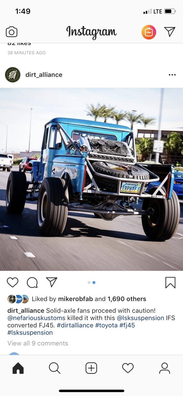

    4DC1E0B5-9C48-451B-ADF5-DC02D385C8E9.jpg Would ya look at all that up travel

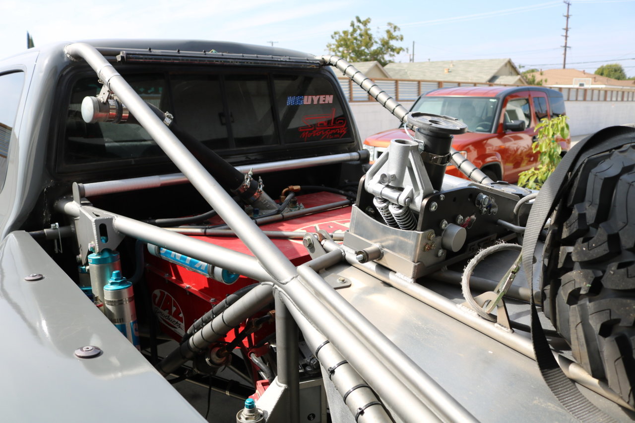

    Why did you have to point that out? Seen this build and didn't notice before. -1 on the cool factor now

    Someone else's build with my touch
    I will be doing it with 2 bikes.trucks doesn't have a hitch unfortunately but figured putting one like that would make the truck to long.(once I put something similar)
    I want to put like a removable bar above the fuel cell and remove the front wheels( wife's bike is a 80 and I'll have a 110 just to cruise around) and attach a mount like a roof rack for a car idea something like this idea
    Works in my head just will have to see if I can make it happen haha

    Typical sema build. Not a fan on how wide front end is either, still kinda cool

    I was hoping the body would be left patina'd

    Push that thing up so your axle is bout to hit the frame, I think I put my axle at a 1/4” away from the frame at full bump and had 1/4”of shock shaft showing

    that truck is actually on an tundra frame i think. they used their tundra race kit in the front.
