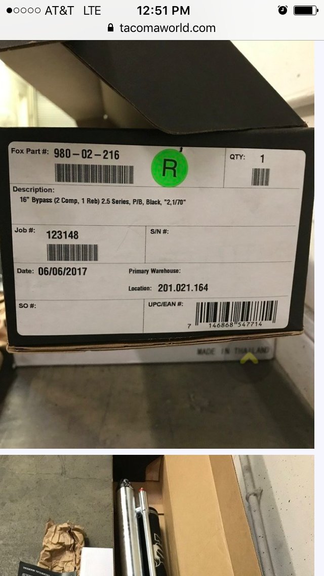

    What valving is in them?

    Don't think that says anything about valving so I have no idea what that means. Rebound fully open should be good. Long compression start a few turns in. Short compression start a few turns more than the long compression. That'll get you started.

    Compression 2,1
    Rebound #70
    And thank you
