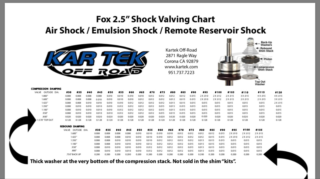

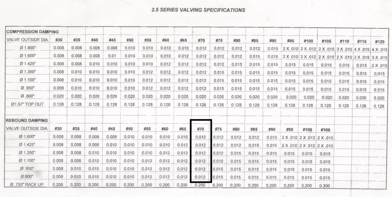

    Fox uses a valving chart that you can Google to find and have for reference. They have a little more valving options from the factory than King. A 2,1/70 is a a double .015 for the bottom shim and a .015 stack thereafter. Rebound is .012” shims throughout.
    King uses different terminology but the idea is the same. I think a 15/8 is a .015” stack for compression and an .008” stack on rebound. In Fox terms, that’s a 90/30. Someone more familiar with Kings could conform?
