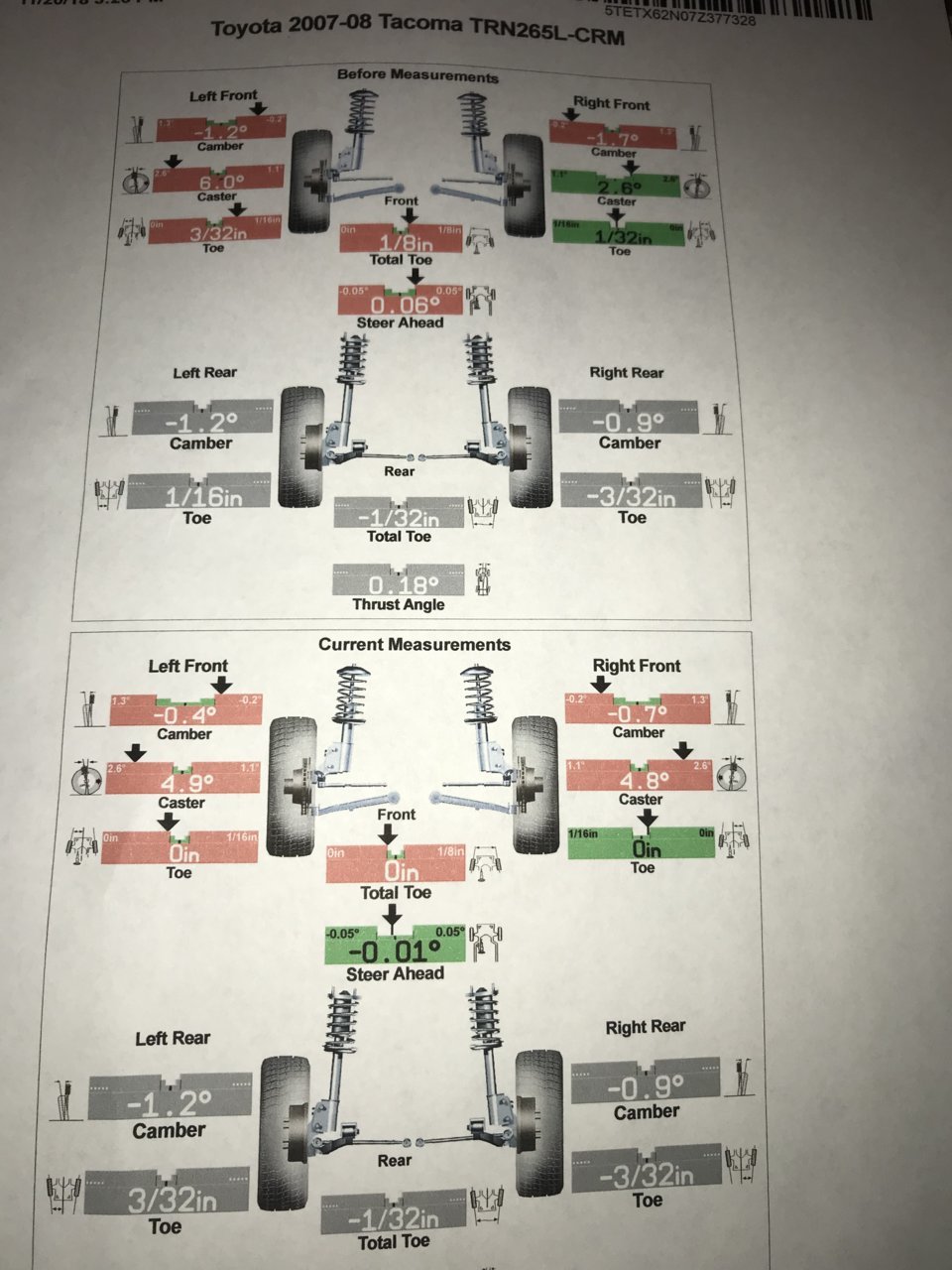

    What do y’all think about these alignment numbers. Specifically the bottom ones I’m surprised I was able to actually get the toe within 1/8” before with a tape measure.

    Yes
    Your toe is wrong, on any rear wheel drive vehicle you should have around an 1/8” of toe because the front wheels spread as the truck moves forward. With zero toe it will cause bad wear toward the outside edges of the tires.

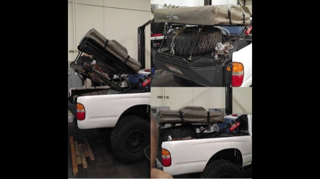

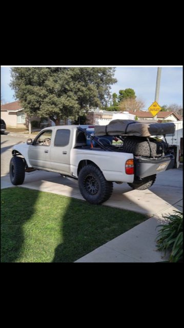

    Soooooo....anyone know anyone who has a linked truck with a RTT on the back....kinda toying with the idea to make a removable rack to attach to the trunk lid to maintain access to the rear storage. Smaller tent only weighs like 95lbs soo all said and done adds like 130lbs overall on the back....just curious if anyone has done it

    @sytfu510 just got his truck linked and has one.

    There's a guy with a pre taco that beats o. His rig hard with one. I'd do it. Make some removable cross bars bed rail height that ties to the bed cage. Be perfect

    Yea that's kinda what I'm plannin if I build what I got in my head I think it'll turn out alright, only gunna have it on for camping trips not all the time, but stout enough to bash some whoops like dezert and pismo shit

    I know ttmotorsports did his truck with one

    I'd just suggest keeping it as low as possible. It makes a huge difference in handling.

    Yea itll basically sit on my spare and I'll have it to where u can pivot just the tent up to get the spare out if u had to

    Tommy from TT motorsports
    And sytfu
    But
    His truck isn’t caged so there is no tower coming off the back of the cab like most linked trucks

    his truck is caged

    He has a bed still tho
