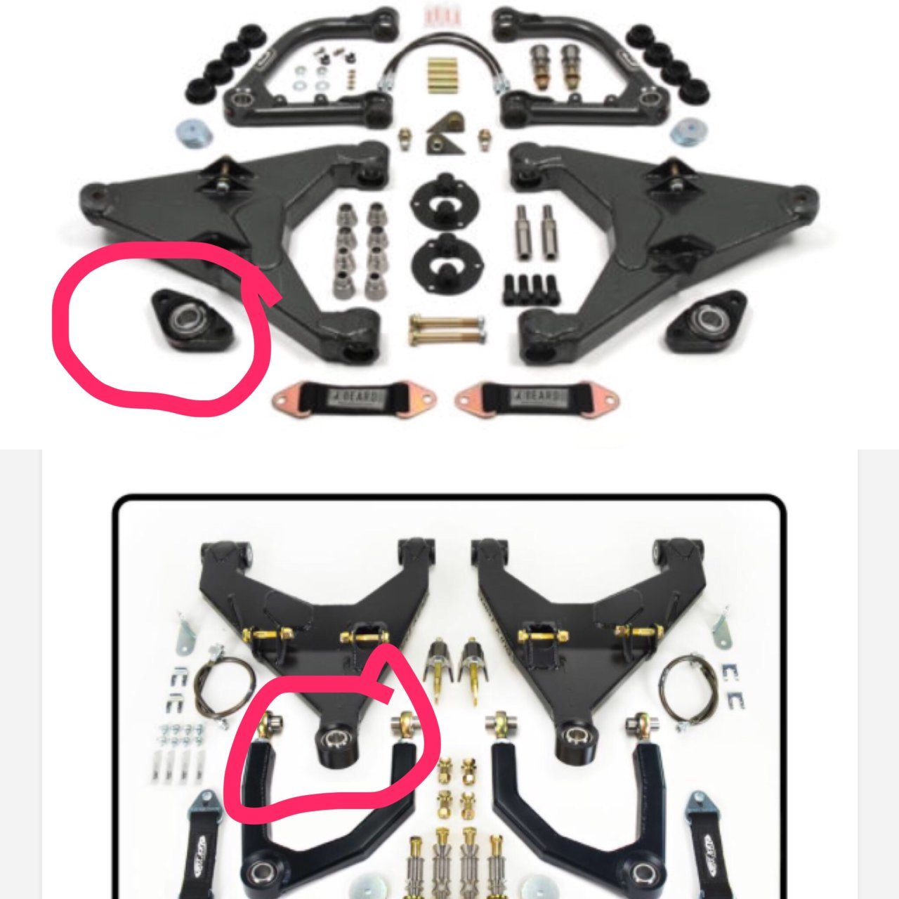

    Camburg top vs dirt king bottom. Camburg uses an adapter vs having the uniball incorporated into the lower control arm. More parts/ bolts to fail or come loose and lowers the ground clearance. 8D00D30A-5FD2-4423-9B82-412271E95893.jpg

    Are they the same price? What would be a positive that camburg has that dirt doesnt"

    Dirt king is $200 cheaper for both the bushing and heim options and has the better ground clearance. Dirt king is comproble to the total chaos race kit and cheaper. But I'm biased since I run the dirt king kit and am extremely happy

    Most the kits offer the same thing, but definitely go for the integrated lower uniballs though.

    The one thing camburg has is the uniball lower bushings. That’s the one thing they do that I
    like. That’s something some guy won’t like as it could lead to more maintenance or squeaks. With that said, that’s not enough for me to buy camburg over the others. I will say that I would take the camburg kit over the solo +3.5 kit and the tc standard 3.5 kit.

    One thing Camburg DOES do that literally no one else does(sadly) is running Heims in the LCA mounts. This helps with your alignment alot as it won't get smacked out nearly as easy and there is no bushing bind or wallowed out bushing ever as there aren't any.
    I say this, and don't own one thing from Camburg btw.

    Sounds great until all 4 uniballs are seized and so are all 8 mis-alignments. Lol
