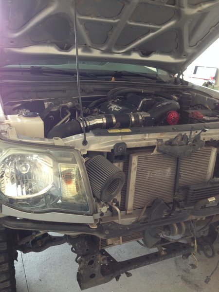

    since you guys remove inner fender liners so often is there a way to remove this close off the airbox hole in the fender, but not use a snorkel or CAI?
    i would mainly just like clean ideas for the air coming from a safe spot elsewhere in the engine bay.

    I modified a urd tcai for mine. Had to modify due to the intercooler for the sc causing the filter to rub otherwise the standard placement is fine.

    We got my Dads TCAI to work with the TRD blower, had to order a custom filter.

    That would've been another option. I went with the $10 elbow from vatozone and did this. Keeps it slightly more hidden, but the filter shield doesn't do anything anymore. Every once in a while if I'm driving during a monsoon, the truck will act up from water hitting the MAF.

    People have set it up to intake air from inside the cab, or from the cabin air intake.
    Depends how much water you expect to hit.
