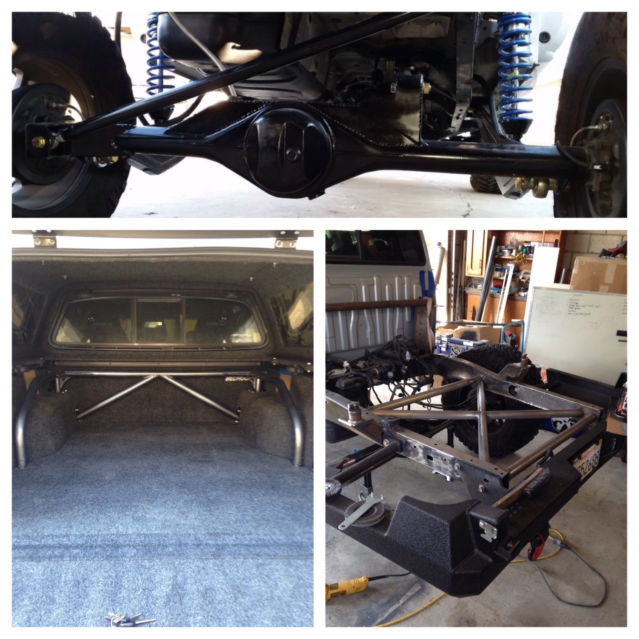

    More pics of this please!!!!! Would love to see more on this build.

    Build is in his sig. Some nice work for sure!

    Damn, that linked rear end really got me thinking....
    Are 3/4 links better for everything, or just higher speed? I don't really do anything so crazy fast but I really like the idea of C/Os in the back instead of leaf springs. I also don't love the lower links below the axle for clearance stuff.
    Talk me in/out of this potentially poor decision.

    It's expensive as hell.
    It's all custom work
    If you're not going to use it wtf is the point

    Fair enough on all accounts. Is it really only dramatically better than leafs at high speed hooning?

    Not really. Be a better drive all around sort of. Lots more travel in the rocks.

    Interesting, that part is appealing to me. I will continue researching then. I am sure it will be way more than I would need but it would be a fun project for myself and the shop.

    why don't people link similarly for crawling?
    they use huge arms for LT and Tubing for rock crawling.
    why differentiate?

    Likely for clearance. Would rather slide a tube over a rock, where as an arm might catch and get hung up.

    i'm sure it's for clearance.
    my question is why not use tubing for LT applications?

    Ah gotcha, I read the question in reverse. My assumption would be more strength and rigidity, but that's just a guess.

    Because with the bigger trailing arms such as on a trophy truck, you can move the lower shock mount forward to gain more travel, vs having the shock mounted straight to the axle. This also allows you to run a bypass shock as well.

    Interesting, seems like a weird way to set up the axle/bump. I figure you would get some 'axle wrap' style movement with acceleration (positive or negative).
    Potentially, if I design my own trailing arms I can kind of split the difference and get decent clearance as well as travel. Does anyone have any good resources on required geometry/things to avoid with 4 link?
