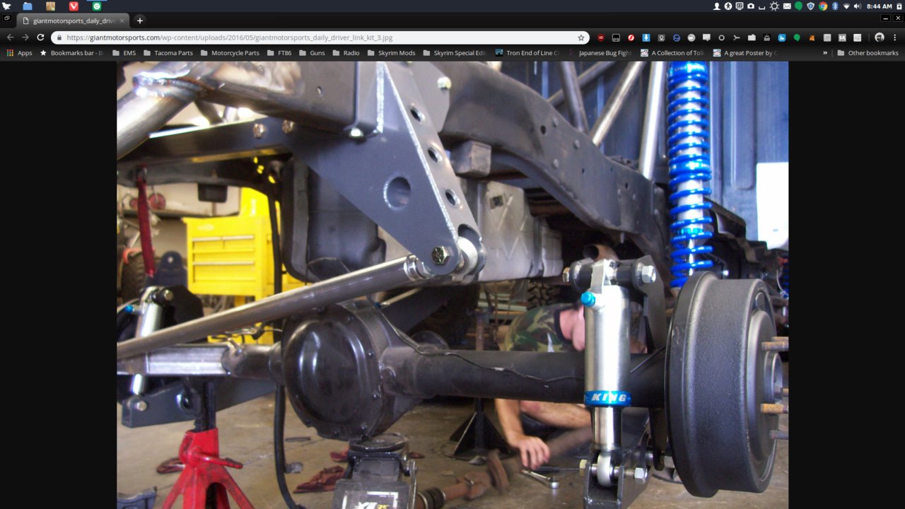

    They use that air shock in place of an upper link bar to control pinion angle. . Running an upper link is a far better than the air shock setup. Lots of guys have had issues with the air shocks and switched to an upper link

    Gotcha, I was wondering where the upper links were -- I wasn't sure if it was an in-progress picture or what. Optimally I would do a standard 4 link, not that weird air system. That seems strange -- any idea what the advantage would be?

    Not lighter. Lots of companies like solo use a peice of dom running the full length of the bottom of the links.

    You don’t need to mount an upper link. In theory makes for an easier install, until you start blowing up driveshafts

    couldn't they just use one piece of DOM tubing with mounts for the coilover and bypass, is it required to be boxed you think?

    Tubing is general for a rock crawler as they have their shocks/coilovers setup much differently. Typically mounted directly to the axle.
    Long travel will mount to the lower arms thus giving you a different lever ratio and allows you better tuning for faster shaft speeds. Because of this a LOT of force is put on the arm so it needs to be well..a big ass arm to stop the steel deflection which in turn means the shock is doing the work and there is less variables for tuning.
    A full 4 link is better but you have to consider your fuel cell as the stock tank will not work with a 4 link so you have to do a cell.

    3 link is your only option then. Which works well too. Just has axle swing due to the setup which can be minimized to a point.

    They could, but they would still need to bent to mount the c/o’s and bypasses below the centerline of the pivots. They would also be pretty weak. When you put a coilover and/or bypass in the middle of the link you are adding a lot more force onto the links than if they are just locating your axle.

    Well shock mount location for starters...crawlers dont usually put the shock on the link and dont cycle the same amount of travel.
    The reason trailing arms are soo beefy is the leverage of the shocks is in the middle of an arm and the jarring forces of hitting things at high speed puts alot of stress on the links, whereas a crawler is just flopping around thru some slow rocks the stress isn't the same
